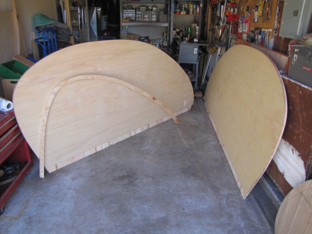

I also laminated the inside panels on my sides. I am all ready to cut out the door holes and then the sides will be ready to mount! I am still able to get things done but am really starting to need the trailer. already about $700 in so no turning back now!
