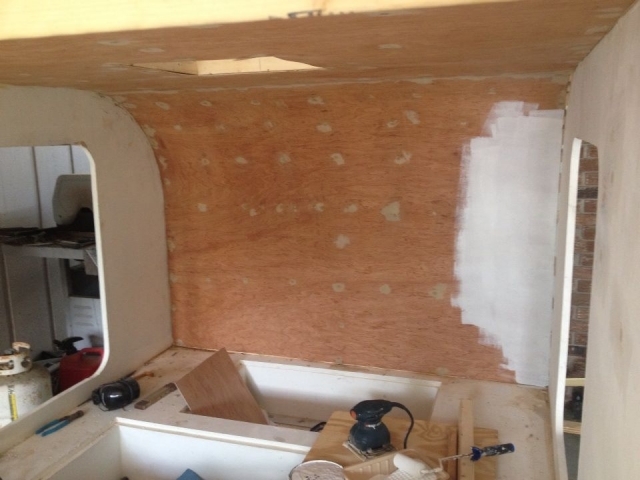

Thanks!!!. I think as it progresses I should have made the front radius 24" instead of 18" It's almost too tight to bend some wood around. I now have the inside front wall/ceiling installed, and the screw holes filled. I cut the hole for the fan and have applied the "Magic Mix" (3:1 mixture of Mineral Spirits to polyurethane) to both sides of the ceiling. Pictures coming soon.

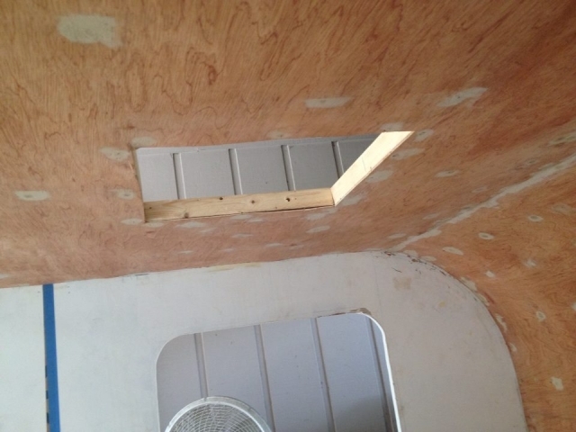

Postby Tommy2tone_1999 » Wed May 14, 2014 10:15 am

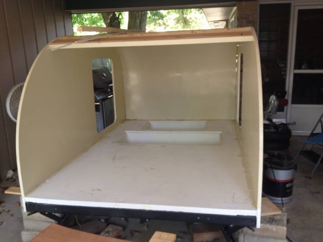

Installing the Front wall and ceiling.
Cutting the hole for the fan.
Small nails from the nail gun weren't cutting it, went with screws, then wood filler for the screw heads.

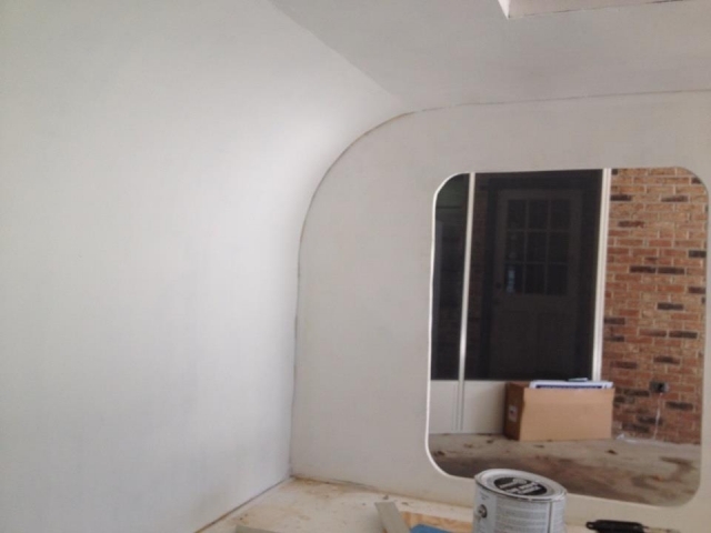

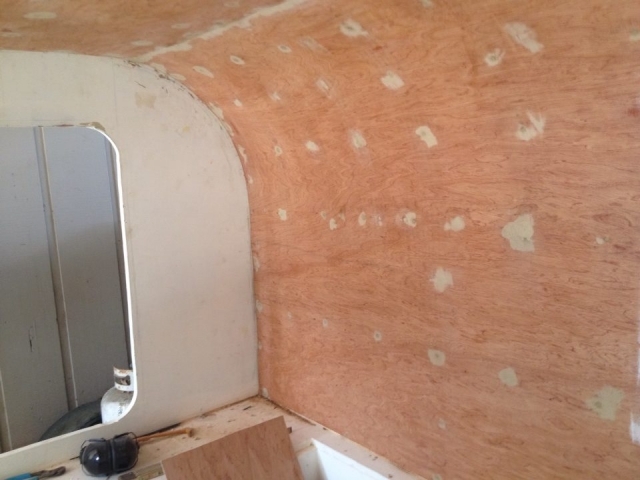

Applied "Magic Mix" to both faces of the Luan for the ceiling, then 2 coats of Zinsser oil-based Primer to the inside surface.
All Primed, ready to paint.

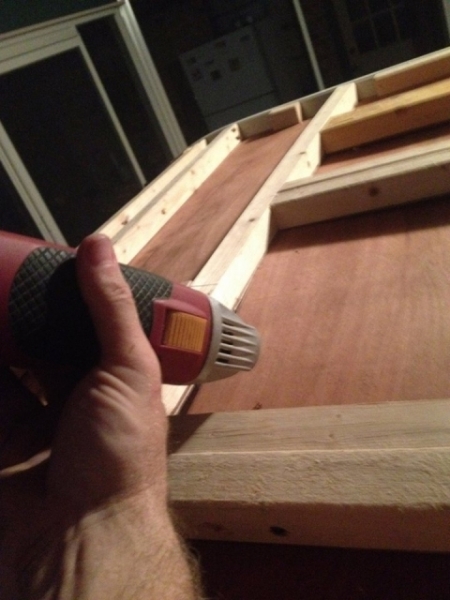

CRAP!!! Slipped up with the electric planer while trying to trim the spars level with the profile.
It's not so bad, nothing I can fill in then cover with fiberglass.

Postby KCStudly » Wed May 14, 2014 10:27 am
Sometimes I shy away from power tools for this very reason; it is way too easy to go too far too fast. With a hand plane that would not have happened. It takes a little longer sometimes, but it is therapeutic, too, so that's works for my build style. That, and you can use the wood curly-ques as tender for starting your camp fires. :D
Like you said, not a big problem to fix and you are getting it done! So more power to ya'! :thumbsup:

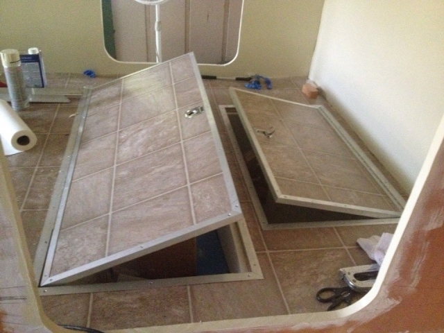

Postby Tommy2tone_1999 » Mon May 26, 2014 3:12 pm

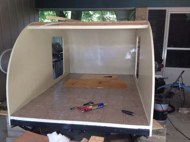

Painted the walls
Put down the Vinyl Floor. I used liquid nails underneath and a hard roller to flatten the vinyl out.
Put the hatch lids in place and cut the vinyl around them

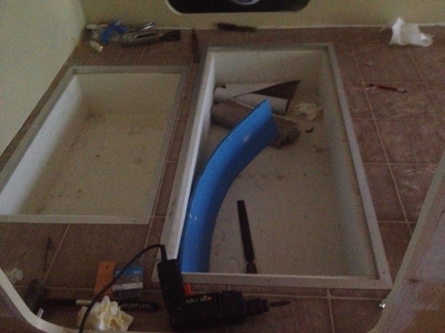

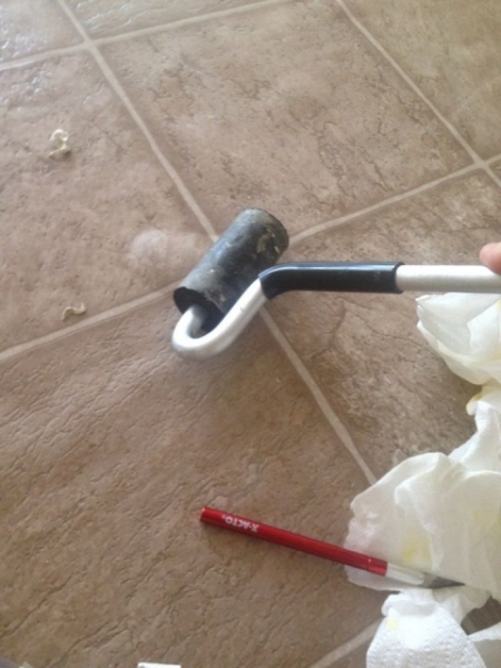

Postby Tommy2tone_1999 » Tue Jun 03, 2014 10:33 pm

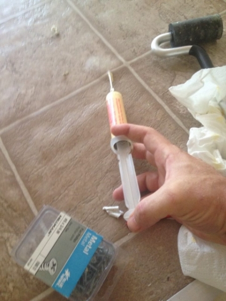

Had some areas in the vinyl flooring that the glue didn't spread to which cause this blistering effect
The solution: Cajun Injector to the resue. Filled that puppy full of Tite-Bond II wood glue.
Injecting the wood glue under the vinyl flooring
After I injected the glue I rolled the blisters flat. I was able to take care of most this way, but still some would not lay flat.

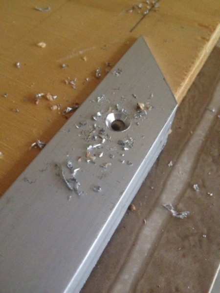

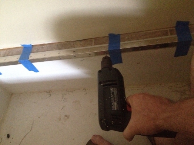

Drilling screw holes in the aluminium angle I'm using the trim the floor boxes
After I drilled the holes I drilled counter sinks
Floor boxes all trimmed out with aluminum angle
Last edited by Tommy2tone_1999 on Mon Apr 06, 2015 4:03 pm, edited 2 times in total.

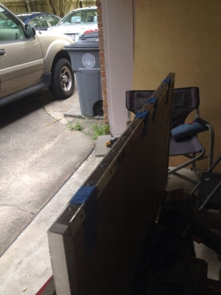

Postby Tommy2tone_1999 » Thu Jun 05, 2014 8:56 pm
Finishing up with the lids for the Floor Storage Boxes. Had to chisel out holes for the handles, then mount the piano hinges and then mount the doors to the floor.
Last edited by Tommy2tone_1999 on Mon Apr 06, 2015 4:06 pm, edited 2 times in total.

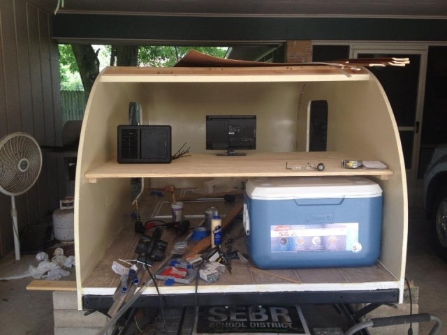

Postby Tommy2tone_1999 » Mon Jun 09, 2014 12:37 pm

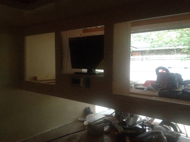

Counter installed (unfinished), and work starts on interior cabinet facing.
Last edited by Tommy2tone_1999 on Mon Apr 06, 2015 4:07 pm, edited 2 times in total.

Re: Mobile Fit Club Build - Tommy2tone_1999
Postby KCStudly » Mon Jun 09, 2014 4:29 pm
Looking good. :thumbsup:
Might I advise that you keep your electronics away from the sawdust as much as possible? I realize that some fitting is required, but I bet the circuit boards won't take kindly to the full onslaught of the construction environment. Kind of looks like you are working around them. :roll:
Postby Tommy2tone_1999 » Mon Jun 09, 2014 11:21 pm
Thanks for the tip. Most of the cutting is done outside the teardrop and taken in to get fitted, but sanding will start soon so I'll be sure to keep that in mind.

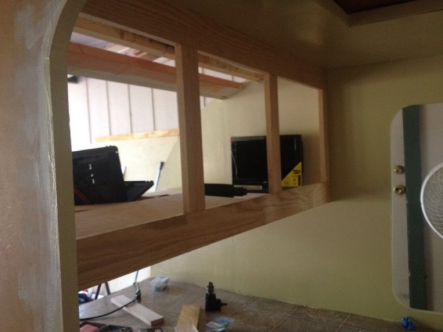

Postby Tommy2tone_1999 » Mon Jun 09, 2014 11:24 pm
Facing completed except for the piece where the TV, electrical outlets will fit in the center opening.
