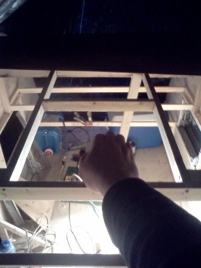

I got the roof hatch opening framed and I let in the header over the other door (had to cover the light with my hand)

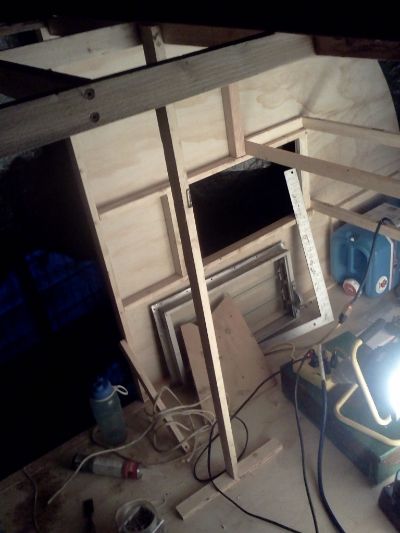

In the back you can see (from L to R) the water can, stove (the work light is sitting on it) and cooler I'm using for layout. The cooler is where it will sit on drawer slides and the water container will be above it on the upper shelf. For transit, it'll be further back from where you see it though on that side in order to help balance the weight of the cooler (batteries are on cooler side as well, although on tongue). There will also be a jerry can of water in front of where it sits if there's room when it's all together, otherwise it'll be beside it.

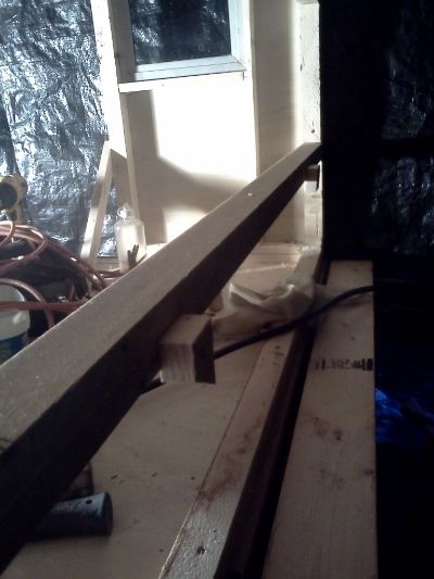

I added a couple of temporary cleats to the doubled spar to hold the 4' skin while I start pinning it into place. I don't relish the thought of trying to hold it in place, line it up, and nail it all while the glue is wet. Talk about inviting ol' Murphy to the party !
When I started this, I took a chunk of 1/4" nylon cord and marked 48" from the end. That way, I can follow the curve on the outside of the wall skin to find where the edges of the sheets land, just like using a piece of thread to measure distance on a map...
I used that and screwed/glued the blocking for the seam between the first and second sheets:

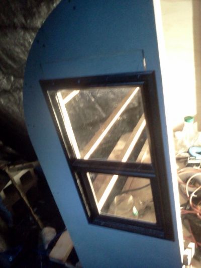

I also got the front window (on the left side) dropped down to the level of the jalousie windows further back - it HAD to be fixed...
I measured the height of the back window from the bottom of the opening to the floor and laid that out as the new sill height, where I glued and screwed a new sill in. I then cut out the glassed 1/4" plywood skin down to the new sill. I used the piece I cut out as a patch to fill the newly created hole at the top and Bob's yer uncle. There's a bit of a gap still from the kerf of the jigsaw, but that's a glass repair that I'll do while I'm glassing the roof.

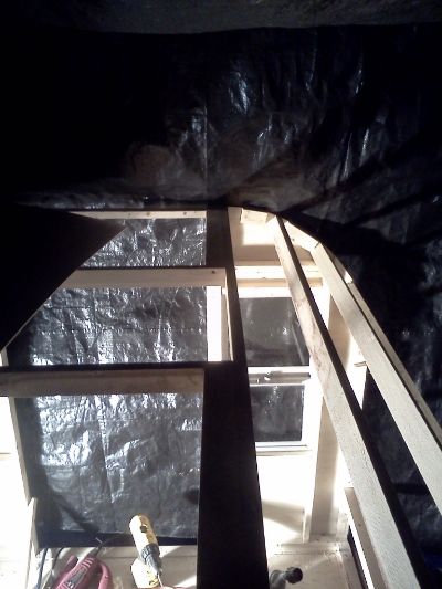

I also made up a temporary shore to support the roof framing until the roof is on and glassed. I won't be crawling around up there, but I'm not crazy about even leaning on individual 1X2's while gluing or later glassing until everything is locked in as a single unit so this ought to help carry that post-Xmas 'structural loading'

Have you checked your actual roof vent against your framing? I know you said you don't want to add anymore wood to your roof, but what I found, despite using the usual 14+ inch RO (rough opening), was that the preformed holes in my MaxxAir vent would have split the edge of a single 1x, so I doubled them.
Also, I suggest that you use an off cut strip of your roof ply material, just a 1/4 to 1/2 inch wide strip, as your story pole. It will bend very easily compared to a wider piece, will hold a straight line better, can be marked more accurately, and will not stretch like cord can. It worked very well for me.

Hmmm...funny you mention that, KC. I was thinking "I should grab the frame and drop it in, just to be sure"...but what's the worst that could happen ?
I'll be doing that first thing tomorrow after the glue has had time to set up.
Unless I get out there tonight... :lol:
I can definitely see how the screw could land right on the outer edge of 3/4" stock. I allowed a smidge extra on the opening to allow me to square it up if need be so hopefully that's enough to get the screws a bit closer to center as well.
