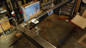

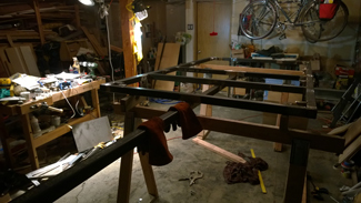

I spent most of the day adding tabs to the frame for attaching the floor. I got the idea from Mike Mikkelson's build journal. Seems like it would be an easy way to bolt to the floor without the wall coming in the way. Maybe even make the cabin more easily removable?
the tabs for mounting the floor boards
I got those attached just as Chris came over to finish up the work from yesterday. Short of grinding out some weld splatter, we have the frame finished. Just need to add the tongue and A beams. Waiting on the A beams until i get the wheel jack that I ordered last week. Going to order a flexride axle this week too. Once I have everything in place, I'll prime and paint and get started on the wood work. I'll post better frame pics when there is more light.

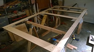

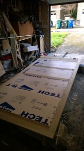

I spent the first part of Sunday cleaning up the welds and the second putting together the floor. I finished up Kreg Screwing and Titebond III gluing the 3/4 inch poplar. That went pretty quickly. I had to put everything back in storage position so I could get the car into the garage for the week.
The teardrop floor
NA US WA Seattle - Teardrop Floor IMG001.jpg (51.25 KiB) Viewed 2348 times

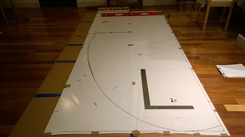

So more framework is on hold. In the meantime, I started working on the profile. The grid patterns on the back of the wrapping paper actually did help with lining things up. Its not the same as drawing it out on Plywood. I must say that even with a 10ft length it seems like a short mattress. Luckily I have started shrinking and am no longer 6 ft. Maybe if the build takes long enough, I can use the 8 ft profiler. I also bought some parts that will be good to have before I get too far into the build so that I can make sure I don't go down a road that wont support the Fan-tastic Vent and PD4045 Power Center.

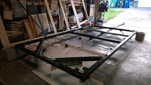

Its been a while and more than time for an update but I have been busy....

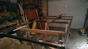

The trailer frame is welded together except for the wheels. I am going to wait on the until I get a feel for the center of gravity. As it is now I can still lean the frame against the wall when I am not working on it.
The Frame with everything but the wheels and lights and fender.
wNA US WA Seattle - TD Frame Build IMG009.jpg (53.05 KiB) Viewed 2188 times

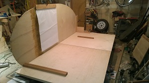

Re: The No Tears Teardrop Build
Postby Diemjoe » Mon Feb 09, 2015 12:40 am
As I mentioned above, I cut both walls and they are ready for me to decide door placement (that's the piece of paper). Once I do that, I'll cut the Skeleton.
The first look
wNA US WA Seattle - TD Cabin Wall 1.jpg (47.87 KiB) Viewed 2199 times
The 2x2 indicate my minimum length laying down. Just a rough placement.

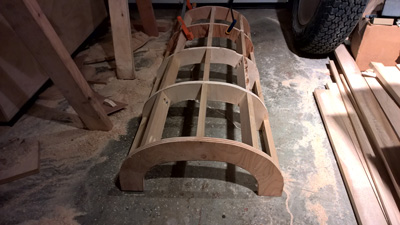

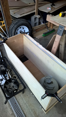

I still haven't attached the axles since I want to get the positioning to allow for about 80 to 100 pounds of tongue weight. I figured that would just get as much lumber cut up as I can and lay it on the trailer frame in its approximate location. Then I'll use a pivot point that will simulate the axle and move it around to get the center of weight. I know, sounds like a real pain for a few pounds here and there.
Even though I can't build the trailer, I can build the tongue box. Which will give me some experience in working with curved spars and bending wood. I am glad I did. I have learned a lot and I haven even bent any plywood yet.
laying out the main contents of the tongue box
Here is the box with the camp chef that I a decided is going in too.
The box top waiting for the bent plywood
Don Miller
