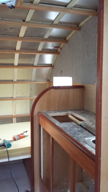

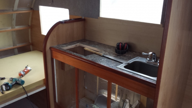

The exterior of the trailer is finished with the exception of the windows and the entry door,, Now Im installing some of the interior parts that I fabricated in Feb and March . Everything is fitting together fairly well with only a few glitches that were easily worked around. Once he interior structure is complete I will be able to start on the electrical and mechanical systems.

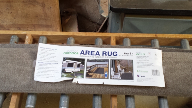

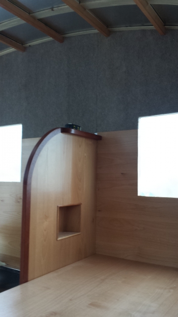

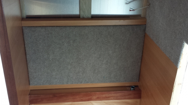

Here are some photos of the foam board ceiling panels which are being wrapped in a ribbed indoor outdoor carpet I found at Home Depot. This carpet is made from recycled water bottles and is very light and strong. The panels are fitted between the spars and held in place with velcro strips....Image ImageImage

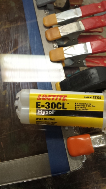

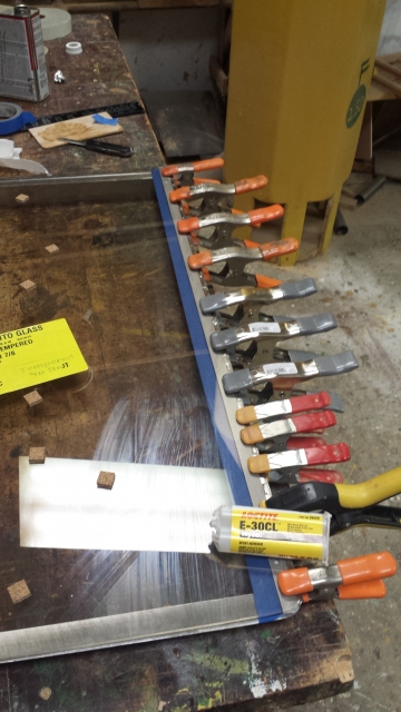

I got my glass panels today as well From Kotto Auto glass in California .. Their price was much less than any other quote I received and at first I was hesitant to go with such a low quote. In the end they did a great job and I received exactly what I ordered . Here I am epoxying the glass to the aluminum hinge on one of my custom window frames . The glass will also be bolted to the glass with an experimental bolt design. Image Image

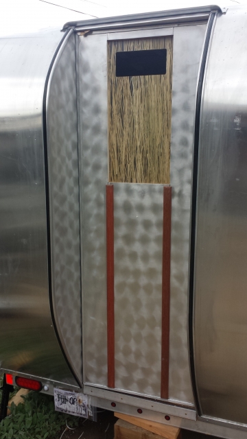

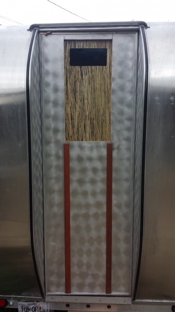

Finally I have the door installed , Im still unsure about the resin window panel with sea grass and may go with a clear window. I did figure out my finish for the Aluminum skin. Since the mill finish shows every scratch and blemish , I needed a finish that would hide scratches and still look interesting. Polishing to a high gloss ala Airstream is incredibly time consuming and requires constant upkeep. I settled on a swirl finish that if scratched could be spot sanded and reswirled. To get this finish I begin by cleaning any grime or glue/calk stains with acetone and then sand the surface with a random orbit sander and 180 grit Alum oxide sanding discs. Once the surface is free of scratches and sanded to an even dull sheen I go over the surface with a 4 1/2 inch diameter velcro scotch brite disc on a variable speed drill. I try to put the swirls on before The trim goes on and overlap each swirl by 1/3 .Image Image
