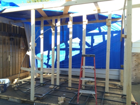

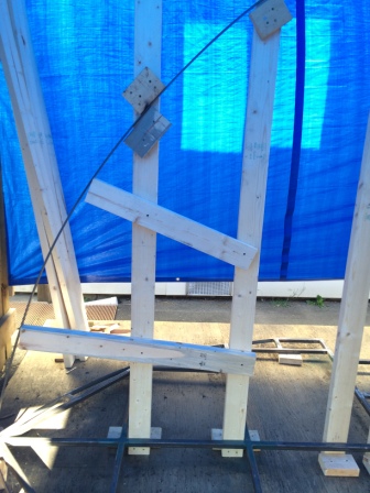

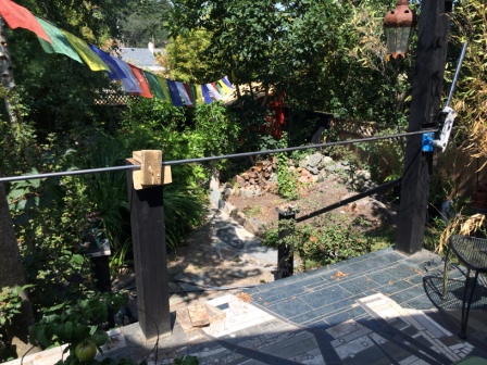

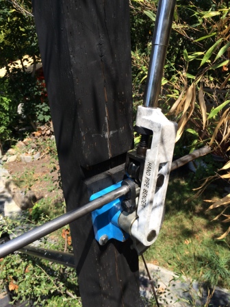

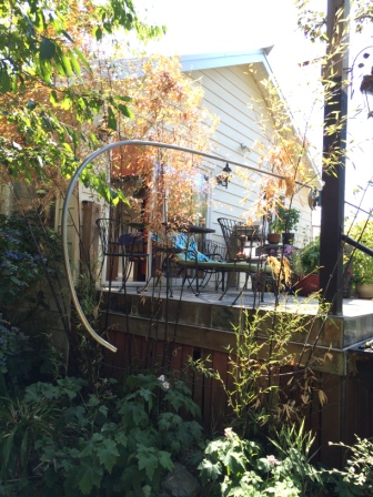

setting up the bender today---this setup worked well-----gravity (sort of) helped a bit here, but not as well as having a huge flat space to bend. i did end up with some scholiosis, but it will be over-come with rigorous pre weld bracing. the twisting occurred when i tried turning the whole thing around to start from the other end......the floor got in the way so i pushed it a bit to the side off the edge of the deck. live and not learn, as they say.....

having the bender here enabled me to walk away for a bit to contemplate curves, but i zoned out early on and bent it a bit tight ! oh well. gotta buy an unbender now.....

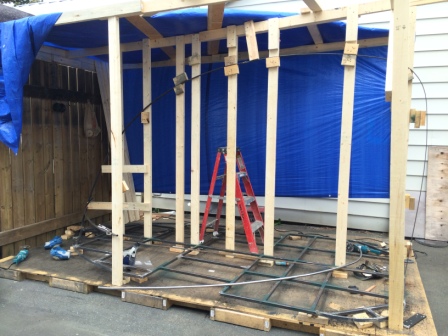

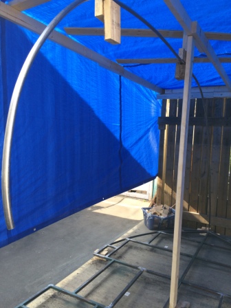

today's update---- built the wood spine i mentioned a couple of posts ago. also--after mucking around with the 3/4" tubing, i decided that the results will be more satisfactory if i stick to the flat bar for the spine. graceful curves can be achieved quite easily, and are fast-n-easy to dial in with simple techniques. i would rather spend the time improving my welding skills than trying to achieve a perfect curve with the tubing.
for spinal rigidity, i can make the flat into T-bar by welding short segments of the same flat bar under the curve.
dry dock 2.JPG (84.76 KiB) Viewed 2176 times
dry dock 1.JPG (81.15 KiB) Viewed 2176 times
in the above shot, you can see that the curvature is a bit off. i want to have a long graceful curve from beginning to end---not the flat section over the door. with the flat bar, it's just a matter of moving some 2x4 blocks until it looks good. no fussing with the bender !!

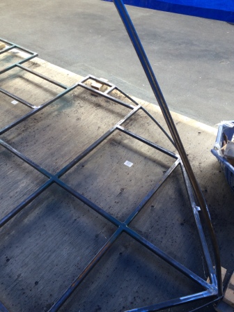

spinal radius 1.JPG (77 KiB) Viewed 2176 times
the radius here should be the same as the floor curvature.....
unscrewing the rear screw in those horizontal 2x4's means i can adjust the curve pretty easily with just a nudge up or down--- no kinks or flat spots.

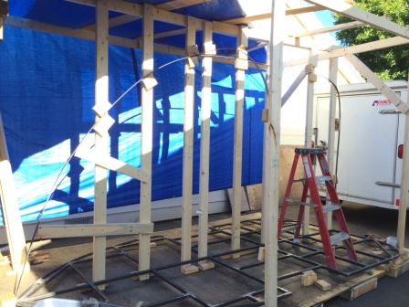

Postby dave campbell » Wed Aug 05, 2015 6:49 pm
not much to report today. went to the metal shop for more 1 x 3/16....would you believe sold out ? to keep things moving and to add more weight because i do know that weight is crucial ;) i purchased 40 feet of 1 1/4 x 3/16 with a 20 % discount !!
got the curvature nearly to my satisfaction, with a nice forward lean. plenty of head room and no straight sections. welded two 10 foot lengths of bar together, plus an additional 8 1/2 inches to get me end to end. next phase i reckon is 7 or 8 sheets of 1/2" plywood temporarily installed port to starboard at each rib junction, to nail down my rib cage profiles......thanks everyone for your suggestions and interest ! :beer:

captain's log---stardate 080615-----no true progress made on project 'why' today, but i did do some re-jiggery on the dry dock. that was simply a matter of detaching the vertical 2x4's from the floor. and shoving the whole shebang off to the right a ways to straighten the base out on its stage, as it was rather askew---and finally got to doing my best at making sure said base is level and secure. due to my primitive methods and lackadaisical approach, it IS a wee bit cock-eyed----as in not perfectly flat though pretty damn close----but nothing that can't be overcome or masked later. don't quote me on this, but it won't be a case of snowballing problems.....
also picked up 7 sheets of 5/8 ply to build the sacrificial bulkhead that was suggested by nose oil the other day..... on to that tomorrow ! :beer:
