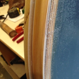

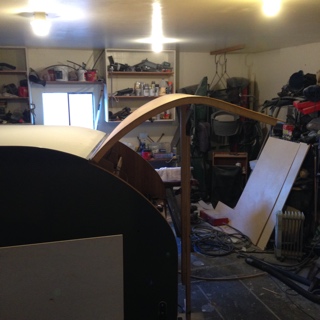

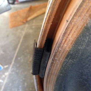

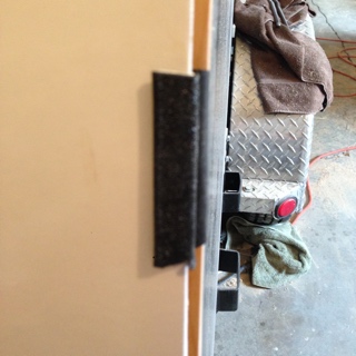

For the past year I have read and researched this site.
If people had problems with their hatches, it is because they "opened" up upon sheathing.
Mine has contracted.......
Built using templates, in place. Inner and outer skin on and the radious became tighter.....
Have it in place now with winch straps on it pulling tight to see if it "relaxes"
If not, then plan B....

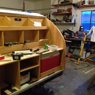

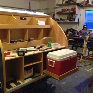

Postby fourbtgait » Tue Feb 23, 2016 9:55 pm
Little things.
1st coat exterior of hatch.
Sliding drawer for ice chest.

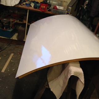

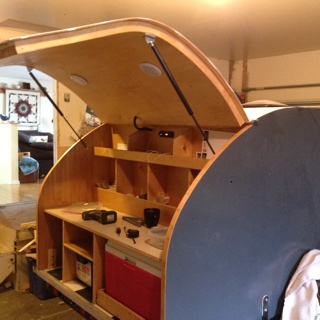

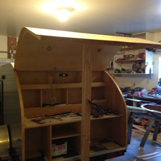

Postby fourbtgait » Sat Feb 27, 2016 4:20 pm
Hatch installed, wired, gas springs on.
The gas spring calculator did not work for me. It said 42 pounds works, bought 50 pounds, wouldnt hold hatch.
100 pound springs work perfect.
Triple, quadruple checked numbers.

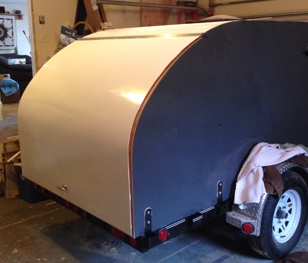

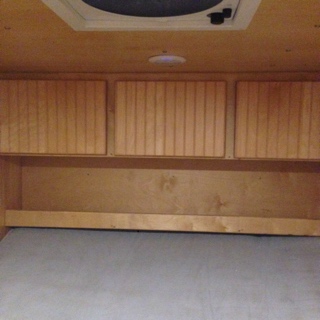

Postby fourbtgait » Sun Mar 20, 2016 9:42 pm
Two weeks busy doing other things.
Sanded, repainted the outside grey today. Thought it might be to light and once hitched to the 4runner, it was. Only takes 30 minutes to unbolt, lift off of trailer.
Lot of little things to finish, door knobs, coat/towel hooks, drip caps, etc.
The bare trailer had a tongue weight of 275 pounds. Bare box on the trailer with matress inside, 60 pound battery in tongue box has a tongue weight of 224 pounds. As set up now, trailer weighs 1450, so 15%. Not bad.
Once set back down, I will load up all gear that will stay in trailer, recheck. I will use the 7 gallon water jug and the ice chest as movable ballast. Need more tongue weight? Put those in front of box when traveling.
Interior cabinets, just need add knobs.

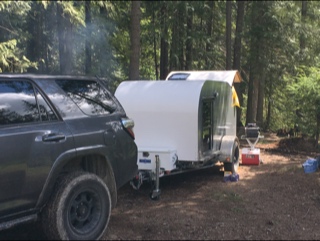

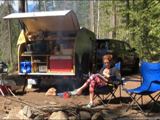

Postby fourbtgait » Sun Jul 24, 2016 5:21 pm
Finally took it out camping once life settled down. Major storm blew through as we headed to the mountains, no issues of leaks. Pulled behind the 4runner like a dream, followed in our tire tracks. We got 16 mpg at 60 mph max on rolling hills 2 lanes. Going tent camping, same road/vehicle gave us 21 mpg. So lost 5 mpg, not bad but hoped for less. Very short list of upgrades, simple things like magnetic pistol holders and such.
