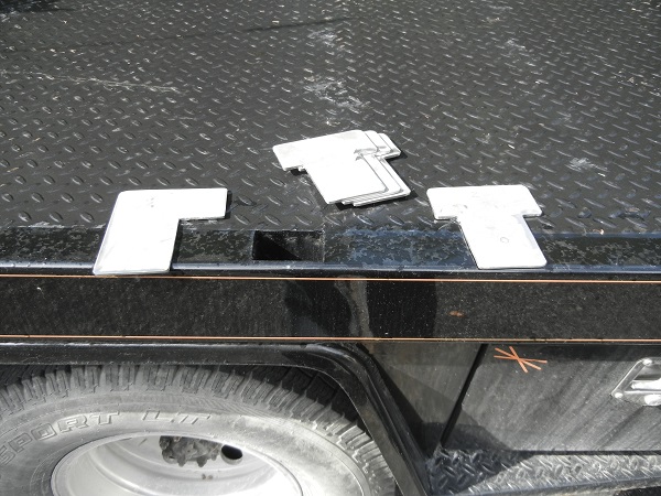

Postby Philip » Wed Sep 28, 2016 7:04 pm
Today I started working on the mounting system for the camper. The plates are 10 gage flat steel. They will have a 3/8" bolt holding them into the stake pockets . I'll use long wood screws to attach to the camper. Total of 6 mounts being used. Two fronts, two in the rear side, two in the rear.

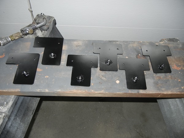

Postby Philip » Wed Oct 19, 2016 6:19 pm
Been down for the last week with a minor med issue. Got that taken care of.

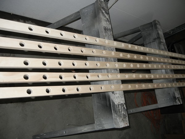

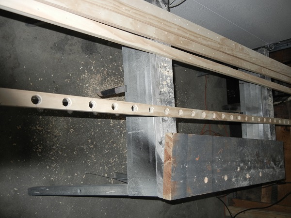

Today I went after the brackets agin. I welded on the hold down nuts. Then filed off the sharp edges. Threw them in the blast cabinet. Then threw some rattle can at them.
Then I started on a weight reduction plan for the floor joists. The joists are 3/4"x 1.5". The holes are 7/8" spaced on 3" centers.
I'll try and get the other 4 done tomorrow.

Postby Philip » Thu Oct 20, 2016 4:09 pm
I finished the rest of the floor joists off today.

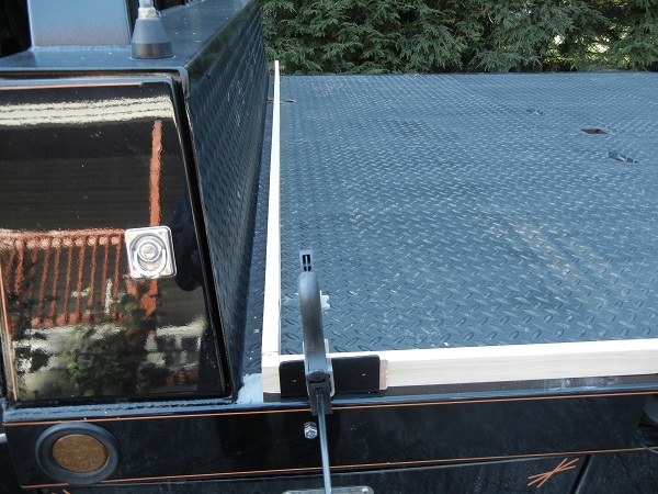

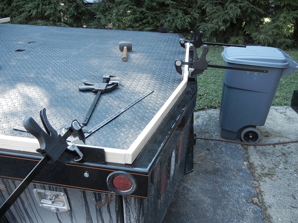

Postby Philip » Sat Oct 22, 2016 6:19 pm
Today I worked on fitting the mounting brackets into the stake pockets. A couple of brackets needed some fine tuning. One bracket I need to remove the mounting nut I welded on. I made two left side front brackets. OOOPPPPPSSSS :lol:
Then I started on fitting the outside frame boards into place and working out the rear angles.

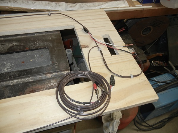

Postby Philip » Thu Oct 27, 2016 6:39 pm
Still have the old project in the garage and the weather hasn't been good for outside work.
Today I finished off the hot wire cutter wiring.
