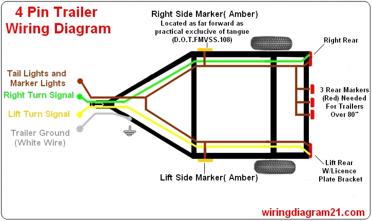

Also, if someone could answer the following for me, I didn't pay enough attention when removing the brake wiring. What color wires go to which side of the tail lights? Yellow/Brown wire is left brake light? Green/Brown wire is right brake light? Anyone? Anyone? Beuller? :thinking:

Postby greygoos » Mon Apr 30, 2018 7:14 am
Try this
4 pin trailer plug light wiring diagram color code.jpg (151.07 KiB) Viewed 3307 times
