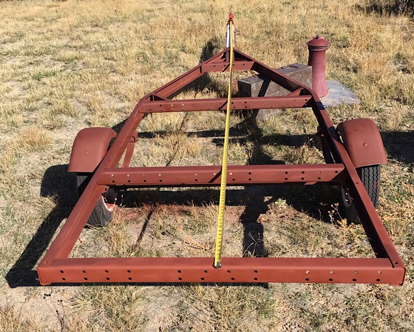

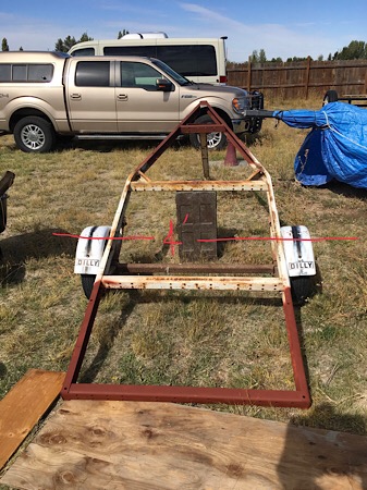

I worked on the frame some today. Started cleaning and priming, but the wind decided to blow toward 6 plus figures of parked vehicles and I figured Momma wouldn’t like primer spots on her rigs... so I quit for the day. I did figure out how to use the antique door however... I think.
The red ‘4’ line is four feet from where I think the back edge of the floor will be. I’ll bolt a 6’ wide, 2x6 on the back frame member and use that as the rear floor support.
Ken

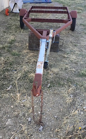

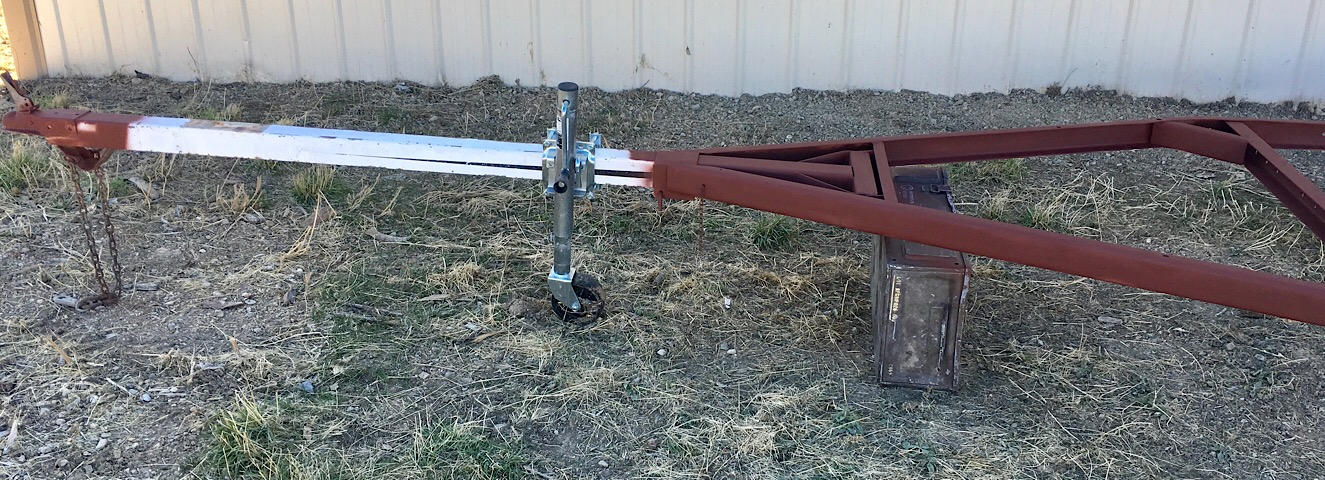

I moved the trailer today, using my tractor. It was sitting in my ‘snow storage area’ and would probably be buried by spring. So, while it was being moved, and up in the air on the tractor forks, I painted the rest of the underparts. Then I stole the jack from my generator trailer and put it on the LONG tongue of this trailer. Now, I can easily block up the frame, remove the tongue and shorten it. At least something got done.
Ken

Postby pchast » Sat Oct 12, 2019 8:41 pm
Ken,
I would not shorten that tongue until I was done with the
build. And after I'd installed the tongue(junk)box....

Postby ricky herbold » Sat Oct 12, 2019 8:50 pm
pchast wrote:Ken,
I agree ⬆️

Postby NevadaBlue » Sat Oct 12, 2019 8:57 pm
Thanks guys, probably a good idea. I don’t have a welder outlet yet, so that will work out for the best. I hope to start building the floor tomorrow and start spraying the black frame finish. We will see.

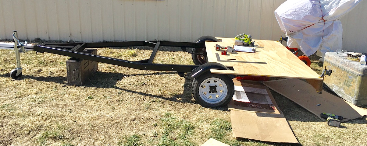

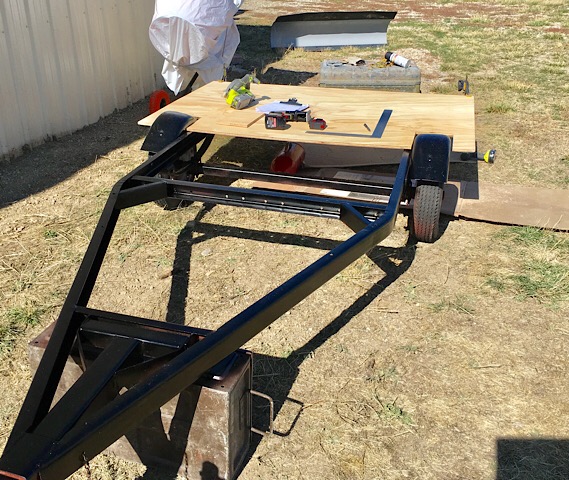

Postby NevadaBlue » Sun Oct 13, 2019 2:29 pm
I can’t do much at a time, but I can’t just sit all the time either. So, it is such a beautiful day, I went out and painted the frame black.
Then, I decided to start on the trailer floor. I cut the rear cross member, which is 6 feet wide, and temporarily bolted it in place. Then I got crazy and cut the first half of the floor. That was all I had energy for.
There will be a perimeter 2x4 on the sides of the floor(underneath) as well as a support cross member under the joint between the front and rear halves of the floor. I am making the fender holes a bit large since I plan to raise them some for more clearance.
