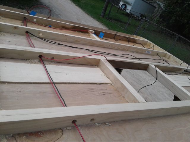

Postby Indiana Rambler » Thu Feb 17, 2022 8:26 am
Have t posted in a bit so here goes,Image
Started the spars and framing of the stargazer window and vent fan. Image
Installed a custom spar to accommodate the seam in the roof panels. Image

Postby tony.latham » Thu Feb 17, 2022 10:14 pm
Looking, great.
