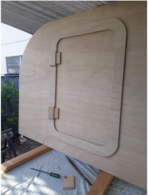

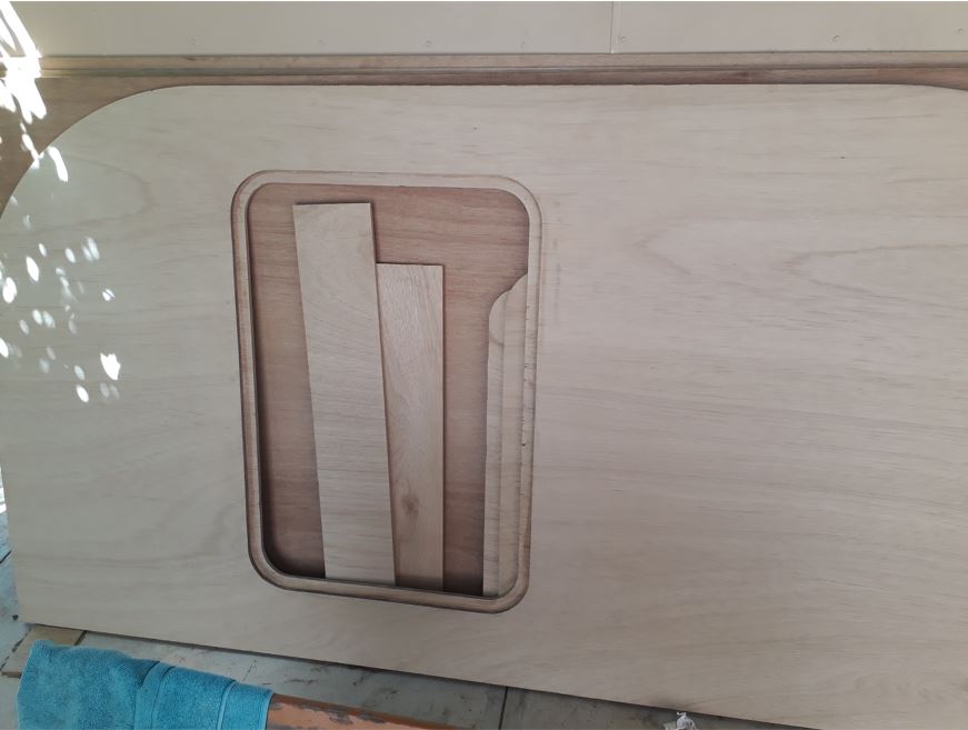

12mm hardwood marine ply, with a collar/door jamb fitted made from the same material.
Happy with the way these turned out. Got 'em done in less than 3 days of messing about working at retired pace.
left side door opening.JPG (56 KiB) Viewed 1013 times
The "door" will be the cutout piece.
I'm OK with these, cut freehand with my new Ryobi jigsaw.

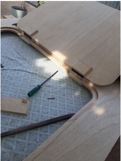

But, now comes the hard bit.

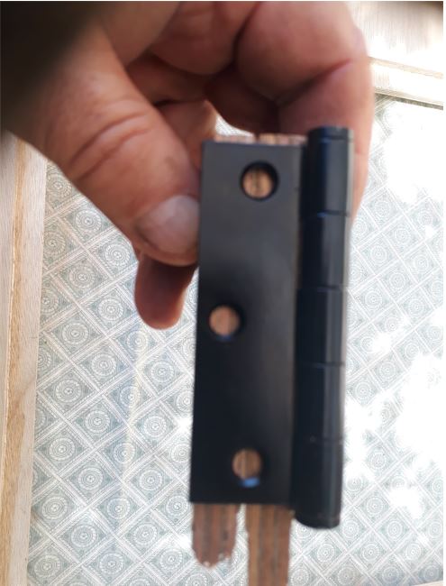

I've got these nice 85mm black powder coated stainless steel butt hinges.
Now, in your house, you fit these between the door and the frame so only the pin bit is visible.
I can do that here, but it means screwing into the cut edges of the plywood. I'll glue blocks of 12mm ply to the existing door piece for the hinges to mount to, but still screwing into the edge of the ply. The holes would be really close to the edges. I can see veneers being split apart.
Tried to photograph what I mean by holding two 12mm offcuts together and sitting the hinge on the edge the way it would mount if I morticed then in properly.
hinge on edge.JPG (53.03 KiB) Viewed 1011 times
I don't think this is very robust.
MickinOz

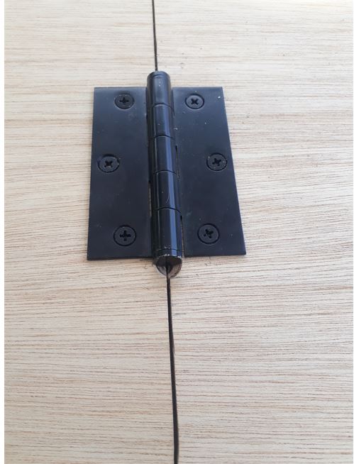

I think it will be stronger if I put the hinges on the outside and screw through the veneers into 24mm of plywood. (Supplied screws are just right for this.)
I have a line on some nice black L handles for the latches which should match.
Like this:
External Butt Hinges.JPG (78.38 KiB) Viewed 1009 times
Pros:
Far stronger IMO, can even be through bolted should it turn out the screws won't hold.
Less work to fit.
Cons:
Looks like a bit of a short cut, but I do see many done this way.
A thief with a screw driver has easy access, unless I find some security screws.
The missus has advised me to make a test piece, which I shall.
But, interested in what people think.

I agree with your list of pros and cons. I considered some of those same points when working on my build. In the end, I went with external hinges for the door. Mounting the door with hinges went relatively smoothly and quickly. With two trips and about 3300 miles of travel, I have not run into problems with the hinges.

Mine are done that way. Screws are fine. I think matching with the door handles makes for a good look. As for a determined thief, they can also find a saw... It is not a bank, only a place to sleep

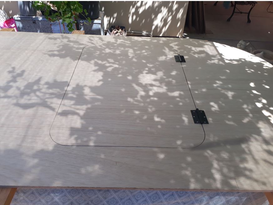

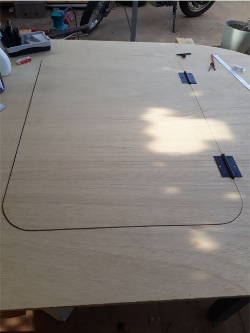

Only did an hour on the build today.
Mounted one door.
It's working beautifully.
Those stainless steel hinges have bugger all play, which helps a lot, I think.
Have to finish the other one tomorrow.
Had to run a little bevel on the door and the wall where the hinges sit, they don't lay dead flat when they are open.
Have ordered latches. They'll end up with about $35 worth of hardware per side.
