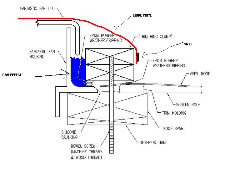

parnold wrote:The only problem I see it the possibility of creating a dam. See attached. What about a little vinyl "bonnet" to cover the vent, attached to the outside of the removable trim ring? Also see attached..
So the "damn" effect did become a slight issue. Water would pool up in there and slowly wick inside the teardrop, so I made a little cover a few months ago that snapped in place like Paul had drawn. That worked great for driving in rain, but when parked at a campsite it prevented the fan cover from being opened as much as I would like to be able to.
The other night I was bored and started drafting up some ideas and finally it hit me: add plywood sides to the trim ring, with a couple "spars" going between the sides. The sides will be contoured similar to the teardrops profile, and the assembly will be covered with vinyl, snapped into place on the front and sides just like the rest of the teardrop. The rear of the assembly will be left open to allow for airflow, but extend past the trim ring to prevent water intrusion.
