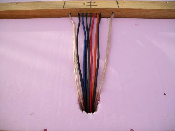

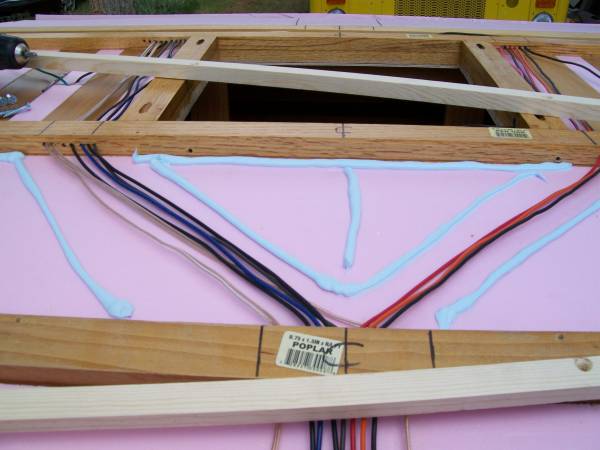

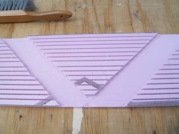

I finished up installing the second layer of insulation in the roof last weekend. I cut troughs in the insulation to make it so it would set flat down over the wires and not pinch them.
The two pieces of pine were used to hold down the edges of the insulation until the foam panel glue dried.
I cut out the hole for the wires to drop down through the front overhead cabinet. This is before the second layer of insulation was installed. I used the automotive convoluted wire loom (not shown) over the wires where it goes through the ceiling to keep the wires from being chafed by the plywood ceiling panel.

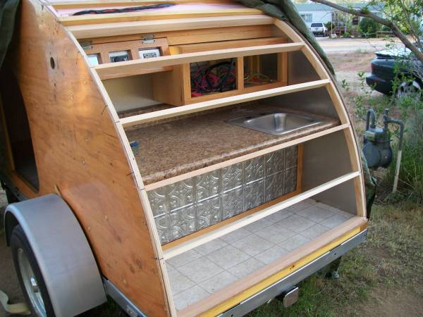

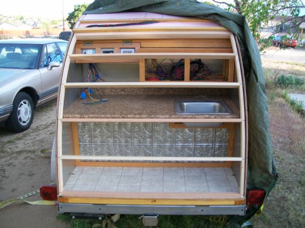

OK, as promised, here is the major accomplishment I got fabricated yesterday. The galley hatch frame, YES... It took me quite a bit of time to get it done. I just followed the Kuffel Creek plans and I think it turned out very well. It was so windy yesterday I thought I was going to get blown away. LOL I didn't like the spacing of the spars from the plans, so I placed them more evenly between each other. I think the marks for the profile on the side walls are more for getting the walls cut out properly than for spar placement on the hatch. When I put in the last screw, I showed Terry and she was ecstatic that I am now getting closer for that first camp out in it. I am ready NOW !!!
Today it is still windy and rain is called for. I am so glad I was able to get the hatch skeleton fabed up. More to come, sometime when the weather cooperates.

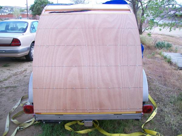

I got over one more hurdle this afternoon. I applied the 1/8" luan plywood on the hatch. I was able to get it on right before it started to sprinkle. I used PL premium construction adhesive and I held it down with screws across the spars every four inches. I will remove the screws after the adhesive cures. I was afraid the screws would mess up the plywood side gussets, so I tacked it down on the edges of them with my brad nailer.
I laid it on the back of the TD to take a picture of it to show you. What do you think of that? :o

I think it looks awesome... Is that big box store luan? I've got my brain stirring again after I bought some 12 ply baltic birch at Mastercraft in Sparks. (for the bath remodel). Just got to thinking if I should go baltic birch or big store ply for my tear.

atahoekid: Thanks "Kid"... I got the 1/8" (2.7mm) plywood from Home Depot. It is called hard wood luan. They say it is waterproof, OK... I have found that HD has better wood and prices than Lowes. I plan to put on a coat of epoxy on it any way to seal it. I think it was $9.00 a sheet.
It will be covered in "Silver Nugget" brand mill finish aluminum after all is said and done. :lol:

:thinking: I have found that some of the workers at HD talk with warm wind when they really don't know the truth. If you have an unused scrap of that plywood, test it by leaving a wet paper towel on it and see what it does. It may change your mind about how much you do to protect it from the elements. :roll:

Johnny its looking good bud and as Sharen said, some of the people just don't know what they're talking about. I worked there several years ago and they trained us very well back then but now they take them at the cheapest they can hire them at and put an apron on them. I purchased a couple of sheets of it and had it setting on some 2x4's laying on the floor of the garage and the condensation in there this winter and it delaminated.

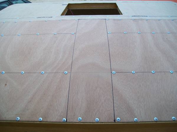

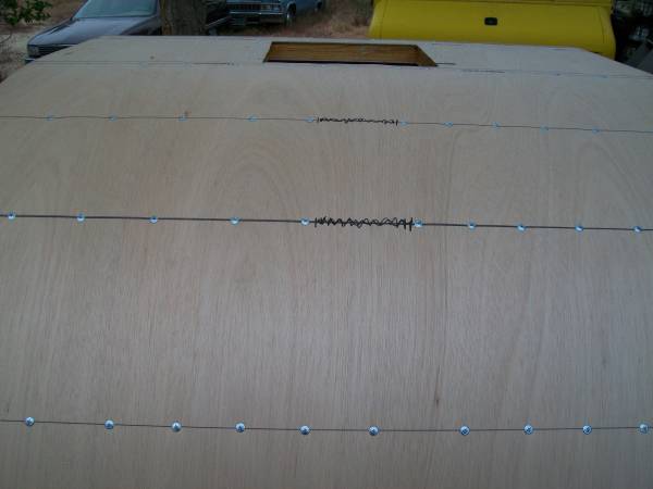

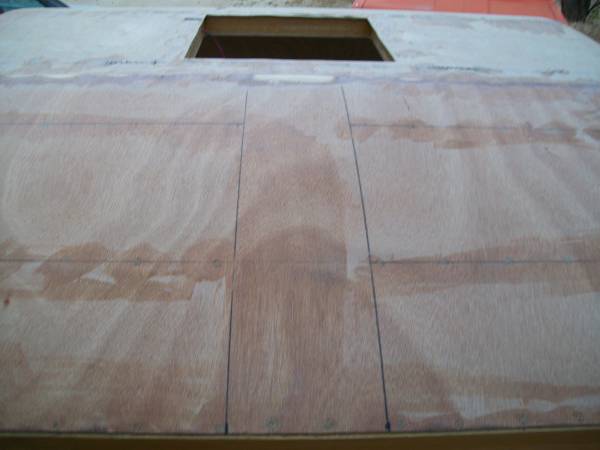

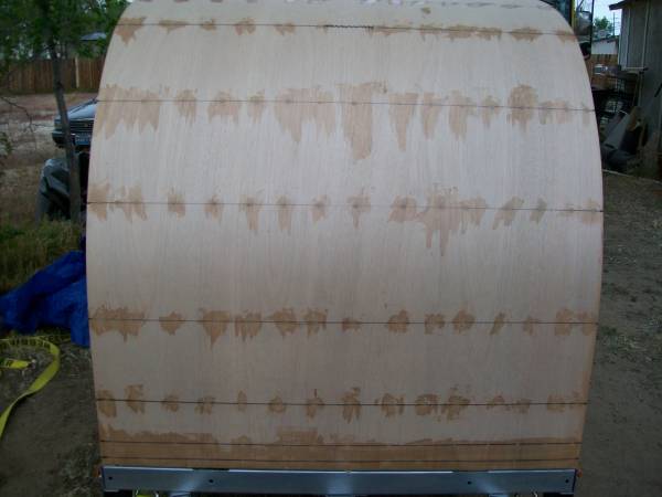

I was able to work on the TD a few days last week. I applied the outer plywood skin by gluing it down with PL Premium construction adhesive and I used screws to hold it down while the adhesive dried. After a couple of days, I removed all of the screws. Last night, I filled in the screw holes and today I will sand down the surfaces. I want to seal all of the roof to waterproof it as an extra precaution to keep the dry rot monster away.
The squiggly lines are so I did not run a screw into any of the wires.
Here is how it looks after the holes were filled in. It still need minimal sanding before the sealing can take place.
