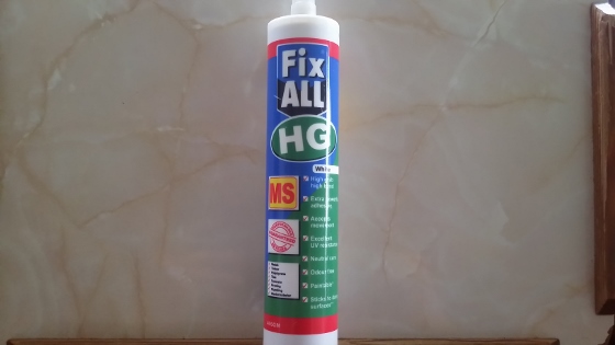

Postby Sheddie » Thu Apr 09, 2015 4:37 pm
felixx wrote:
Overnuts wrote:great job felixx :thumbsup:
I have a questions for you and sheddie:
- you told about sealant/glue, which one, or at least, which kind ?
- Glue-ing aluminium-Bond-magic-panel on wood framing is good enough ?!
I used a sikaflex product and when I ran out on the port side I used 1 tube of that and one tube of 'no more nails'
I did run screws every 200mm or so because I only have 6 clamps so needed to help it stay on!
2014-12-28 10.56.28 (560x315).jpg (71.88 KiB) Viewed 1544 times
This is the glue recommended by Ullrich for gluing the ACL sheets to the walls and roof frames. I also used it as a sealant when fitting the alloy trims around the edges and for the roof vent. When I fitting the alloy trim down the sides of the Galley hatch, I just used the glue with a small pop rivet at each end, as out at the side edges there was only the ACL to screw into. I left it clamped for 24hrs and it wasn't going to come off after that. It 'sticks like s--t to a blanket" and remains slightly flexable. I wouldn't recommend the liquid nails for this job it dries a bit too hard.

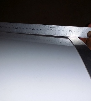

2015-04-10 07.32.12 (315x560).jpg (53.85 KiB) Viewed 1544 times
This is what I was trying to explain about the trim wanting to twist sideways on the curves. When you see it in the flesh you really have to look hard to notice it.
