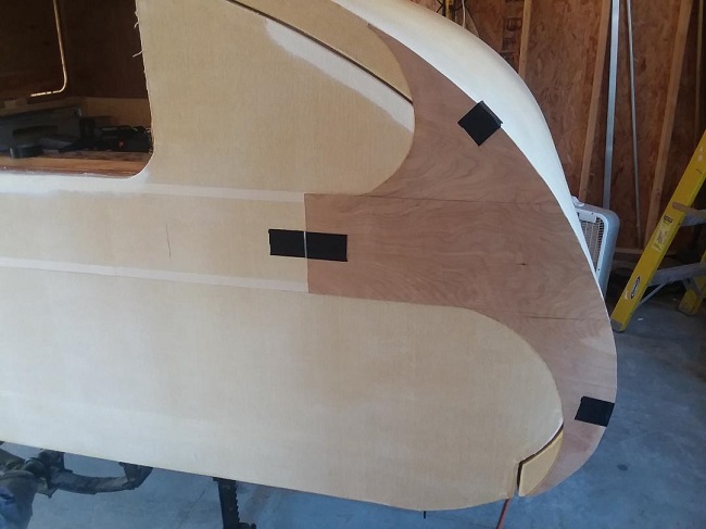

Postby Mr. Lahey » Mon Sep 23, 2019 4:04 pm

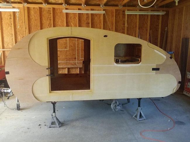

I stole a few moments from prepping for the garage heat project. I wanted to layout and mock up the below vintage stripe graphic from the pic I found. It would give me a chance to look at the graphic while I worked on the shop. So I quick laid it out on some scrap 1/8" ply cutoffs from the teardrop roof panels. I'm still unsure if I'm going to use it or not. So I want to look at it for a while and see how it sits with me. A few pic's of the templates I cut for the graphic.
Stripe I want to copy:
Templates I made to trace outline on both sides:
My teardrop camper build journal: http://www.tnttt.com/viewtopic.php?f=50&t=64721

Postby retep » Tue Sep 24, 2019 6:11 am
Very nice! I like the curves you chose. Fits the trailer well
Can't wait to see the final product.

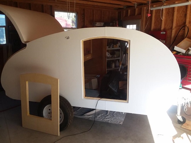

Finally have the weather, time, and motivation to get back to working on the teardrop. It feels good to be in the paint and final assembly phase of the project. It's also good to be working on it because I still enjoy it so.
Last season I closed out with finishing the PMF on the camper. I saturated all the canvas with 3 coats of 50/50 TB2 and water mix. It dried down to a very nice hard shell. It was also very coarse feeling. The surface was covered with fibers that rose up and dried hard. I decided to quick sand the whole camper to smooth that out. It went real quick as a light scuff sand was all it took. I then had a nice smooth surface for the first coat of primer.
Here are some pic's of the prime coat in progress. I will do a second coat of primer after another quick scuff/sand of the surface. Decided on a two tone paint job. The top surfaces are going to be a very light grey. The side walls are going to be a few shades darker grey. Thought is a neutral color scheme will look good behind any color tow vehicle I may use.
I've got some butyl tape on order to bed the windows, A/C hatch, and hatch hinges with. Also getting a list together of stainless screws together to mount all exterior items with. I have other projects going, so won't be full time on the teardrop. However this should be the season it get's completed. It's nice to be at the point where all the big tools are put away. No more sawing and belt sanding. Not going to miss that part of the build at all.

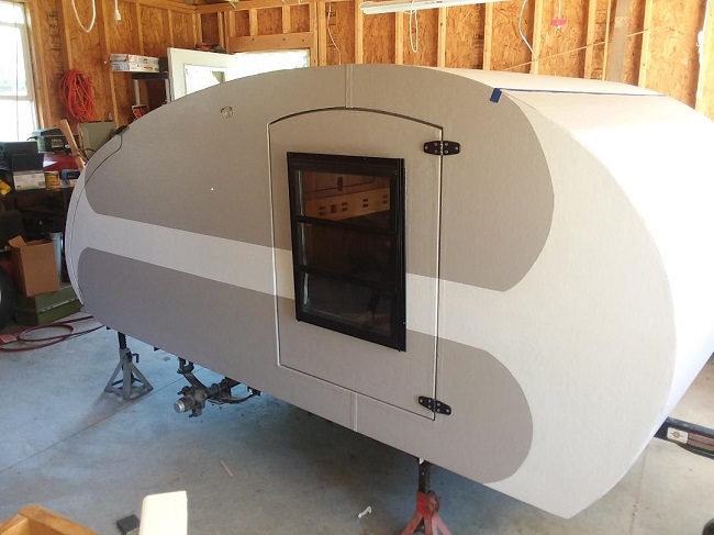

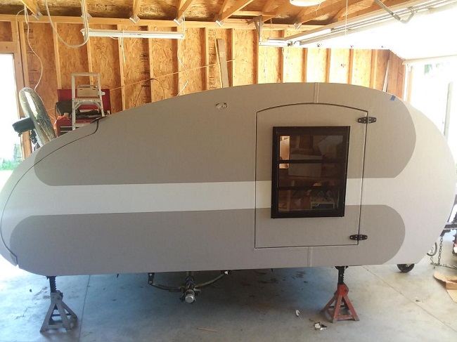

Postby Mr. Lahey » Tue Jun 16, 2020 1:27 pm
Just an update on current status. I've been priming and sanding and painting away here when time allowed.
2 coats of Glidden Gripper primer. 3 coats of Valspar exterior house paint. Lot's of drying and sanding time between each coat.
While I was painting and sanding I was deciding if I was going to go for the side graphic or not. Once I decided to use the graphic, I was debating if it should be a light or dark color. I settled on the light color I used on the roof and hatch. It's not a direct copy of the vintage graphic I posted a few posts up. I think it captures the spirit of the original nicely. I like how it now ties the two colors together.
Just today while working on the vent fan I changed the paint scheme a bit again. In the second pic below you can see the blue tape stripe across the roof. I painted from the tape down the front curve to the bottom in the dark grey color from the sides. Just seems like the light color would really show off all the busted bugs and what not that will collect on the front of the trailer. So that's it. It's painted and I'm sticking with it. I do have a spiffy twin color pinstripe tape on its way. That will get applied to the sides at the line where the dark grey side color and light grey colors meet.
Now I'm final installing windows, lights, vent fan, fenders and all the details. I will be camp ready pretty darn soon! :D

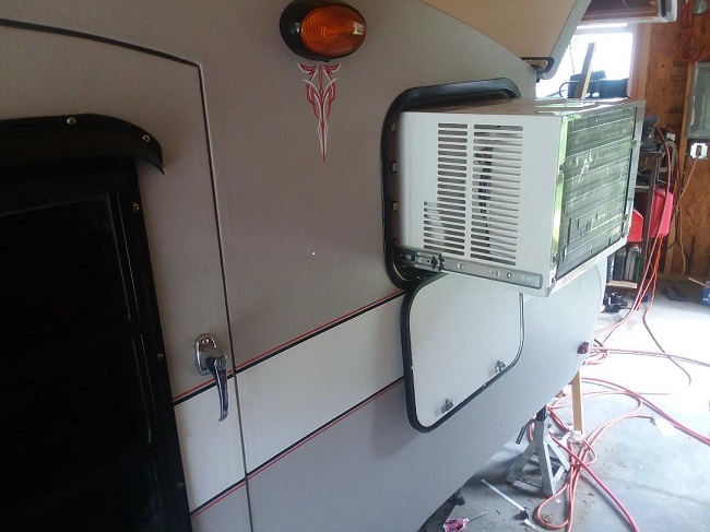

Postby Mr. Lahey » Wed Jul 08, 2020 2:35 pm
Well here is another progress update. Along with a new challenge to overcome as well.

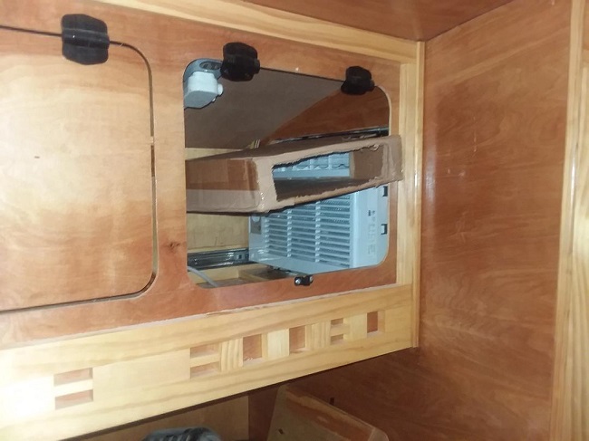

The tear is all painted, pinstriped, windows installed, vent fan installed and so forth. I've been working my way from front to back on the trailer. Which brings me to the latest challenge. Getting my A/C unit to cool and dehumidify correctly. From what I've read here on the forums the 5,000 btu window shakers are way too big for our campers. So the A/C won't run long enough to remove humidity. You end up with a cold damp cave. I had to work a bit just to get to the damp cave point.
Original concept was to just slide the A/C out. Turn the vents hard left to blow the cold air out of the cabinet and into the sleeper cabin. So fired it up and gave it a try just like that.
Fail.
All that happened was the cabinet chilled so quick that the compressor barely ran at all. Fan would run. The compressor would kick off in seconds. So the sleeper area was not cooling off much at all. Not to mention still very humid.
So I fashioned a crude cardboard test plenum to try and blow the cold into the cabin and keep it out of the cabinet. Worked like a champ. Problem is it cooled the sleep area too quick. Compressor runs a tad longer, but still not long enough. So it's cold but also very muggy and humid. So I've made it to cold damp cave status. Need to do better.
From what I've read in older threads here I need to slow the air flow through the unit. Get it to cool less so compressor runs longer. My question is am I better off restricting output or intake side of the A/C unit? Or a combo of restricting both sides of the equation?
Fortunately(??) I have the perfect experiment weather. High 80's to low 90's with insane 60 to 70% humidity. I figured now's the time to solve this rather than to be out camping and have these issues show up.
I'm going out there again now to try some restriction ideas I have. See if that helps or even solves it.
I welcome any ideas anyone has to deal with this, and look forward to replies as always.
Once I'm over this hill it's on to the back of the tear.
Final install of hatch hinge, hatch latch, and tail lights. Then install both fenders.
At that point I will be ready to camp in it!!!!! Hooray!!!
Test plenum
