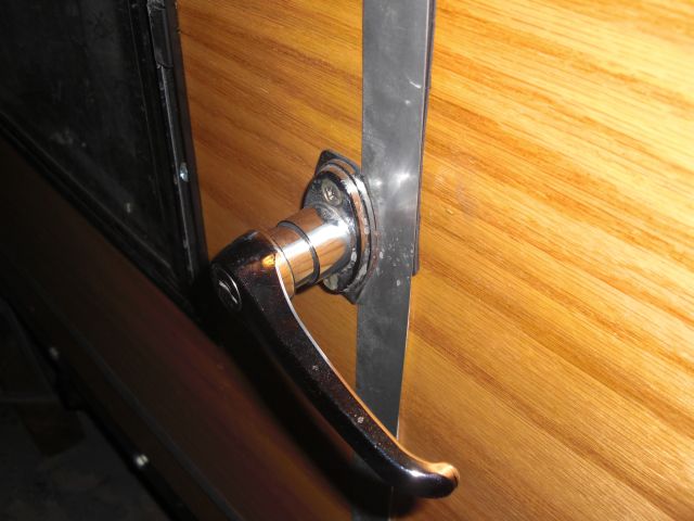

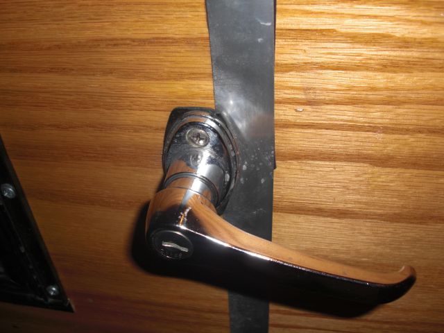

Postby Sparksalot » Fri May 22, 2009 11:44 pm
Thomas, here are some closeups of my trim and handle.
