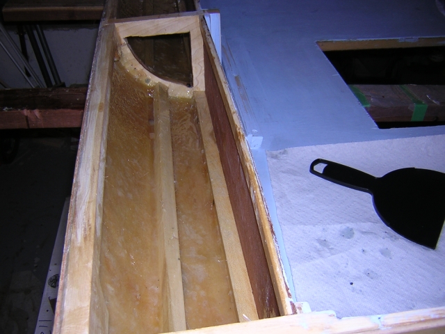

S. Heisley wrote:After reading what Prem wrote, I figured the waxed paper wouldn’t work for my fiberglass application. Also, I am using Doc Rot’s Lay-up & Laminate epoxy which might not mix well with acetone. However, the Lay-up & Laminate is a soap and water clean-up (if washed off while wet) yet it appears to be as good as any epoxy resin I’ve ever seen used, once it is dry.
So, rather than test first, I went at it with thought. This second outcome was a lot better than the first. Here is what I did:
1. I lightly sanded the previous application; then, vacuumed it to remove loose particles.
2. I cut the sheeting of loose fiberglass particles into pieces that would fit my individual sections, and carefully set them aside.
3. I brushed the surface with a layer of the Lay-up & Laminate and lightly pressed the cut sheeting in place, using a moistened paper towel. Because the paper towel was moistened, it did not stick or react with the loose particles or the epoxy resin.
4. Next, I wiped a spatula with a moist paper towel and began making chopping motions (sort of like mincing sliced onions) to break up air bubbles and further attach the fiberglass to the surface. Using only the end of the spatula in a chopping motion, the fiberglass particles stayed in place and did not attach themselves to the spatula.
5. After 4 hours of drying time, I applied another coating of the Lay-up & Laminate over top. Since it was a small area and I was being a bit lazy, I used a wet sponge applicator. Near the end, the sponge started to break up but the pieces are small and will be covered with paint…no big deal.
Below is a picture of the outcome, still wet from the last application of epoxy.
While the old, sanded errors are still evident in the white spots, most of them are now evened out and, when it is sanded again and then painted, I think it will look a lot better than it would have before.

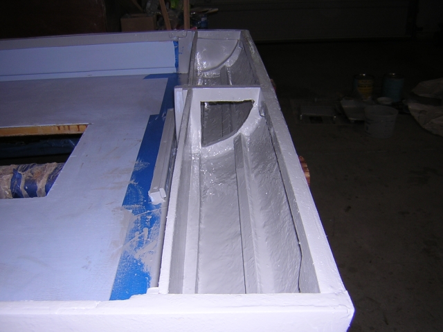

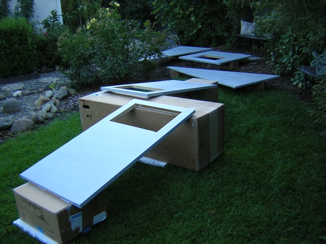

Postby S. Heisley » Mon Nov 01, 2010 9:57 pm
I’ve got 4 good weather days and I am using them! The first layer of primer went on the roof’s eve underside and on most of the small parts today. I don’t plan on mowing or turning on the sprinklers until these guys have 4 coats (2 primer & 2 top coats) of paint!
The lifting roof is the hardest because of the sharp curves on the eve and because it is so hard to flip. I won’t start painting the cabin until the underside of the lifting roof is totally done. This is because the lifting roof has to rest on the cabin when I am flipping it over and I don’t want to mess up either the paint on the cabin or the paint on the lifting roof.
I already got a little messy. I should have covered more of the ceiling. Ah, well….The ceiling was going to need another coat of paint anyway.
That’s all for now, trailer fans. I’ll post more when I think have something worth showing.
