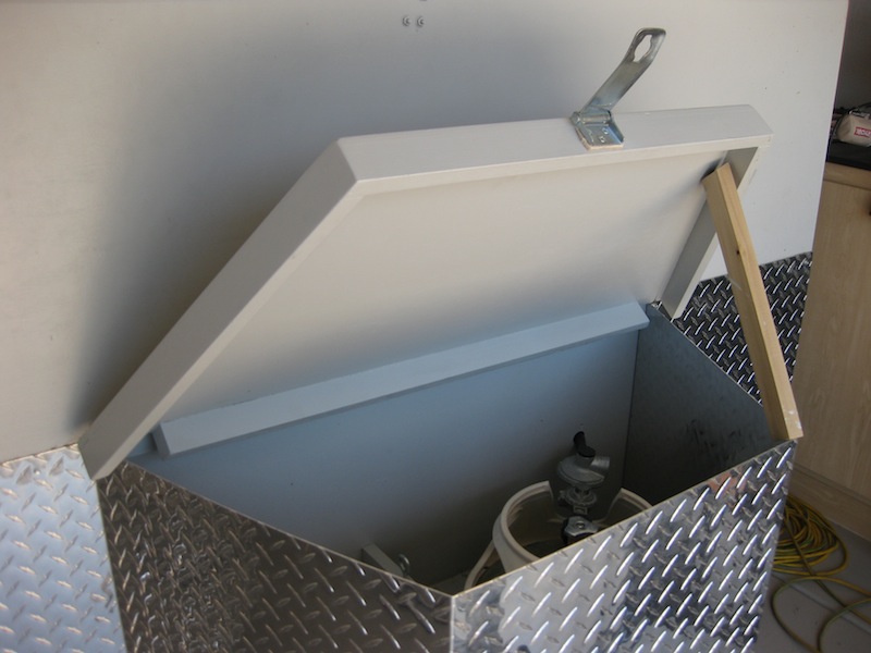

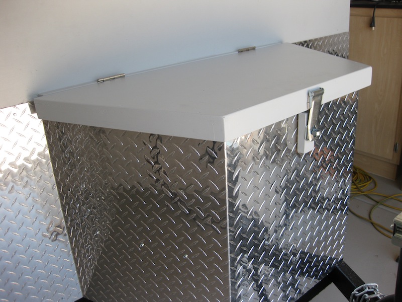

I guess a trailer that you build yourself is never really done. Today I took another step in that direction.
I had planned to cover the tongue box with the same aluminum diamond plate material (along with other interior and exterior trim to keep the theme going) but since I don't have metal working tools, I thought it better to make a cover out of wood painted to match the trailer. Here are two pics showing the nearly finished product. Simple and easy. Perhaps I'll add a spring or some such thing to hold the lid open, but there isn't much need to do that.

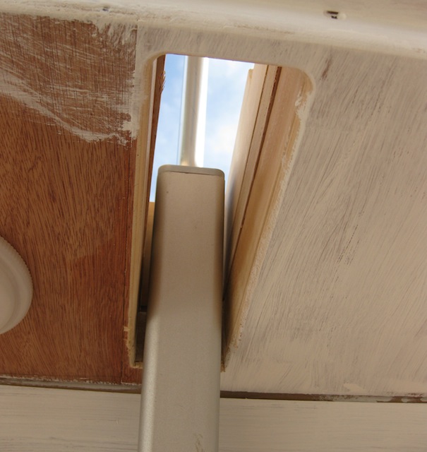

Hi, Mike. I looked at your actuator to try to remember how it worked and now see how it can be inside when the roof is down and outside, when the roof is up. Your implementation certainly has very good merit and people will want to know how you finished it. So, Mike, could you please post a picture of the final outcome? Did you end up using a rubber seal to keep the weather out of the hole or....?
Does the actuator run on DC power or does it need power at all?
Thanks!

Sharon, thanks for reminding me of yet another little unfinished project. The opening is small, about 1.5 by 4.5 inches. So, today I got a 6 by 6-inch piece of rubber backing sheet from the plumbing section of Lowe's and fastened it to the roof with two screws on the leading edge. That will keep out all but a couple of raindrops, but the sink is directly beneath the slot.
