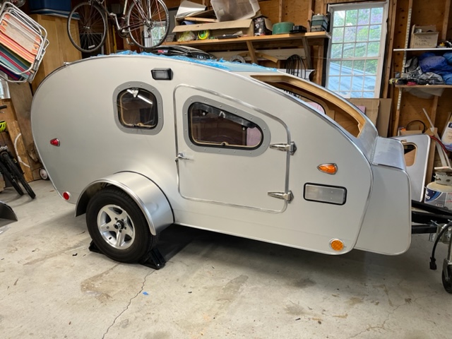

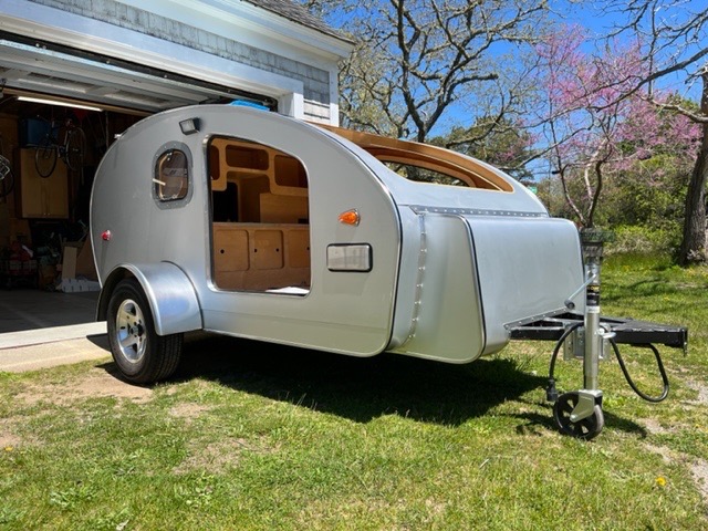

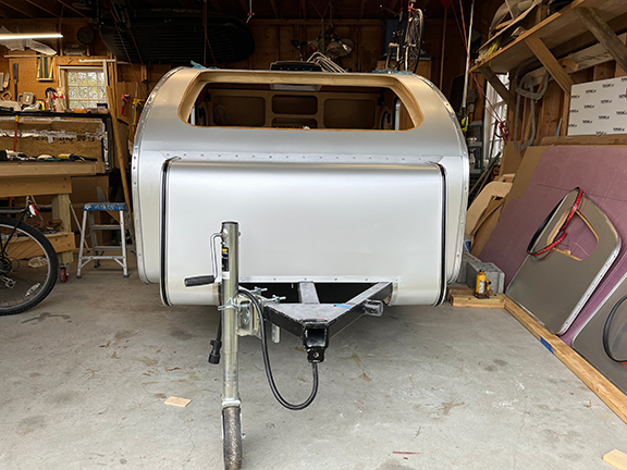

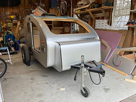

Took a break from working on the doors and finished up the front bump out... installing the trim and black vinyl insert.
Will go back onto the pop open windows today.
John

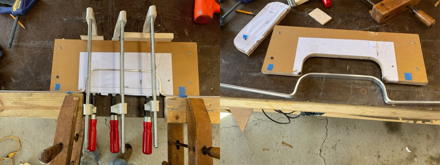

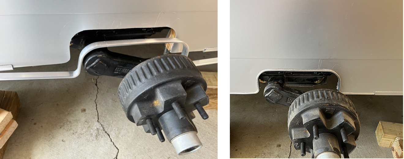

A month or so ago in another thread I had posted a photo of an experiment to try and bend aluminum trim molding to finish off an indent I had created around where the axle was to go. If I had to do it all over again I would have not created that indent and just run the side board straight across. At any rate from that experimenting with a jig I made up I finally got to put it to the real test. Finishing up with the trim around the wheels will now let me install the fenders (some point soon).... but below are some photos of how the aluminum bending went.
John

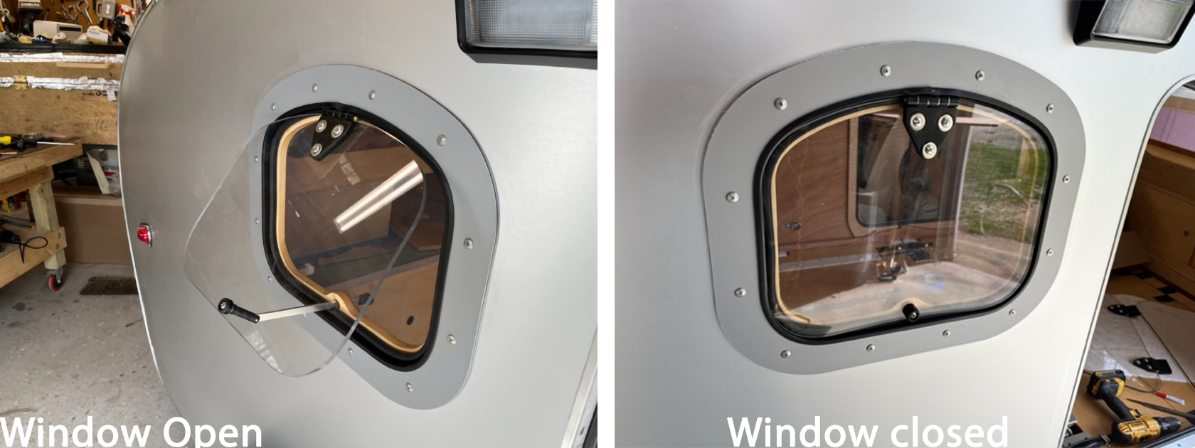

Thank you Featherlite, Jasen, Sharon and Staryder for your comments. Bending that trim was not all that difficult. The difficult part was actually installing it and getting the driver drill into the small space in the axle area to drive the screws.

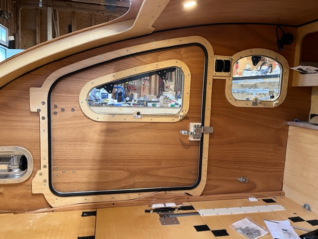

Some photos attached of the 2 pop open windows. They are fitted with bug screens. They will need some tweaking. The hole where the pusher post passes through is cut too low, making the fixed point where the post attaches to the window too low....... which is all causing the black part of the pusher post to rub on the bulb seal. Left this way that bulb seal will wear down and rip. I'll need to move the openings up about 1/8 inch.... but I'll save that for later.
Going to put the fenders on today and try and finish up the doors and get those installed (at some point soon). Then, just the big front window......

The windows look exceptional! Did you make all that holding hardware yourself or purchased it?

OP827 wrote:Did you make all that holding hardware yourself or purchased it?
Thanks for your comments, OP827. The "window hardware" I made, molded the hinges in a hard (low durometer) urethane. The push posts I machined. If you are interested in the "molding process" I documented most of it in my build journal.... around page 14 it starts.

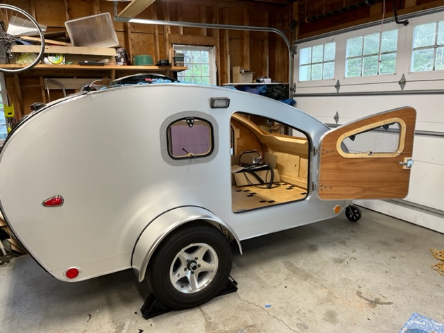

Got one door installed today. I had forgotten I added some wood backing in the interior in back of where the hinge's screws would wind up, to add more meat to hold the screws. And.... at last minute I moved the top hinge (off plan) making it lower.... so forgetting about that extra meat, missed the mark on the one. Moved the bottom hinge up a bit,(also off plan).... so missed the "meat area" there, as well. duh......
Also got some reflectors installed. That was fun.
