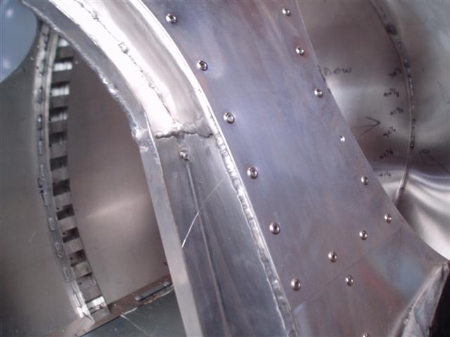

Postby mikeschn » Sat Aug 08, 2009 11:36 am

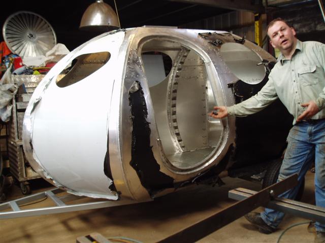

Can you give me a close up shot of the seam, with the rivits... like right near where the door handle might be...
this area

Postby dandan » Sat Aug 08, 2009 12:03 pm
Will do Mike,
thanks for the email. :thumbsup:
im hopeing to put the hinge at the top & have it gull-wing.
left enough room in the recess for a pair of gas struts to assist lifting.
got a locking stainless paddle-flap latch which will go central towards the bottom.
toying with the idea of putting a car boot (trunk) release solonoid with a
key-fob remote on it in the future.

Postby dandan » Mon Aug 10, 2009 2:44 pm
Ok Mike,
sorry it looks a bit confuseing with the background the same.
(looks like i missed a rivet)
there is metal finishing still to do but cosmetic work will have to wait ! :lol:

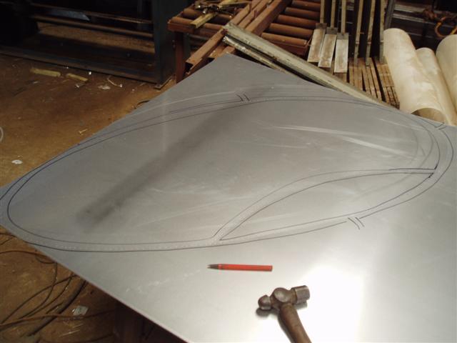

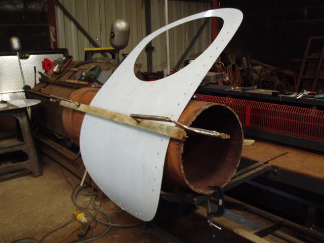

4 hours building today.
cut the door skin & gave it a bit of gentle persuasion.
then started marking & cutting the fenders cos the door
re-enforcements are to be made out of the off-cuts from the fender sheets.
(taped the drawing on the sheet & dotted through the paper)
couldnt resist offering it up for a sly glimpse of whats to come !
hope to get at least 10 hours tomorrow. (it needs it badly)
best rgds dan. :thumbsup:

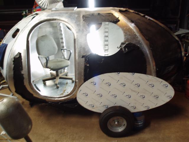

Postby dandan » Tue Aug 11, 2009 1:59 pm
Thanks again Guys for all the kind comments. :thumbsup:
think this is possibly the worse part of the build,
lots of time being ploughed in but little to show for it.
6 hours building today.
below is a pic of the inner door skin & frame.
the outer skin can be seen lurking in the background.
just put it in to see where im at
then started on the hinge assy.
hope to get time on it tomorrow pm.
will post again then.
