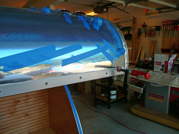

When I go to bed at night, I dream about installing aluminum trim. It seems that is all I have done for about six weekends now. Nearing the end of the trim work, aluminum strap was installed at the lower edge of the hatch.

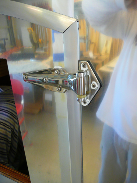

I had previously hung the doors, but had removed them to install t-molding. With the t-molding done, it was time to re-install the doors. First, though, I made some spacers out of 1/8" nylon. The spacers will offset the door to leave room for door seals. This picture shows the installed hinge and spacer.
I'm happy with the way the doors came out.

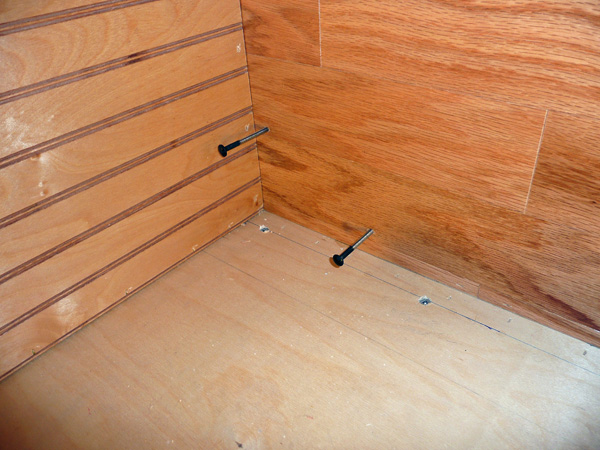

Next up - fender installation. I am using stainless steel carriage bolts installed through the sidewalls to fasten the fenders. This picture shows the carriage bolts ready to be installed in the galley portion of the sidewall. (The heads of the carriage bolts were earlier painted black.)
This shows the carriage bolts in the cabin of the teardrop.
And here is an outside shot of the carriage bolts ready for the fender.

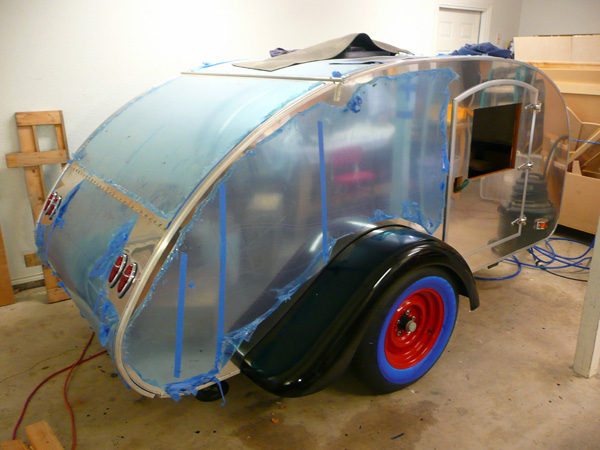

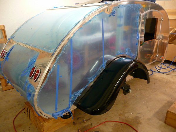

I didn't get any pictures of it, but earlier I had used weatherstrip adhesive to attach rubber fender welting to the fender. After some sealant was applied around the carriage bolts, I fastened the fender using washers and nylock nuts.
The carriage bolts were a little too long so, I cut the extra length off with a grinder and cut-off wheel, and then re-installed the wheel and tire.
One down - one more fender to go, but that will have to wait until this weekend.
