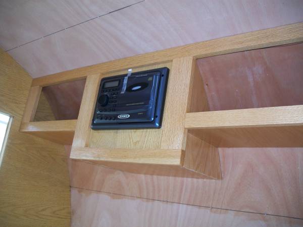

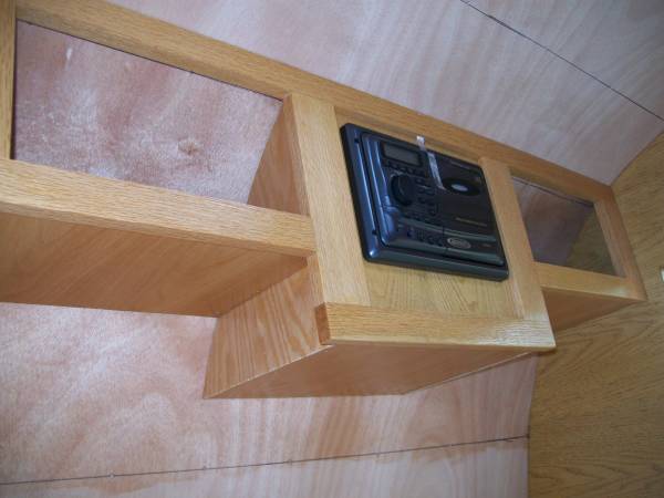

Today, I finished up the front overhead cabinet. I still need to trim it out. That comes later on. Next week I will be very busy trying to get it close to done. I plan to do the doors on first thing next week. I will be on vacation.
I really like how it is turning out. How about you? :applause:

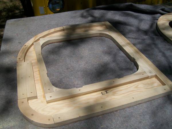

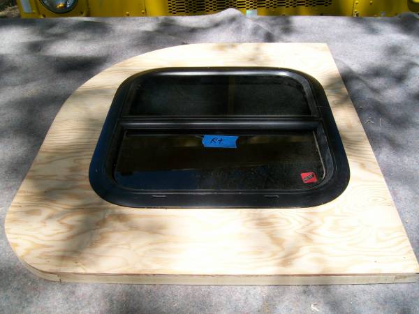

I installed the plywood inside the rear hatch the other day. Yesterday & today I spent building the side doors for the TD. I am glad that is done. You can see the progressive pictures of the door construction below.

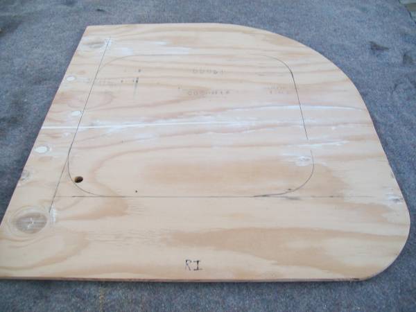

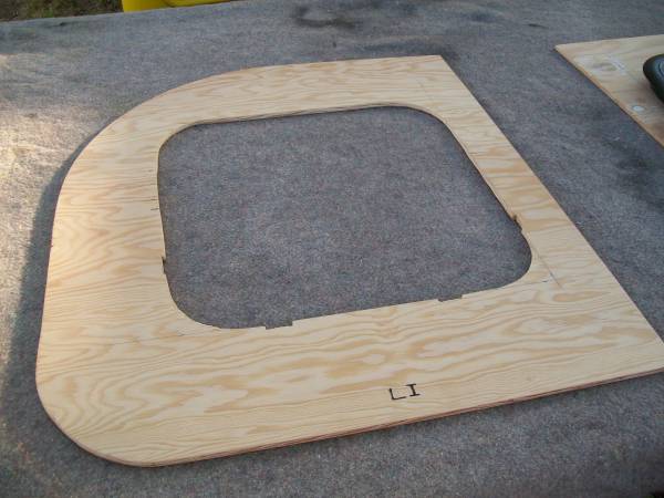

One of the door blanks. The Kuffel Creek plans called for the removal of 1/4" from all sides of the door skin.
Then I cut the openings for the windows with my jig saw.

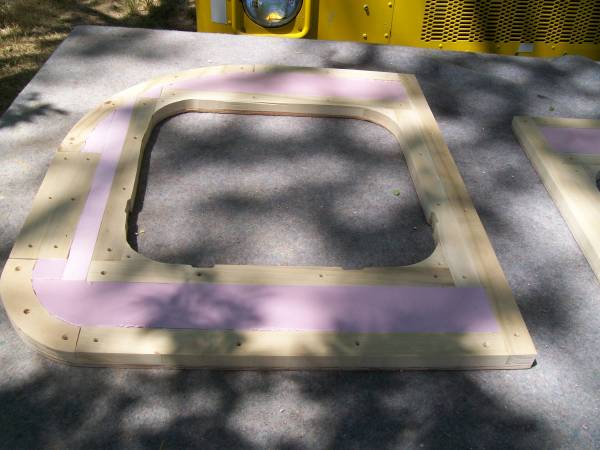

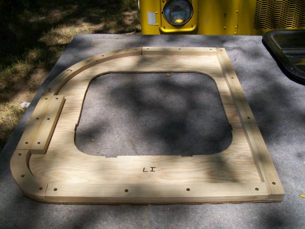

I framed the outside perimeter with poplar and 3/4" plywood.
Then the center framing to support the windows.
Then I insulated the empty cavities with pink 3/4" sheet insulation that I have used all along in this build.

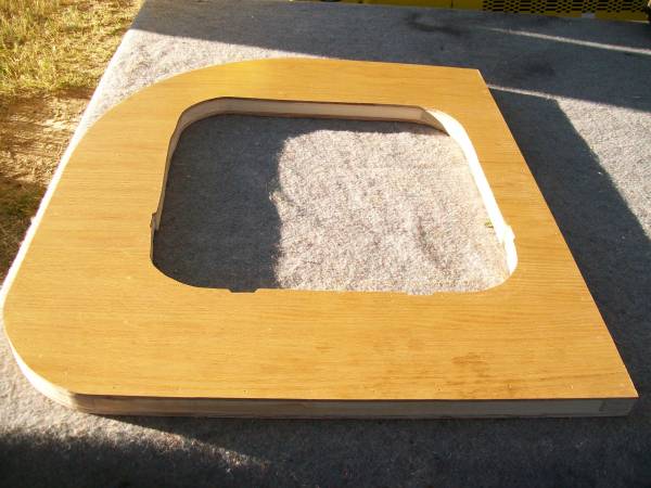

I used PL Premium construction adhesive and used my brad nailer to attach the inside door skins. I used my router table to route the edges to the same dimensions as the outside door skin I had cut to start with.
This is how it will look after the window is installed. I still need to seal the wood with spar polyurethane. The inside door panels are already sealed.
The sealing of the outside of the doors and the inside of the hatch comes tomorrow.
Then I need to trim the hatch and doors with aluminum. Oh Boy !!! ;)

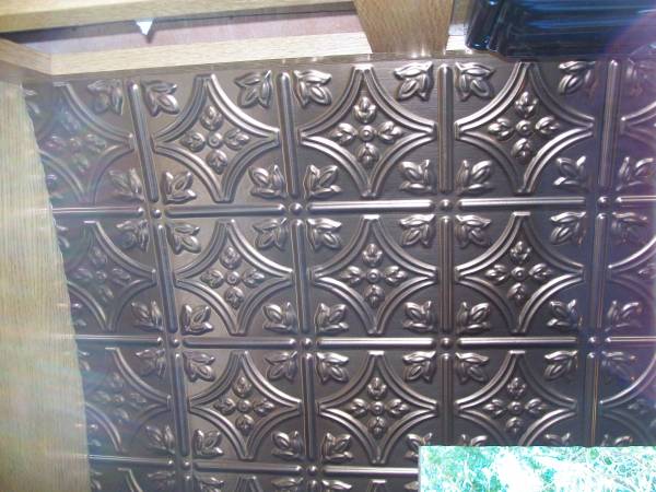

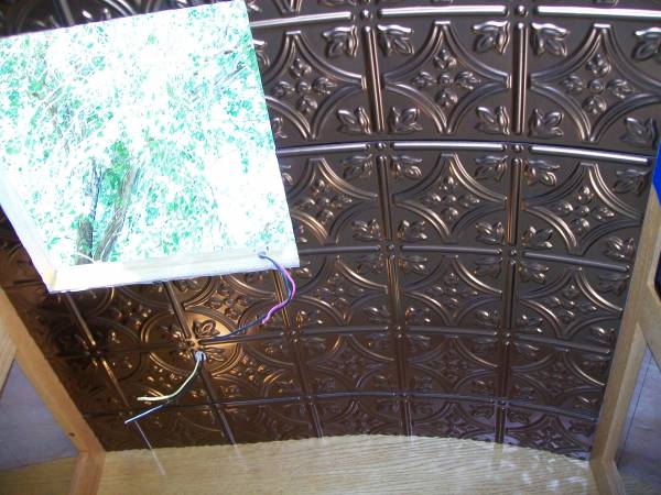

Today, I accomplished a major milestone in the build. I installed the oil rubbed bronze ceiling panels. I think it looks awesome. They are made out of plastic and are copies of the old tin ceiling panels from the turn of the last century. I will let you make up your own mind if this turned out OK.
I did not get as much done this week as I wanted to, but I got a lot done. I am taking tomorrow off to check out some camp sites with my wife Terry.

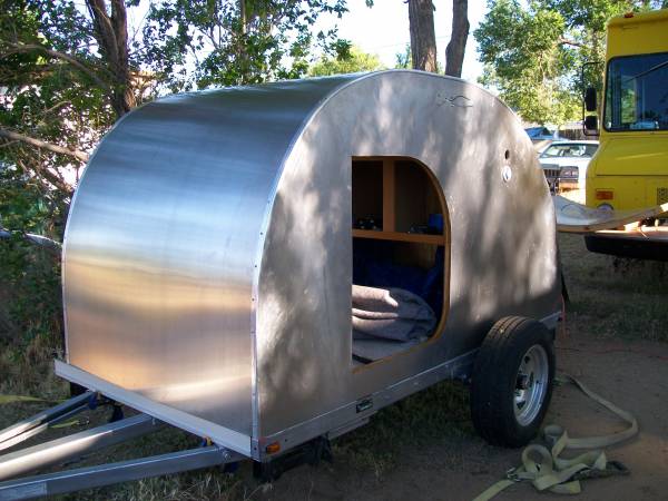

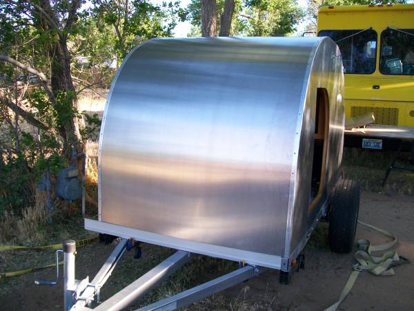

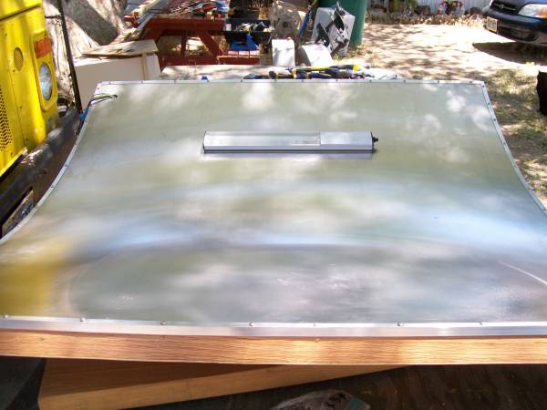

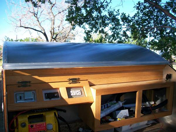

Terry and I got a lot of things done over the three days of the 4th of July holiday. The aluminum skin is installed with the trim where the roof and sides meet with my wife's help. The inside of the hatch is trimed out and the galley light is installed as well.
Terry made up the padded headboard that looks really nice. A picture of that as soon as I can take a picture of it inside the "Silver Nugget".

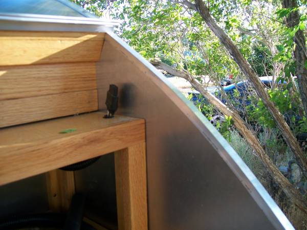

The hurricane hinge is mounted to the body.
I annealed the aluminum for the back where the hatch will rest on the side walls.
We still have to add the lower body trim and for the doors and openings. I still need to apply the aluminum to the outside of the hatch before it can be mounted. The doors need the skin installed and trimmed too.

I have a question, Is that U channel alum trim on your galley offset and if so was that hard to bend? Also is your alum trim 3/4" or 1"? I plan on getting my aluminum trim at lowes and just annealing it the old school way.

down under tech wrote:Today, I finished up the front overhead cabinet. I still need to trim it out.
Wow Johnny!! I hadn't read your build journal in a while. You're doing gr-r-r-reat!! I especially love this cabinet idea. I've been pondering how to install my power center in 3/4" plywood and the way you set the cd/radio in thinner plywood has solved my problem. Thanks for the inspiration! :applause: :thumbsup: :applause:
