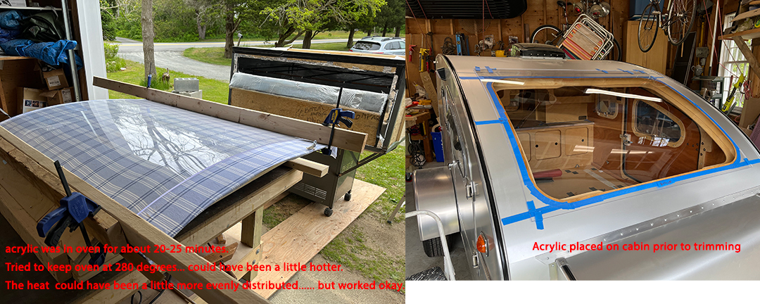

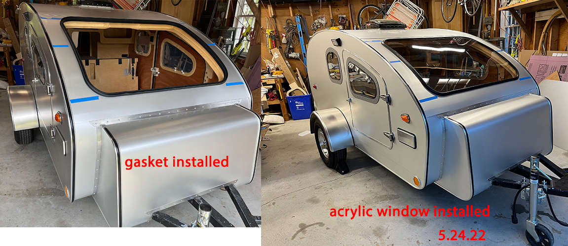

WELL.... BIG DAY TODAY!!
Fired up the grill-oven and tackled the front window. Picts attached. I found the form (the buck) had been affected by
the moisture sitting in the garage since I had built it in February. There was a bunch of unevenness. Went back to belt sanding some high spots and then covered the whole thing in aluminum to kind of even everything out. The oven worked well. Probably could have left the acrylic in the oven a bit longer...
the heat could have been a bit more evenly distributed. We (my wife and I) turned the acrylic once in the oven 180° to try and get the heat to affect all the surfaces evenly.....
but worked well. The hardest part was trimming the acrylic to be the correct size to fit the gasket. Put it in place and pulled it out 3 or 4 times, removing a bit of material each time.
I certainly didn't want to trim it too small. It still seemed to be oversized a bit.... but went ahead and imbedded the locking gasket and all kind of snapped into place. Satisfaction! :)
Very happy to have this part done.
John

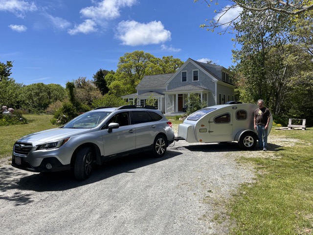

5.26.22
This morning hitched up the trailer and took it out on the road for its maiden voyage to the town dump where they have a scale. First weighed the car and the trailer and then just the car and subtracted the difference. Trailer (dry weight plus the Dometic fridge) came in at 1,760 pounds. So a little over than what I would have liked (was hoping for 1600 #s). So be it. When we returned I weighed the tongue weight and that came in at 207 pounds. So around 12% of the total dry weight. I figure with our bikes on the back and the future tongue box of some sort loaded with all its stuff.... we should be okay, weight wise.
Drove nice and nice to have brakes on the trailer.
John
