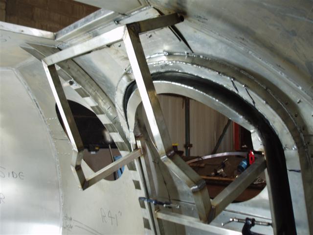

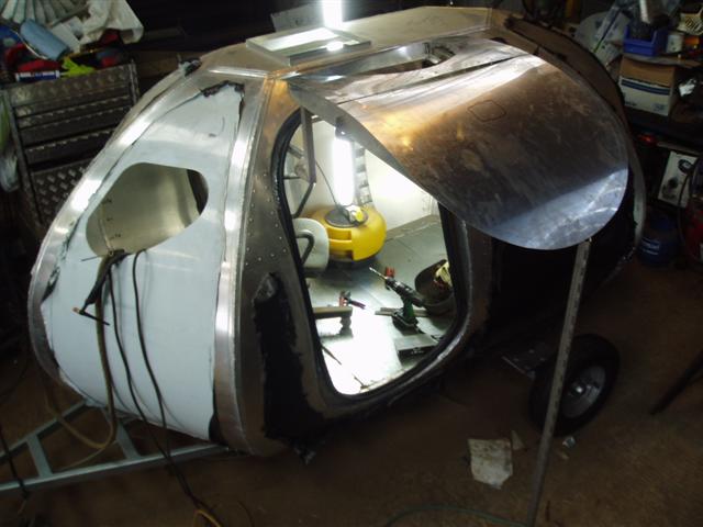

been doing a bit of re-work.
reckon i've lost 4 hours putting things right.
did a dry-run on the hinges with a bit of bent wire
then made the arms.
things were looking good until i tacked it together & the top of the door
fouled on the body.
had placed the hinge too close to the top of the door.
should know better :x
after a few choice words the hinge was re-located higher in the roof
& new arms made (sorry, mig welded. its a time thing now)
more of a pain cos the higher hinge has less space to operate with the
top radius clearance & cranked arms had to be made.
they are bulky & incroach into the cabin but thats the price paid for a gull-wing door !

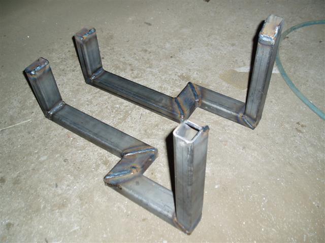

have collected some 25x25x1.5mm (1 x 1 x 1/16") stainless box section for the job.
decided the old stuff was too heavy.
should be in it again mon pm.
best rgds dan. :thumbsup:

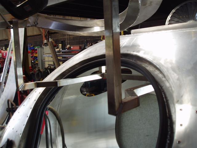

made the stainless frame, (alot lighter than the old one)
& tacked it on to find where it sits.
will wire-brush the welds at some point.
a different view.
have adjusted the frame to get about 4" more height than this when open.

How about getting some old tennis balls and cutting them up to fit the corners of the hinge frames? I mention this as a large 'sympathetic bruise' has appeared on my forehead, just from me thinking what will happen when you sit up quickly in bed.....

Postby dandan » Tue Aug 25, 2009 1:58 pm
what a cracking idea :thumbsup:
rather a tennis ball imprint on my head than a 90 degree dent :lol:
2 hours faffing today.
not much to show for it but it needed doing.
this door is going to need more faffing applied, 8 hours worth at a guess !

That hinge looks to take up quite a bit of room and is a sure bruisemaker. I was thinking more like a 'C' shape

Postby dandan » Tue Aug 25, 2009 3:44 pm
Hi Ageless,
like the idea. :thumbsup:
was thinking of fitting some car bonnet (hood) hinges.
will do so in the future when time is available.

Try older model trunk hinges
