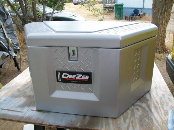

Dave: How did you know I was going to mount a tongue box on the front? Terry and I went to Cabelas Wednesday evening after work and picked up a plastic Dee Zee triangle box to put up front for $99 on sale. I plan to paint it silver before I install it.

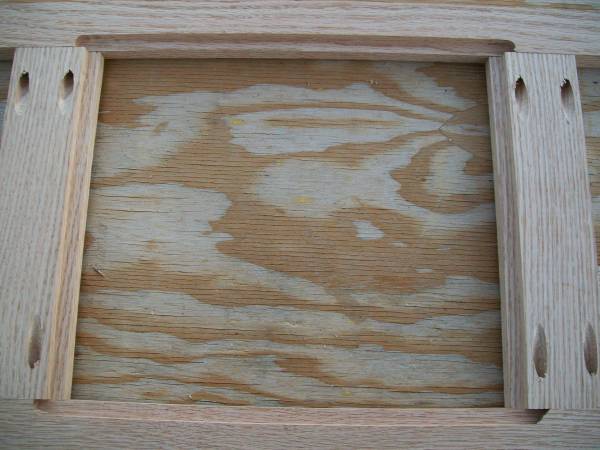

Lil: I just ran the edges of the back of the face frame through my router table and cut the center pieces and that left a lip to lay the 1/4" plywood in and it is recessed for a nice look. I plan to do the cabinet doors that way too. You can see a picture of that below.

I got the tongue box painted today. It was black. I used Krylon Hammered Silver paint for plastic. The weatherman was calling for rain, so I stopped there and I will be back at it tomorrow morning. Look for a better update then.

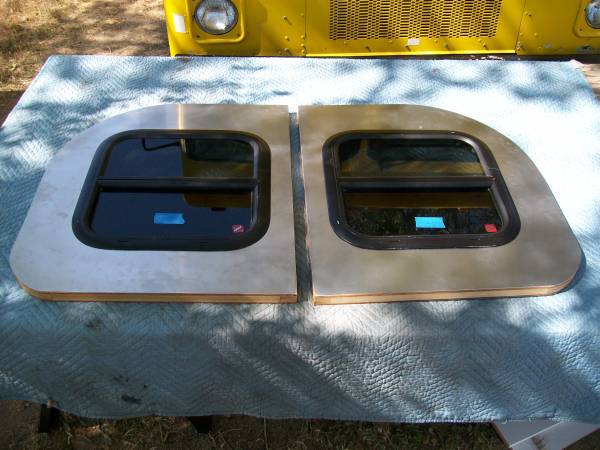

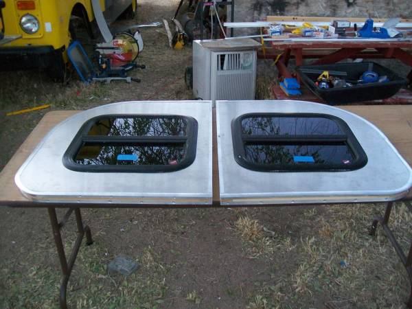

Postby DMcCam » Tue Jul 19, 2011 1:13 pm
Hi Johnny, love the doors! It looks like you have two layers of aluminum molding on them? Or did you use just the 3/4" 'T' molding (I can't tell from the picture)? Are you planning on sealing them with just the outside 'T' or are you going to add an interior seal too?
Again, great work sir,
Dave
DMcCam
Posts: 883
Location: Reno, Nevada
Postby down under tech » Tue Jul 19, 2011 4:45 pm
Tom: Thanks, I am just trying to make it look good so when someone asks who built it, I can say "I built it myself". Your "Silver Beatle" TD is coming along very nicely as well. You are a better craftsman than me though.
My TD will look good and I am proud of how it is turning out. ;)
Dave: Your TD is of much better caliber than mine. The doors will have one seal behind the tee moulding. The doors did turn out good. I like the way they look. I used 1/2" angle on the hinge side of the doors, inside and out. I tried to use the 1/2" on the inside edge of the doors on the curved part of the door, but when I got to the tight radius at the bottom of the door it kinked up on me even though I annealed it. I did like the "Cubby" plans told me to do, I cut down one leg of the angle to 1/4" wide on my table saw. I was not sure I should do it on the table saw like the plans called for, but I made a feather board to hold the trim down and against the fence and it went fine. I ran six of them through the saw. I dressed up that edge with a file and I drilled the screw holes next on my bench top drill press at 4" intervals and countersunk the holes for the screws to set flush when they were tightened down. Once I had them all totally machined, I annealed them. This time they bent around the curves with ease. I used 1" tee moulding around the outside edges of the door. It bent very easy. I had to finesse it with a rubber hammer on the two tight turns.
You can see how that turned out. :thumbsup:
Today, I will trim out the door openings on the side walls with the remaining four pieces of trim.8)

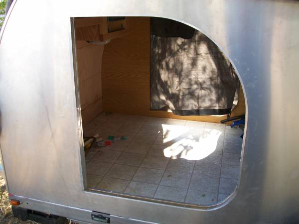

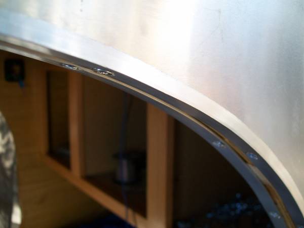

Postby down under tech » Wed Jul 20, 2011 10:47 pm
Today, I trimmed out the door openings on the side walls. It went pretty smooth. It was very time consuming though. I took a couple of pictures to show you. It will be next week before I can work on it because of the 13 hour days I have been working at my job. Terry and I will be camping again in the cargo trailer this coming week end. It worked out good the last time we went. We both need the refreshing down time a good week end of camping can give you.
