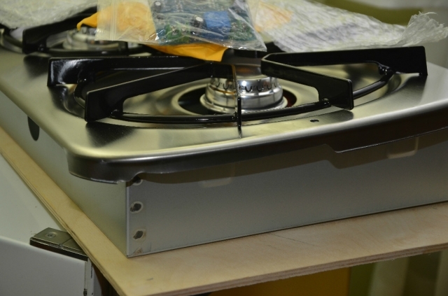

Thanks guys. No, I did not build cabinets before, just an "amateur with some youtube experience" :lol:. I do have some good table saw and router and built some jigs though. Flame king cooktop, it looks as in pictures and will do fine in the camper. Finish is good, I just do not understand why the crome top edge has curved openings on the sides and back.. I was also a little bit caught off guard with its hookup in the back, was not expecting that. It will require some creative shielding to propect the copper gas feed line from being heated off refrigerator heater under it. I was expecting that the line could be ran from side as well, as it is in atwood stove. I guess the manufacturer logic was that if someone connects in with a rubber hose, the heat from cooktop is not going to affect it.. kind of foolproof idea, but at the cost of installation options. Will work around it.

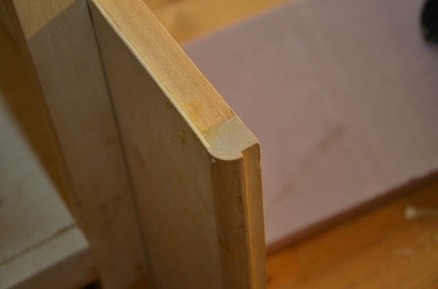

Postby OP827 » Sat Dec 03, 2016 8:31 pm
Today's progress update:
:snappy:
Fridge and furnace vent openings in the side wall are cut and kitchen cabinet with partial back bed and one panel of front dinette is now permanently in place.
Epoxy is setting up, garage heater is on.
And this detail shows a rounded corner that dinette seating will have, someone's toes in the future might thank that round corner.

Postby OP827 » Sat Dec 03, 2016 9:17 pm
Atomic77 wrote:Oleg, I'm trying to figure out what you are referring to regarding the chrome on the Flame King. Curious. :thinking:
Sorry, not chrome, but stainless steel top. It has cutouts on the sides and back, must be for ventilation so lower enclosure does not get too hot, I think, see the picture I did below.
My tent trailer cooktop did not have those.
OP827
