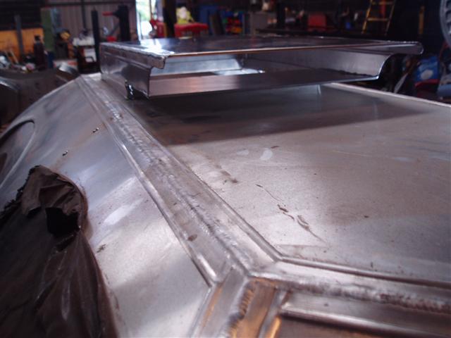

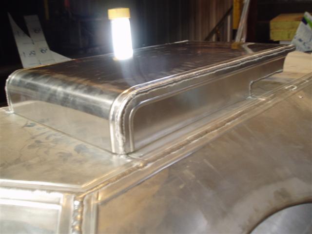

10 hours today & pleased with progress.
made a modified fixed roof vent.
cant make my mind up if it looks ok or a bit cruddy.
only riveted on so its easy to remove if it needs to go at a later stage.
may put a 12v car rad fan in the roof at a later stage if it stayes.

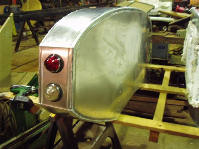

cut & folded the fender wheel shrouds / liners & riveted them in before
welding, then cut the holes for the lights.
just placed them in for a piccie.............
there is also a forward faceing indicator & a teardrop marker light in the top.
have offered the fenders up & dont think i will be changeing them for double-
curvature ones in the future. they seem fine to me.
hope to get them mounted tomorrow, then its door & window time.
best rgds dan. :thumbsup:

Oh man you are never going to be able to relax while pulling that - EVERYONE is going to want a tour :)
The air vent is soooo right for the Roswell!

thanks bve for the view on the roof vent. :thumbsup:
think its here to stay.
my brother dropped round to see it yesterday & was rubbing his eyes a bit.
he reckons im going to be busy answering questions about it.

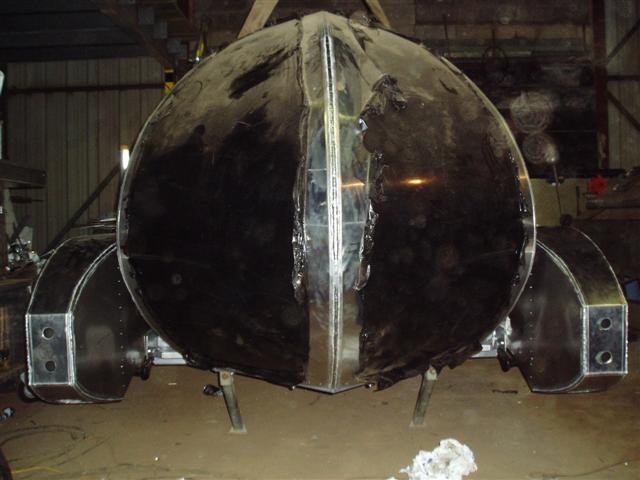

anyway, 12 hours today.
capping run over the fenders then its mounting time.
made steel re-inforcement bars for the fender mounts.
apologise for lack of method piccies, was trying not to faff too much.
here they are..............
the numberplate brackets will provide a 3rd point of contact for them although
they are pretty rigid as is.

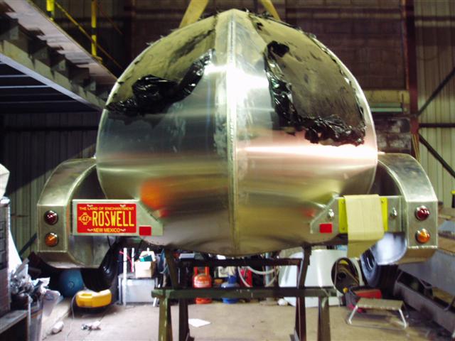

Postby dandan » Tue Sep 01, 2009 5:36 pm
Thanks for the comments. :thumbsup:
another 12 hours today.
made & fitted the fender stays which also double up as numberplate holders
then got the wireing out of the way.
(a friend came round & did it for me)
& fixed all the lights on the fenders.
its the door & windows tomorrow!
early start & long day again.
