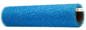

Postby twisted lines » Thu Mar 19, 2020 3:22 pm
Something to look at, https://www.amazon.com/TUFF-Coat-Textur ... B003NTM0V2
I planed on ordering my paint Tuesday, but Something came up :shock:
I am not sure I can roll it on with a 9" roller, any know reason they don't offer them with Monstraliner?
Does the material look the same?
Thanks TL

Postby S. Heisley » Mon Mar 23, 2020 9:36 pm
:thinking: Some paints will actually make foam disintegrate. Some paint rollers have a foam base and some are all foam.
You might consider asking the manufacturer.

Postby tony.latham » Mon Mar 23, 2020 10:07 pm
Other than the length, the material looks the same as the ones from Monstaliner. Certainly, it's the right color.
