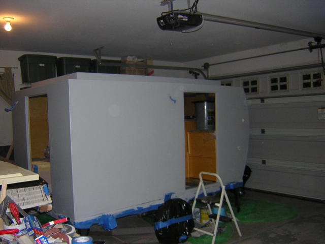

Hi, all. I took Thanksgiving week off to work on Holiday stuff but still managed to get a little bit more done on the trailer. A large majority of the garage is covered in painting supplies, plastic, paper, painters tape and the like so that I can make the best of warm days when they occur. The underside of the lifting lid is painted and flipped back over and its upside has its first coat of primer on it, as does the cabin:
Primered Cabin...Sorry, I've got sand on the camera lens again. I've sanded so much that the garage door opener doesn't work anymore, even when I blow it out and knock it with a broom!
When sanding, I got to a point where I just couldn’t tell what was good enough and what wasn’t and sometimes rough spots got overlooked. Having the first coat of primer on really helps to show up those overlooked spots. (The trailer doesn’t look quite so ugly any more, either!) I’ve got some more sanding to do before I add the second coat of epoxy primer and the two topcoats of white polyurethane. I’ll post more when I have something worth a picture.

:applause: :applause: Looking G O O D Sharon!
We look forward to the next picture.

Thanks, Rod. She does look better with a coat of paint on her.
