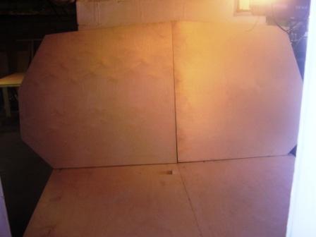

Postby Alfred » Thu Apr 09, 2009 8:54 pm
Hey Gang,
Does Harbor Freight sell any of those board stretchers???!!!
Doh!
Thanks everyone for your help. I am thinking as per Miriam's thoughts, perhaps when I actually drop it down on the frame and shift it forward a little, it won't be as pronounced.
AL.
Alfred
Posts: 1633
Images: 368
Location: NC, Asheville
Postby Dean in Eureka, CA » Thu Apr 09, 2009 9:56 pm
Yaa... A lot of builders hang the wall lower than the floor intentionaly.
The wall then "Skirts" and hides the frame from view.

Postby mikeschn » Fri Apr 10, 2009 3:45 am
Don't drop those sides. You need every inch of headroom you can muster... Especially when trying to fit 3 growing kids in the bunk above your feet.
Postby S. Heisley » Fri Apr 10, 2009 9:34 am
Hi, Alfred:
For what it's worth, here are a couple ideas. You will already have a seam in your wall. If you put your doors where that seam will be so that the edges of the plywood cuts hit at each edge of the doors, you will only need to add a small piece of plywood above the doors. If you add trim at the seams there, it will look like you intended to do it that way, like a design feature. It would be sort of like an 'H' shape, with the trimmed doors being the bottom of the 'H' and the trimmed, added piece being the top of the 'H'. You probably already have enough scrap left over from the cut to do this; and, if you don't, they sell small, cut pieces of plywood at the big box stores that would work for that little area. Even it you decide to put a piece at the top and at the bottom of the doors, it won't look odd and won't take a lot of plywood to do.
By moving one of the plywood sheets to the edge of the door, one of your pieces will be moved forward or back and that piece will need to be trimmed again, to adjust to your size and design.
Another idea is to cut the front piece on the diagonal from where you need the extra length to the top. Then, add a diagonal piece there and color/paint that area differently, to make it look like a part of the planned design. Some of the best brain-storming ideas start with little flub-ups. :thumbsup:
Thanks for sharing your building adventure. :applause:
Posts: 8865
Postby S. Heisley » Fri Apr 10, 2009 9:43 am
PS. If the fender is in the way of repositioning the door to where the plywood cut is, you might be able to just use wider trim boards around the doors, to cover up an added piece there.
Posts: 8865
Postby starleen2 » Fri Apr 10, 2009 9:55 am
I agree with Mike about just adding the extra three inches into the middle seam - _ If the ply is not joined together yet - you could route a spline, cut and glue biscuits in, or just brace behind the whole thing with a 1x6, whatever. To drop the whole thing may rob you of precious needed sleeping area. It may not seem like much, but it will all add up when you begin to close things up. :thinking:

On 2nd thought...Dumb mistakes and Dumb luck
Postby Alfred » Fri Apr 10, 2009 10:42 pm
Hey gang,
Tonight, I went down to the garage and took a 2nd look at my wall situation. I had always planned on attaching them to the side of the 2x4 floor frame, of which about 1 1/2 inches is above the trailer rim. This means I have to drop the walls 1 1/2 inches anyway.
Mike, if I set them on top of the floor, I won't be able to get it into my low garage, which is one of the things we had talked about initially. So, just dropping this 1 1/2 inches stays consistent with our original plan. Anyway, it looks as if the 1 1/2 inch drop just about compensates for the shortage I saw. I had forgotten to factor the 1 1/2 inch drop in.
So basically, it looks like dumb luck is going to trump my dumb mistake, or probably more accurately, I have two dumb mistakes that are going to cancel each other out...
But, alls well ends well. We are going down to Tampa this week for Spring Break. I won't be able to work on the camper again until next week (Darn it)!
Al in Asheville. :thumbsup:

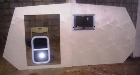

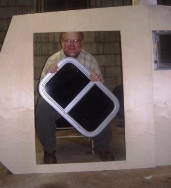

Postby Alfred » Thu Apr 23, 2009 9:49 pm
Hey gang,
Making progress! Cut-out the doors/windows! See pix below!
Al in Asheville :thumbsup:

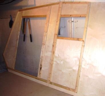

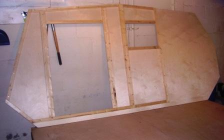

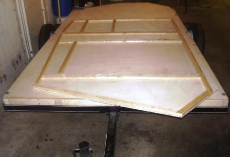

Postby Alfred » Sat Apr 25, 2009 11:41 pm
Hey Gang!
Started framing the walls today. Man oh man, this took a lot longer than I thought, and I did not even complete one whole side, but still I made some progress. I've never framed anything before, so I am thinking I did not do so bad for a first attempt. I am fairly certain I did not get everything quite square, so I am hoping it is close enough not to cause major problems down the road.
Thank goodness I bought a miter saw before I started, I never would have gotten the angles even close. There was still a learning curve on the miter saw, too and I did better on some cuts than others.
I forgot about the bolt-heads sticking up from the floor and I am going to need to cut clearance where the bolts are, from the bottom of the 1x2 framing. (You can see the bolt-heads in picture 3 below). The plywood below the 1x2 framing is going to be screwed into the side of the floor framing that rises above the rim of the trailer. As far as trimming clearance for the bolt-heads, I am thinking I can do this with a router, but I've never used a router before, so I am unsure how exactly to do this. I might wait until I go back to the community center woodshop next Thursday.
I did this part in my garage this afternoon and tonight.
I also have a question about notching the galley lid. I am thinking I notch it AFTER I have framed it, so when I cut I am cutting both the plyboard and the framing together? Is this correct? If so, I am going to frame the back with a wider plank (1x3 or 1x4?).

Postby Miriam C. » Sun Apr 26, 2009 8:24 am
:applause: :thumbsup: Looks great! You are correct with the notching. Definitely do it and the framing together.
The bolt heads can be done two ways. You can use a paddle drill bit and make an inset the bolts to the bottom or you can use the same bit and make room in the sides. I would choose which ever board is thickest.
I definitely would not use the router without lots of practice on you almost finished side.
