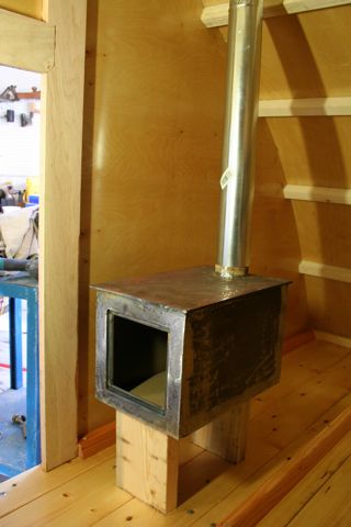

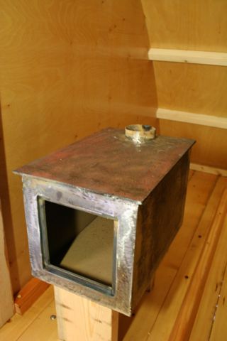

I welded the wood stove together this morning and placed it in the TD on 8" blocks. 8" seems to be what all the wall tent stoves use for elevation so I thought I would start there. The stove will actually be 2" higher due to the tile pad. Below are some pictures of the stove. The door is off because I am waiting for some parts. There will be a heat shield attached to the wall side of the stove and stainless steel on the wall.
As it sits right now there is 5" side clearence.

That firebox looks huge for the space it has to heat- as in way too big. What to you plan to use to insulate the floor from the heat?
No disrespect intended but that's larger than most tent stoves I've seen and they are designed for much larger spaces. I just can't help feeling that's a tragedy waiting to happen. :thumbdown: I hope I'm wrong.

Postby Cliffmeister2000 » Thu Dec 17, 2009 11:20 pm
It's not so much the size of the box, as the size of the fire.
That box is pretty big, though...

My thoughts exactly. To be that close to a wall, you need a metallic heat-shield attached to the wall with non-conductive insulators. This heat shield cannot touch the floor to allow heat to rise from the floor. Thru time, even if the heat isn't enough to ignite the wood, it will dry the wood until it reaches 'paper ignition' (451F).
That size isn't much smaller than the woodstove in my house; which will heat 2000 sq. ft. easily

Actually it is smaller than it appears. And it is about 10" shorter than my wall tent stove which is a small wall tent stove. The overall length is 14". This was dictated by wanting to have some useable cook surface plus an allowance for a 3" flue. It is also constructed out of 1/4" steel plate which is at least twice the thickness off wall tent stoves.
In regards to heat shields, as stated above, there will be a plate attached to the stove about 1 1/4 inches covering the entire side of the fire box on the wall side. There will also be a 1/8" 2' x 3' stainless plate mounted 3/4" off the side wall open at the top and bottom for air flow.
The stove it to be mounted 8" above a noncombutsable surface.
The fire box is "9 x 9" overall or 8 1/2 x 8 1/2 on the inside. I did have to bump this up a bit to have a useable door since the inside stop takes up an inch. The door is 5 1/2" square. The smallest air flow disk available is 3" If the unit proves to be too hot fire bricks are available to line the sides.
In regards to the size generally look at the Sardine which is 12" x 12" and look at the clearances used in Marine applications. If I recall correctly the Tiny Tot was about 8" diameter with the cook top kicking out to about 8" x 18"
Over the years I have installed several stoves in small spaces, mostly on boats. The general practice is to start slowly with small fires and do the hand test. The had test it to place your hand on any combustable surface and it you can't keep it there it is too hot. The thing is to install the heat shields in a way that generate air flow.

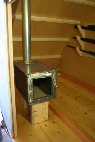

I got a little time this afternoon so I welded the heat shield to the wall side of the wood stove and painted it. I also built the platform for the stove and tiled it with slate tiles. Not exactly what I wanted but what I could get. I then installed the oak trim around the platform. The platform has twoo vents on either side to allow air flow so as to avoid over heating. In my wall tent I just put a piece of plywood under the stove and it never get too hot so I am not worried about heat on the platform. I also cut a bund of oak plugs and plugged the platform and book shelf screw holes.

I am mindful of the overheating potential but I will have a overhead hatch and the door can always be cracked too. In addition there will be a 6" porthole on the door and a 12" near my pillow so I think I got the airflow covered.
It is all fun.
I hope to have my tile grouted and the stainless heat shield installed today.
By the way, one thought I have if it proves to be too hot is to make a tray like an ice cube tray that wood or charcol can be piled up in and then place in the stove and ignited. This will keep the fire away from the sides like a fireplace grate.
