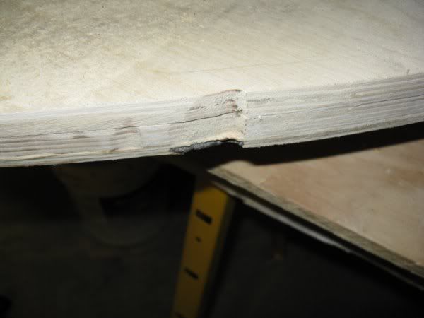

StPatrón wrote:I had a few problems with the router bit. Occasionally the bearing would freeze up and start to burn wood. I'm not sure what the cause was, but it was frustrating to have to stop and get the bearing rolling again. The bearing was HOT and touching it bare-handed wasn't good. A tender grip with needle-nosed vise grips and a shot of WD-40 worked to get it rolling again.
When it works, it works great!
Yep, I had a problem or two with one of my bits also. Either I was pushing the bit too hard or it was a cheap bit. Halfway through cutting my sides the bearing fell off and my bit went a little wild. Left a big dent in the hatch area. Fortunately, after a few choice words, I was able to sand it out with the belt sander. You can still see a slight dip where it was but it's one of those places that drives me crazy but no one else notices.

I think the bearing jamming was caused by debris that got into the area between the bearing and the cutting edges. When I plow thru some thick material, the depth adjustment on my Craftsman router will wander, always causing the bit to lower. I can see the ring rotate and will stop and readjust. That sm. amt. of lowering creates a thin shelf in the "target" wood,,, perfect for slipping into the gap under the bearing. It's an MCLS bit.
I'm pretty sure it was the router or bits fault and not my lack of skill :lol:
I can't imagine losing the entire bearing, that might cause a grown man to cry.

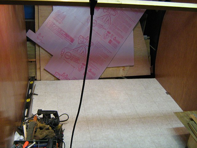

Today I belt-sanded the sidewall edges and then cleared the deck and stood them up, attaching temporary spars to hold everything in alignment. I was pleased with how it went and am comfortable with the current wall stability, not rock-solid now but expect that to improve once I add the bulkheads. I've been looking forward to this milestone for a long time!
This view is looking towards the front, 74.5" wide, and will be the location of the dinette/sleeper.
I'm still on the hunt for windows, will have to install those later. In the meantime I'll be building the dinette, closet, desk, and bathroom. Ought to keep me busy. I'm having a blast working on it!

Postby StPatron » Sun May 16, 2010 12:31 pm
BillZ wrote:Love your detailed pics of the building process! It is really helping me plan.
Thanks, BillZ. Due to shop space limitations my build steps are somewhat out of the normal sequence. For example, I wouldn't suggest putting both sidewalls up before adding the bulkheads. If I would've done that, I would've not been able to exit the trailer to access the rest of my shop. And, at this point the "sidewall-to-aft bulkhead" intersection doesn't exist, the galley sidewalls will be added later. It's a logic puzzle building in a confined area,,,, with some trade-offs involved. I call it "modular slouchy style". :lol:
