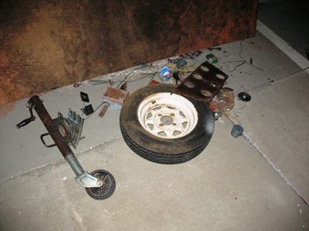

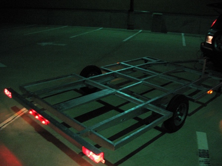

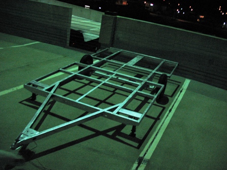

I started Saturday with the angle grinder. I ground and ground, finally removing hundreds of self-tapping screw heads. After they were all off, I was able to tear the deck off and smoothed the rest of the screw off. Underneath that, I kept grinding -- removing at least 10 brackets (that served no purpose), 2 taillights with completely destroyed casings, a random metal rack in the front, and a jack that was originally pirated off of a boat trailer. Lots of metal and smoothing.
Here's the pile of crap that I tore off:
I jacked the frame up onto the 3 stabilizer jacks (one of them was ripped off before I bought it), removed the wheels, and attacked the frame with a paint-stripping bit on the grinder, and several hours later had a clean frame.
Sunday, I painted. It turned out shiny. I had homework to do, so I called it quits.

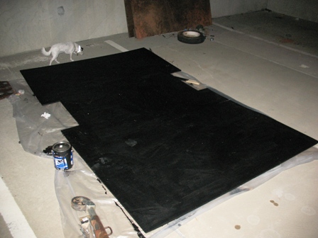

Monday, I took the tires off the rims and took them to the local Firestone to have them put on some good tires. The flooring was cut, then painted:
I was feeling incredibly productive (SUPERDAVE!) and did all the wiring too, since the paint was dry.
Pretty frame:
( ^image taken today, not Monday)

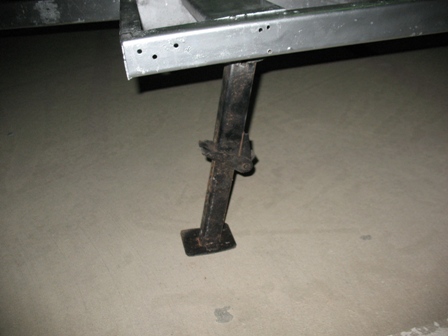

Today, I picked the wheels up, put them on, and cleaned up the mess. I also decided to remove the remaining stabilizer in the back (it doesn't really make sense to have a stabilizer on the left side, but not the right). I also took pictures for your viewing pleasure.
Stabilizer:

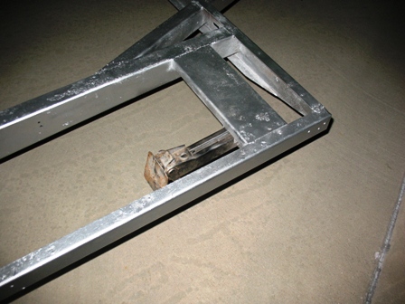

Folded:

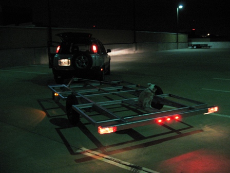

Looks like Maddie sneaked into the picture. See her?
Another angle of the trailer:
I guess Maddie got bored, she left.
Tow rig:

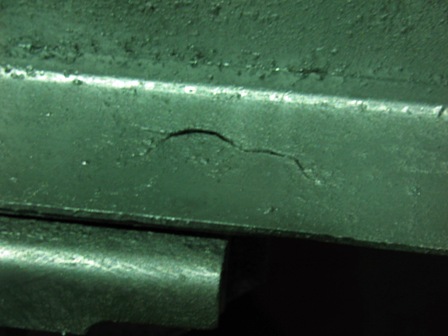

Tomorrow, I'll get the axle rewelded. It was mounted by idiots and is ripping the frame at one point:

down under tech wrote: I like the pic of the side view of Maddie sitting beside the trailer and your SUV. She looks to be saying, "Don't even think of steeling my dad's trailer". OK dave, Keep plugging along.
I wish "Much Luck" to you guys. The pics make all of us feel like we are right there with you. :campfire:
I think she's saying "Daaaave... put away that little toy and get this buggy on the road" :R
But dogs are too polite, they don't ever actually say anything.
I ain't no cheerleader but i'm still watchin' this show and rootin' for ya :thumbsup:

Postby synaps3 » Wed Mar 10, 2010 10:38 am
Johnny -- she's 80.75" wide, so I have to have the 3 middle markers. It's a big trailer. :)
Thanks for the etrailer tip. I found the stabilizer you were talking about: http://www.etrailer.com/Trailer-Jack/Domar/TJ01RT.html. I'll probably order one and put it in the back middle, once I have the budget for it.
Conestoga -- You must be quite fluent in dog! That's exactly what she's thinking. :lol:
It's also why she sits on the trailer. She is thinking "dad won't drive away without me, if I sit here. I want to go too!"
