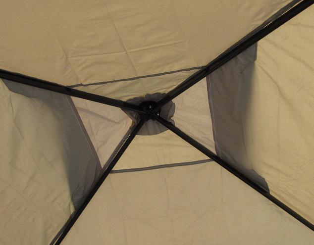

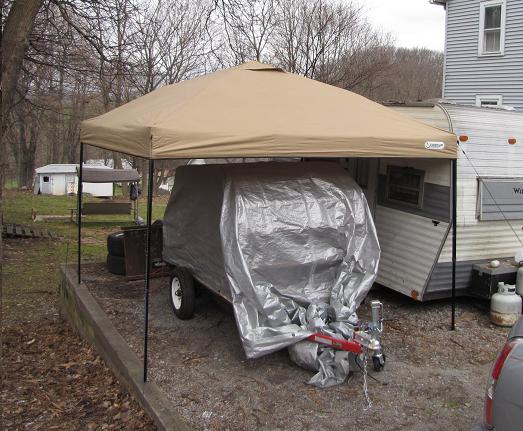

I just picked up this "First-Up" from Wally World for 97.00.
I don't know if you can see it in this picture, but the top is vented.
My tarp leaks, and we're expecting rain so I put it up over my build. The frame is heavy, and it feels like it will last for years if it isn't blown away. I have it well anchored on all four corners.

Tell you what Paul - Wallyworld camping gear is pretty inexpensive but it still seems to last a long while! I have tents from there that are probably going on 7 or 8 seasons with minimal wear! I'll probably be getting one of these First-ups too! Let me know how you like it in a few weeks!

One other side note on the First-Up. I had my son help, but it is doable with only one person, you just have to walk around it and stretch out the frame a little at a time. You would have to put it up where you want it though, I don't think one person could safely move it. I'd be afraid of the frame twisting if I tried to move it by myself.
As you can see, the tear can be easily moved under the canopy once it is up. The legs have three height adjustment, and I have mine set on the lowest setting, without running back outside, I think the other two are at 6 inch intervals. I'm 5'9" and at the lowest setting, I barely ducked to get under it.

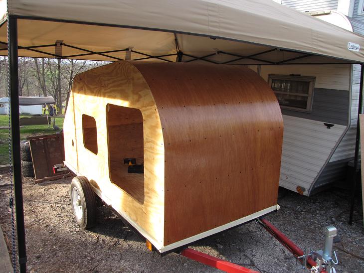

Postby parnold » Sat Apr 03, 2010 5:13 pm

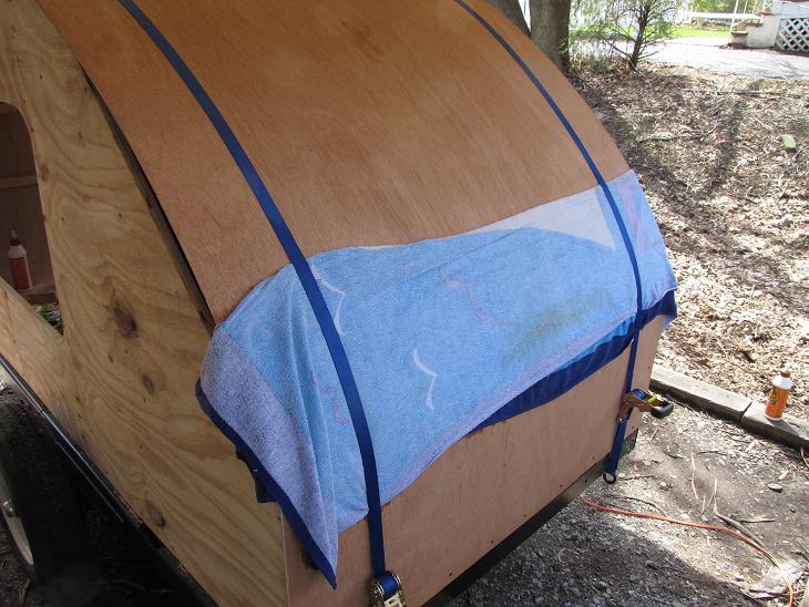

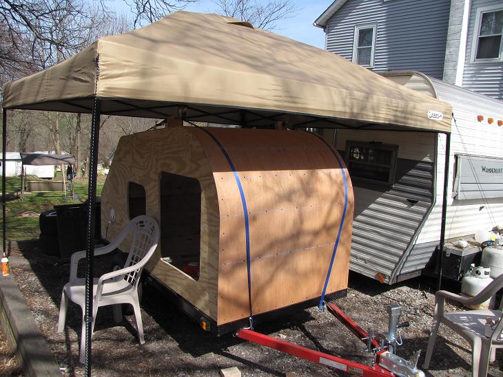

Today the weather was perfect, and I had a helper.. got quite a bit done.
Started putting the skin on.....

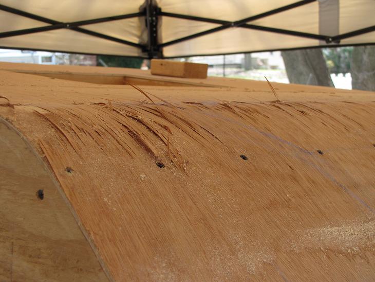

The front curve went very well, I had actually had the panel strapped all night long so it had a pre curve to it. I had a little more trouble with the back panel, since the radius was much smaller, had to use the old "hot" towel trick.
I had the same small radius above the hatch opening, so soaked the towel again...
Some of the very outer layer was damaged, but the panel did not split, I was able to sand this off and make it relatively smooth.

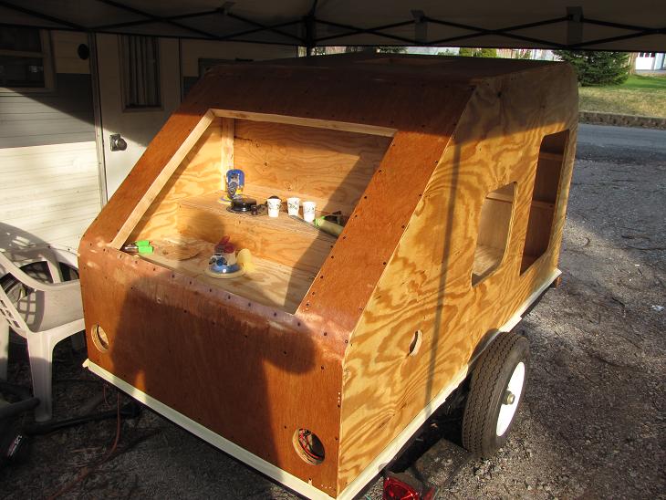

And the first coat of polyester resin applied.
the back view.....

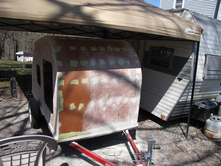

Tomorrow before Easter dinner I will get out the body filler and fill the screw holes and imperfections. I decided that the body filler would adhere better to the polyester resin than the wood. Then a light sanding and 2nd coat of resin. I almost wish I didn't have to go to the family gathering tomorrow.

Paul..that's looking great :thumbsup: I think on my next one instead of the cheap luan, I'll go with the subfloor luan, the kind with the pattern on the back. I believe its alittle thicker and better quality. :thinking: I have a few issues with some delaminating but I'll try to fix that. Moisture and luan just seems to cause problems. I can't wait to see those windows and hatch cover in!! :applause:

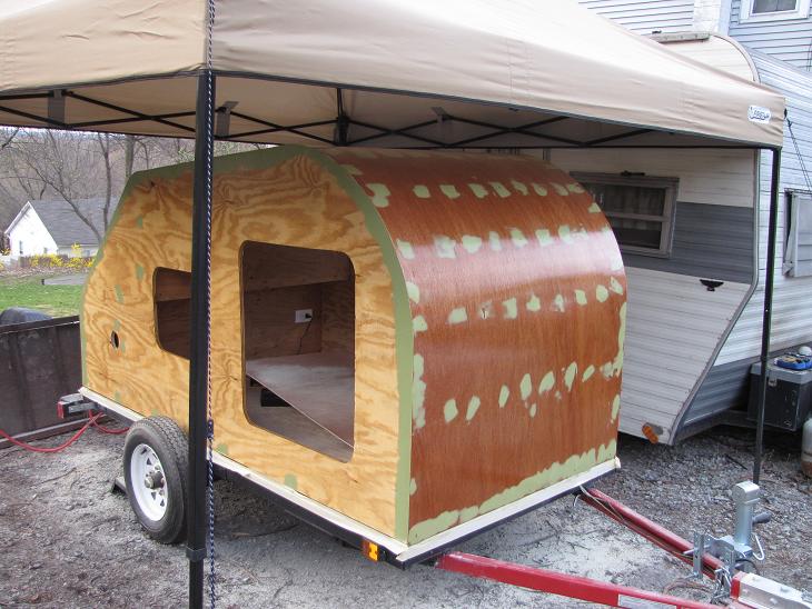

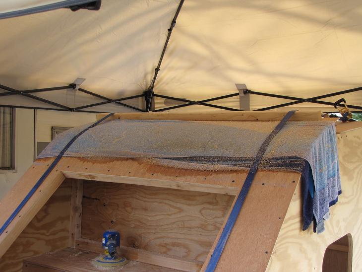

Postby parnold » Sun Apr 04, 2010 6:59 pm
I spent 7 hours today working on the tear, about 2 applying body filler to fill all the screw holes, 5 hours of sanding, sanding, sanding, sanding......
by the way.. sanding is not fun!
After the sanding about another hour putting on second coat of polyester resin. I'm using a 4" foam roller so it lays with a somewhat eggshell finish.
I will give the entire tear another light sanding, hopefully tomorrow, and one or two more coats of resin. The can says you can put it on up to 1/4" thick. That would be about 10 coats or more using a roller. It's taking me two batches of resin to do the whole trailer. The resin starts setting up before I can do the whole thing.
Luckily, I have a painters scale, so I'm able to measure the ratio (2%) with extreme accuracy.

Postby Ageless » Sun Apr 04, 2010 7:05 pm
Parnold; put the resin in the fridge. It will take longer to set-up
