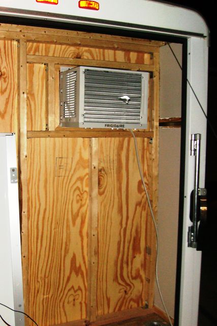

Postby Jeffmo63 » Sun May 01, 2011 8:25 pm
I installed the air conditioner bulkhead framing with a slight modification. 2 x 3 to save weight. 3/8 AC ply to be installed on inside.

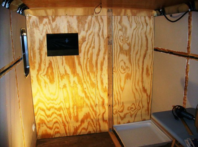

Postby Jeffmo63 » Sun May 08, 2011 9:57 pm
Here is a pic looking aft. Looks like the camera distorted some of the angles a bit. And that is the shower pan in the lower right.

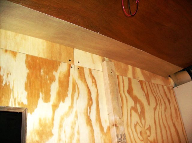

bulkhead/roof joint
Postby Jeffmo63 » Sun May 08, 2011 10:00 pm
The bulkhead and roof joint was challenging to cut and fit, but I think it turned out better than I could have hoped.

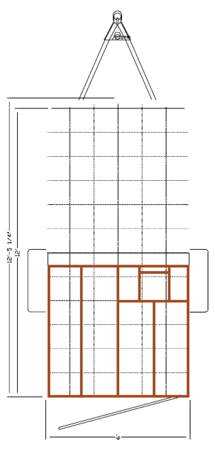

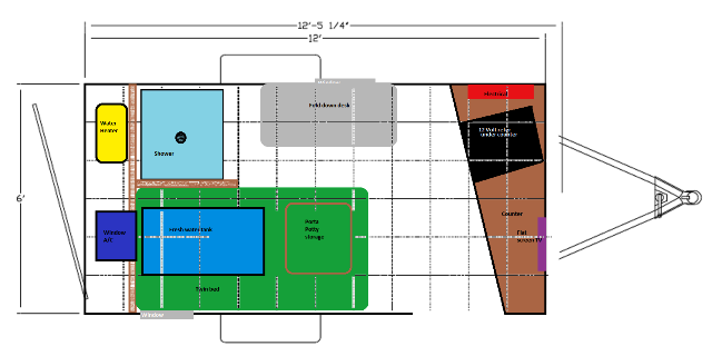

Postby StandUpGuy » Sun May 08, 2011 10:06 pm
I see a shower pan going in your conversion. do you have a drawing of your interior layout?

Postby Jeffmo63 » Mon May 09, 2011 12:40 pm
StandUpGuy wrote:I see a shower pan going in your conversion. do you have a drawing of your interior layout?
Sure, be happy to share it.

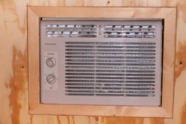

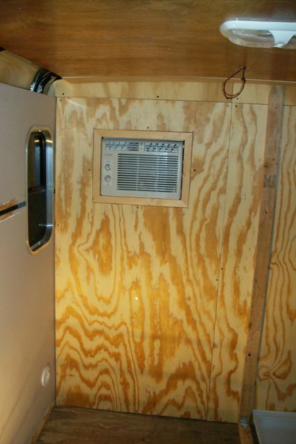

Postby Jeffmo63 » Thu May 12, 2011 9:00 pm
I installed a 5K BTU AC in the bulkhead after some re-framing.

Postby aggie79 » Thu May 12, 2011 9:25 pm
:applause: :thumbsup: :applause:
Very nice job on the A/C installation as well as the rest of your cargo trailer conversion.
Postby Jeffmo63 » Thu May 12, 2011 9:28 pm
aggie79 wrote::applause: :thumbsup: :applause:
Thanks Tom, I'm just taking it one project at a time and hoping for the best.

Postby StandUpGuy » Thu May 12, 2011 9:29 pm
I have to agree with Aggie, it is coming along nicely. Is that an angled countertop in your plan?
StandUpGuy
Posts: 1090
Images: 52
Joined: Sun Mar 27, 2011 6:15 pm
Postby Jeffmo63 » Fri May 13, 2011 7:05 am
StandUpGuy wrote:I have to agree with Aggie, it is coming along nicely. Is that an angled countertop in your plan?
Yes it is. The text didn't come out too well in the drawing. More than likely it will be some 1/2 ply with a formica covering. There is a 12v Norcold refer/freezer already installed but the counter itself is not. A 12v flatscreen TV/DVD is in the works for the front bulkhead although I'm not sure if that luxury is neccesary. Thanks for all the kind comments.
