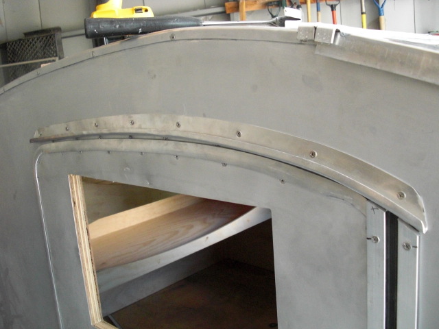

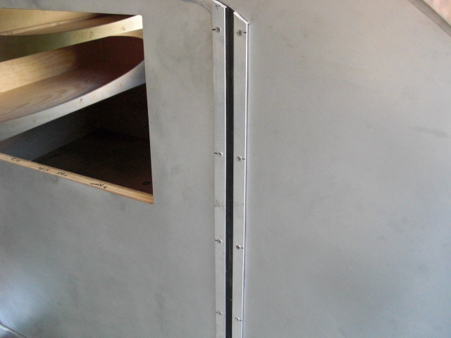

I put the plastic hinges on yesterday. They work really good.
I was going to put up a wider aluminum rain drip edge, but I did not like how it looked against the trailer.
[img][img]http://www.tnttt.com/gallery/image.php?image_id=69244[/img]
So I took some leftover .032 aluminum. Cut a couple of 1 3/4" strips 36" long, and clamped it between 2 radius-ed pieces of 3/8" ply. And lightly hammered away to form a j channel. I then heated up the aluminum and bent it around a curved piece of ply to get the curve I needed above the door.

I got a 50ft coil of plastic hinge from Monroe engineering
http://www.monroeengineering.com/hinges ... -hinge.htm
It is a snap to install. I put some 1/8" x 1" aluminum flat bar on top marked some holes and drilled and countersink 3/16" holes on 6" centers.

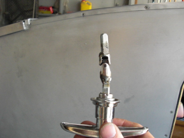

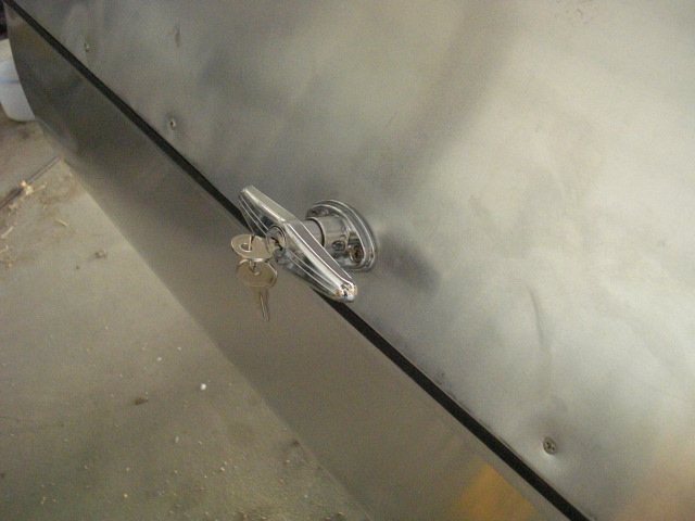

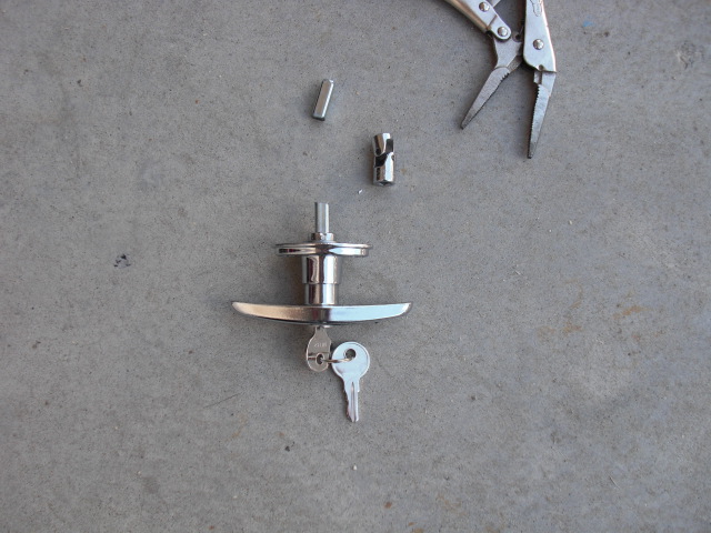

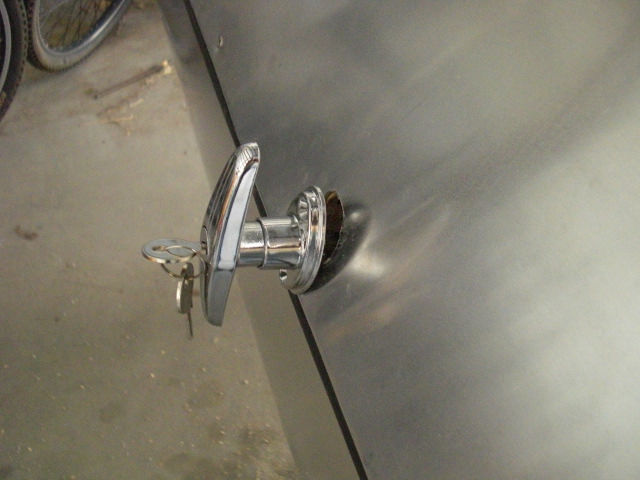

I did a boo, boo, on my rear hatch handle. I put it to close to the bottom edge. Which resulted in a large angle offset. I had drilled the hole already, so I was committed to putting the handle in that area.
So I figured out how to fix my problem. I cut off part of the shaft to the handle and added a small flex shaft that I never use. And welded it to the handle shaft.
[img]
That took care of the problem. No gaps.

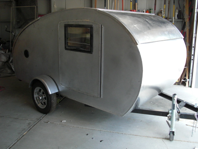

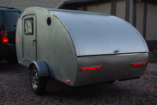

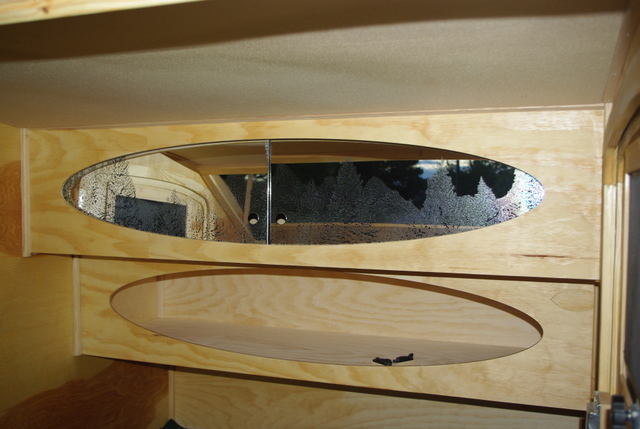

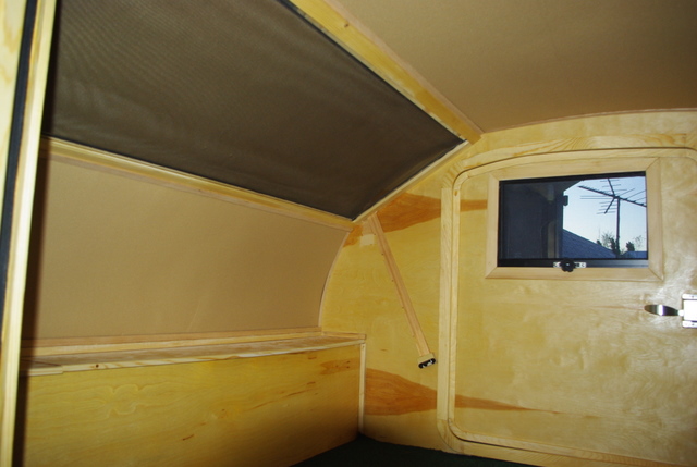

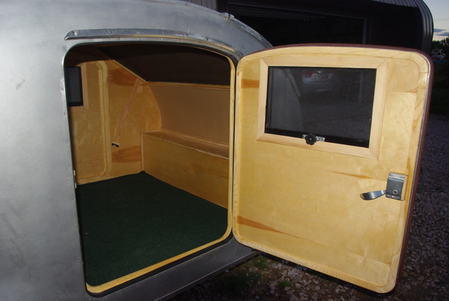

I got most of the finish work done today. The head liner is in. I got the L.E.D. trailer lights connected, and put in a acrylic mirror with a mountain scene engraving. At this point the trailer is about done.

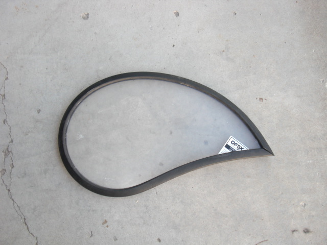

The maiden voyage will be Yellowstone Park. I have wanted to go to canyon village by Yellowstone falls for quite some time. As for how long it took to build. I started on July 6th, with the first cuts into some plywood. for a total of 24 working days. I have also started working on some new windows for #2. It is a Lexan window that's a 1/4" thick that fits into a window gasket and will fit into a plywood cutout in the side wall of the trailer.
