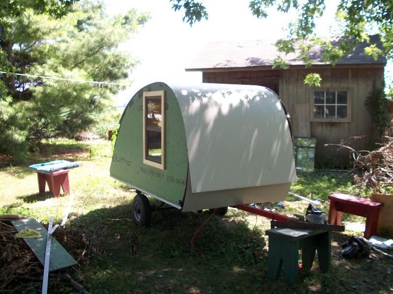

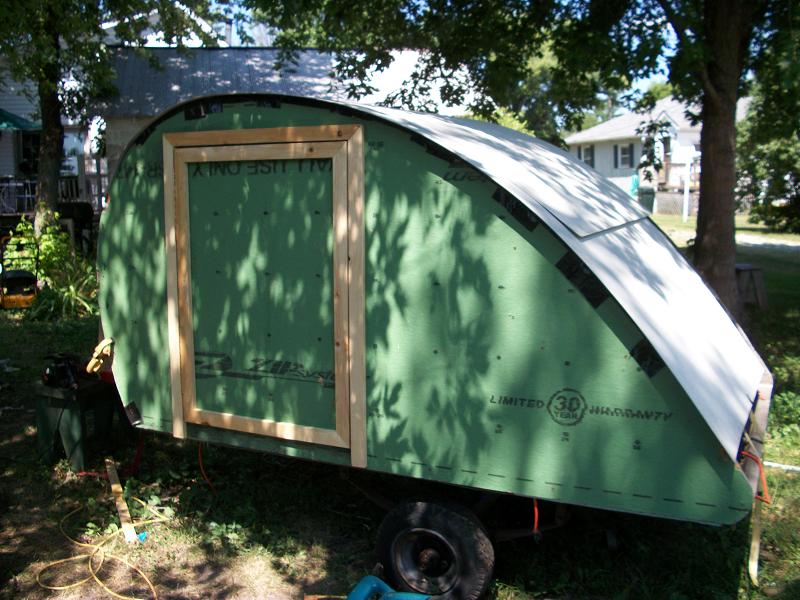

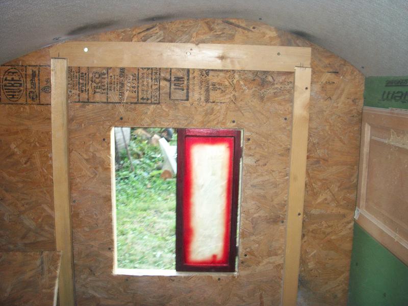

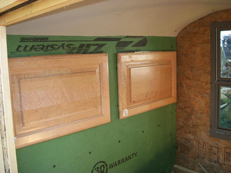

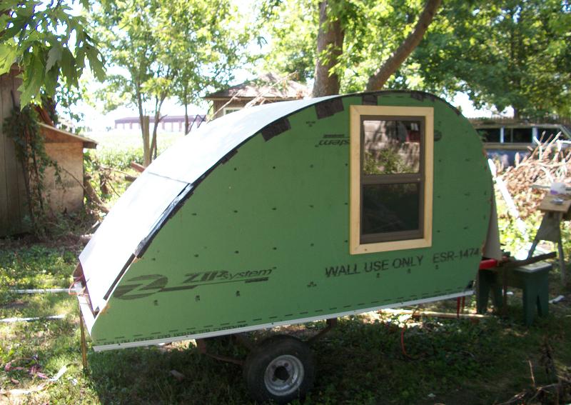

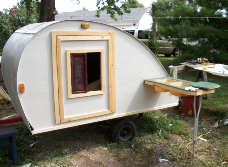

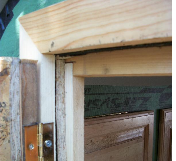

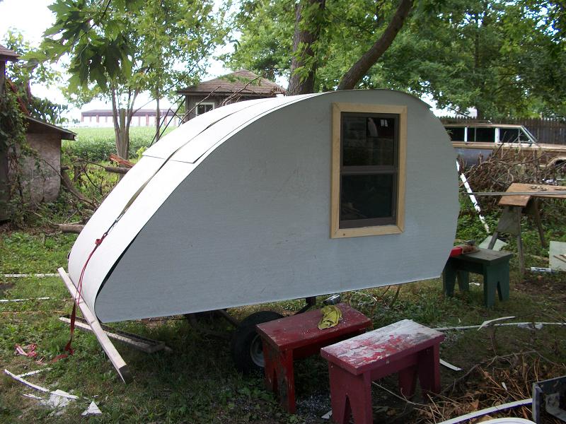

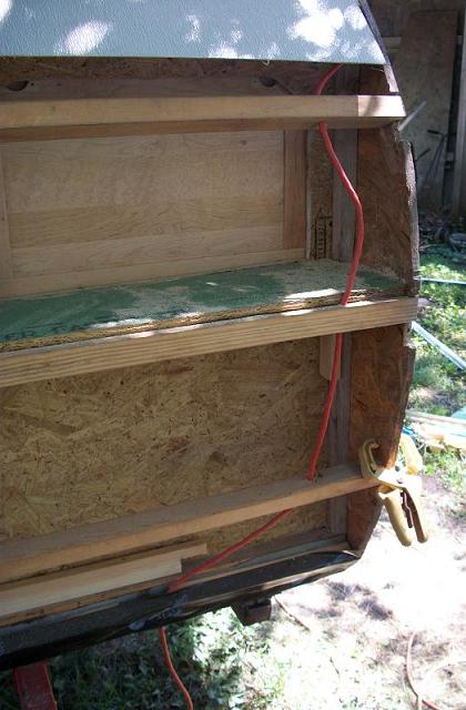

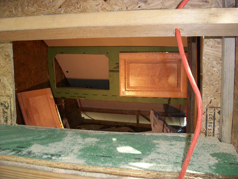

Sat AM got started about 8:00 AM put on the final cabinet door and remover the temporary FRP roof. Cut in for the window and temporarily installed it. Cut the halo trim to install around the window and tacked it into place to check fit. Turned my attention to trimming out the door inside and out. It took a bit of doing as the plywood cut out was not square and 45 degree cuts do not work on a parallagram. Trimmed the opening a bit wider and trimmed the inside square and full with a 3/4 +/- door stop reveal. The outside trim was trimmed even with the opening where possible but square was of greater importance. Once the outer halo was screwed temporarily in place the inner door was fit and trimmed to fit inside the outer halo with 3/16 spacing for clearance. The portions of the piano hinge left from the cabinet install was cut in half and installed top and bottom of door. Put a quick drying coat of acrylic poly on the wood to seal it somewhat as an evening shower was predicted. I replaced the temporary roof and picked up my toys just before the rain moved in.

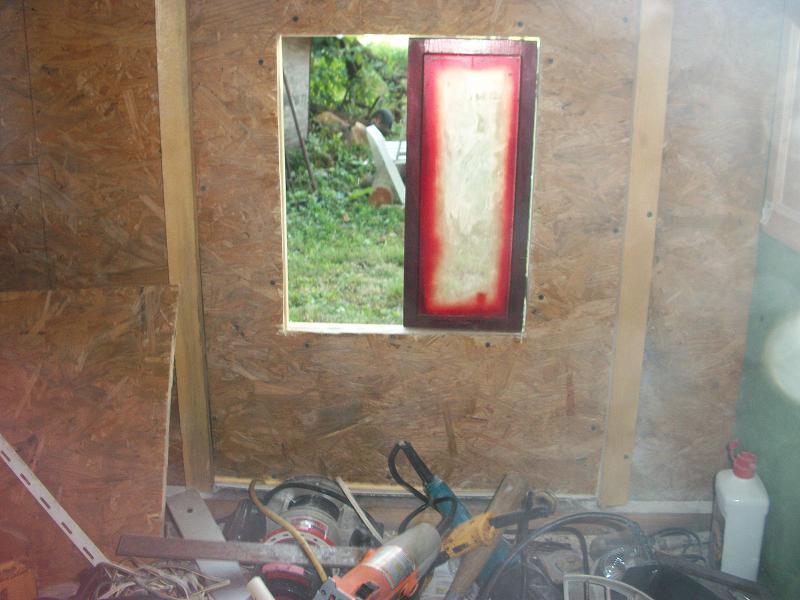

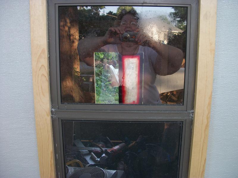

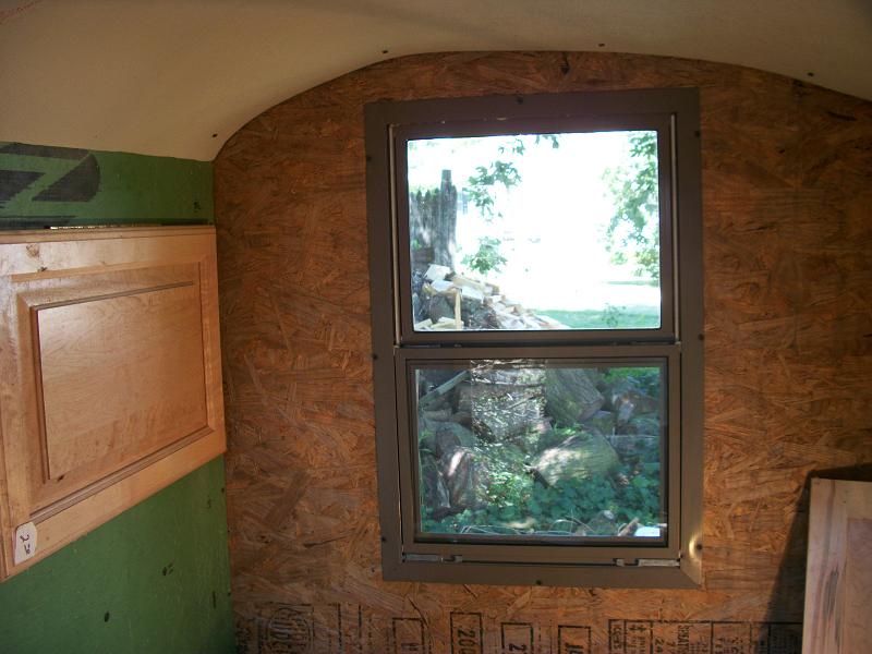

Sunday morning I removed the window trim again and installed the cove plastic on the very bottom edge of the right side wall and slid the frp that was again removed from the roof into the now screwed on edge trim. I taped and braced the FRP from the outside and went in and removed all the window panes and screwed thru the corners of the now empty sash to locate the opening. I had to add 3/4 inch to each of the 4 sides to fit the window properly so back outside I added the 3/4 and using a 4" grinder carefully cut the opening. A little grinding and a great fit was made. I filled the voids between the osb and the aluminum window frame with 100% silicon caulk and then carefully reinstalled the window trim to hold the FRP in place. Grabbed the router and a flush cutting bit and cut the waste from the 4x9 sheet of FRP to now fit the wall.

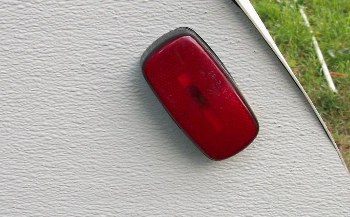

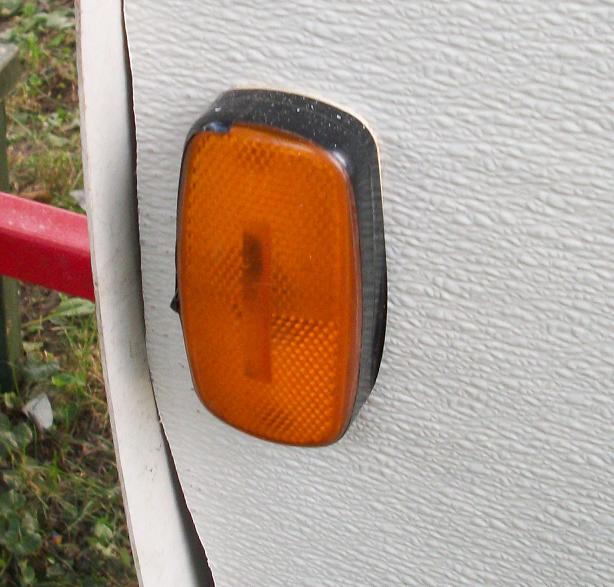

doors framed in and side marker lights are on
my polish power port.
red rear clearance lite

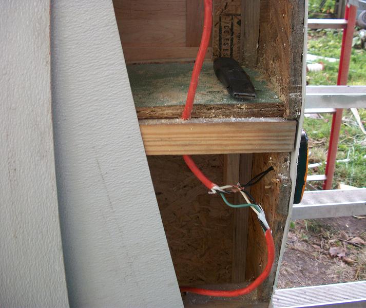

taping into the extention cord for the side markers
the front clearance lite

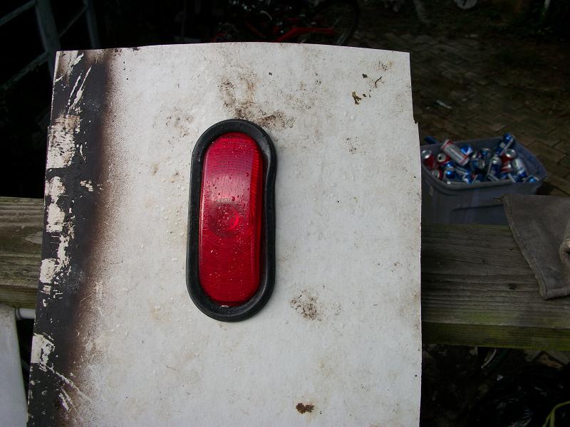

test fitted the tail lites into a scrap of frp

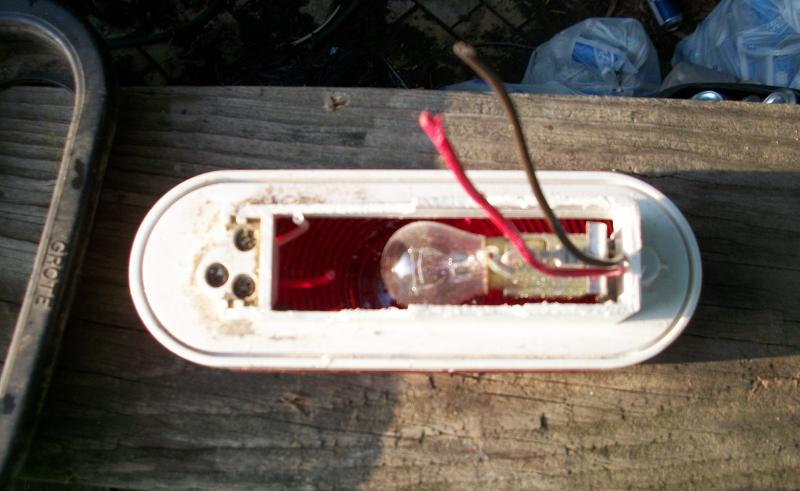

tail light fit rear ( yep found this one at goodwill )
ever wonder what to do with a burned out sealed tail light? Take your toy grinder and cut out the back and install a new 1157 bulb and if you don't have the handy dandy plug just cut the wires and splice on.

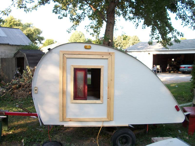

tried my hand at some home made mini casement windows to be installed in the door.

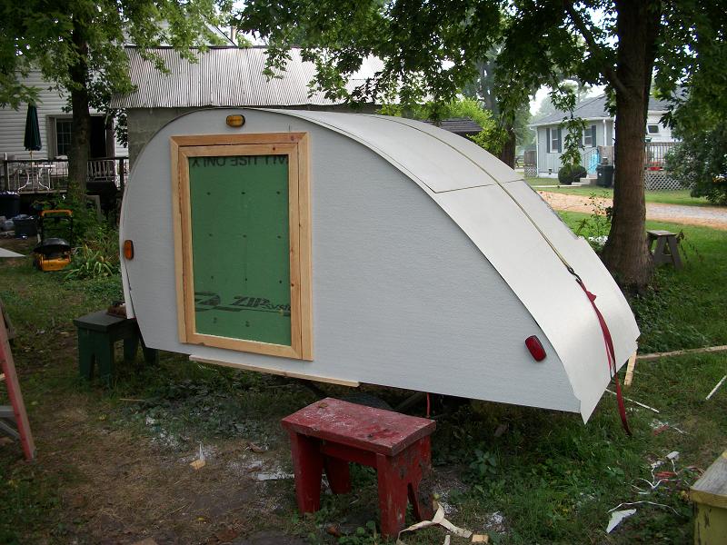

All in all a good weekends worth of work Had to remove all the driverside trim and door to install the FRP. Installed the 4x9 sheet and cut out the door opening. Then reinstalled the door trim and the door. Router cut the 4x9 sheet to the side profile with the router. Used eye protection this week didn't want another eye problem like 2 weeks ago. I drilled and mounted the clearance lites and wired and soldered all the joints and taped up well to avoid any problems down the road. All 6 marker lights and both tails were finally tested and all work as planned :thumbsup:
I cut out the door center for my little tiny home made casement windows. But for lack of some small hinges they would have been installed. The window halo trim is installed and the entire nose FRP is now in place, lacking only an aluminum strip at the bottom to cap it closed. Mother nature teased me into quitting early with a little shower that lasted about 5 minutes longer than it did for me to pick up my toys and put the extra material on top of the trailer to protect it from the rain. :x

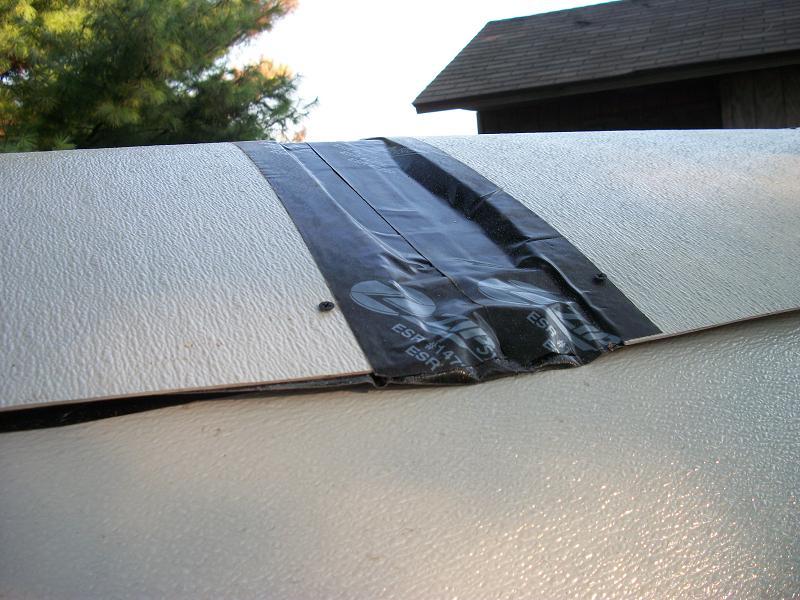

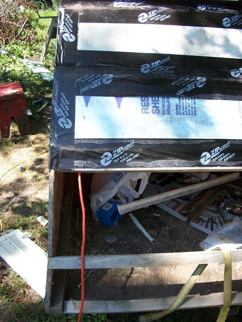

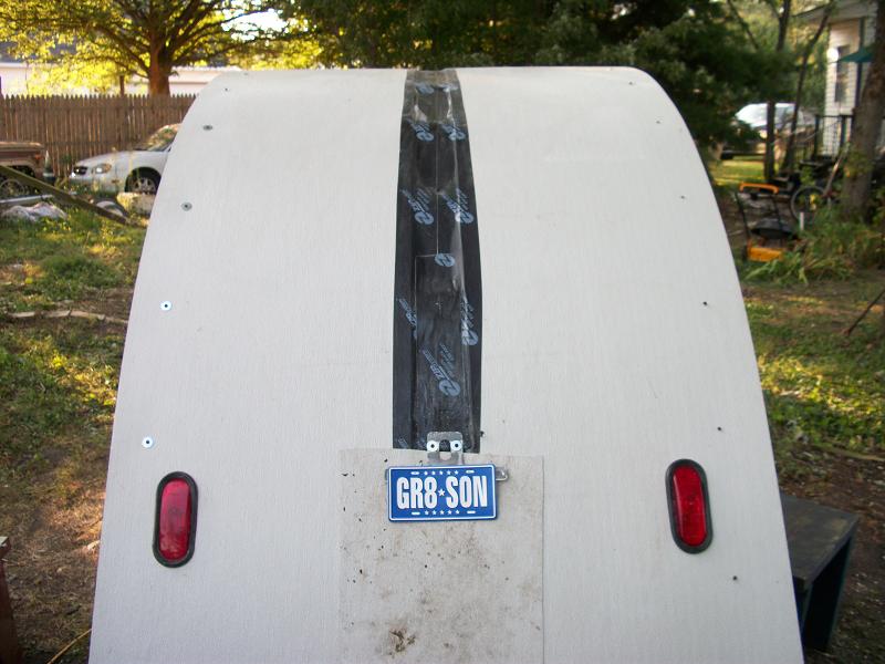

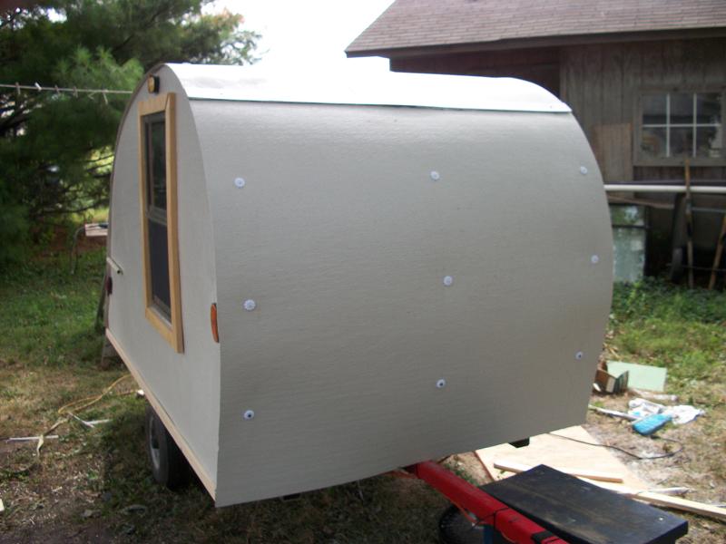

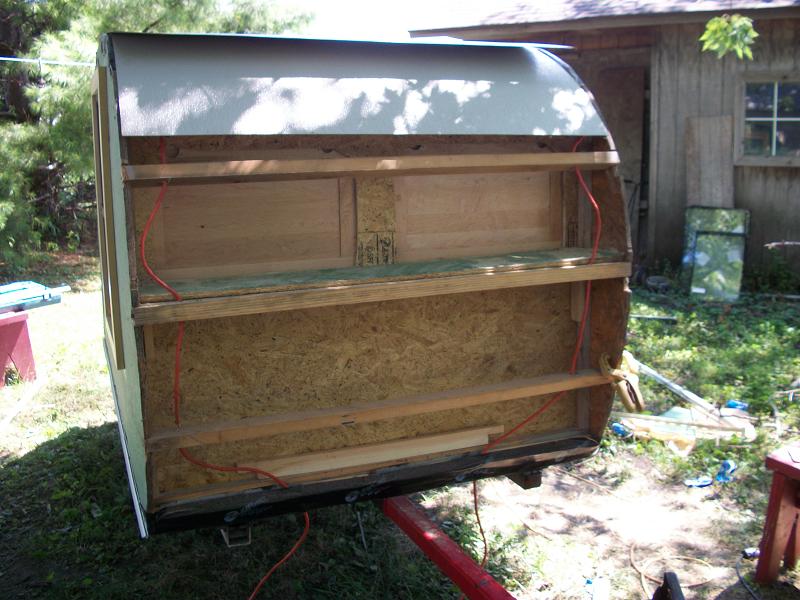

Well I felt guilty so Tues evening I ripped the 4x9 sheet down the middle and installed it on the final uncovered portion of the roof. After the FRP was screwed into place at each spar 3" in from the outside edge I ice dam taped the centers uncovered 5" ( Oh did I mention my 4' wide trailer some how grew to 4'5" including a 3/4 overhand on each side) :oops:
I will have to purchase one more piece of FRP to cut the center 10" strip to cover the void and the roof is done. It is weathered in now so I feel better with the rain coming in later this week.
The tail lights were nervously cut into the FRP roof at the rear and I only made one tiny boo-boo that a spot of white silicone will fix easily. I also installed a license plate holder I found floating around in the garage. I still need a license plate light and to install a 4 way flat on the end of the wires already ran, then the running lites are done. I am ready for a road trip. I may have to drag out the Goldwing and see what happens this Saturday.

The ice dam tape is a good detail. You almost wonder why the trailer manufacturers don't use the stuff. My TD is held to the frame with trailer deck screws through the floor into the steel tubing. I used the same stuff - actually window flashing but made of the same material as ice dam tape - applied to the top side of my frame. The good thing about this stuff is that you can penetrate with fasteners and it seals all around it.

license plate mount ( the dirty piece is just a temporary rain deflector. The rear is not fully screwed down so I can finish wireing the license plate light that I need to purchase yet.
here are my recycled tail lights now installed.

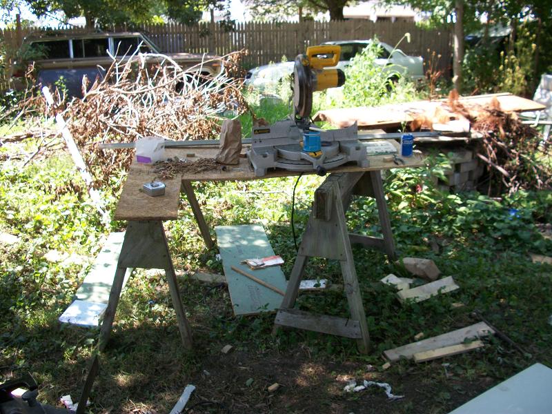

Here is the shot she was trying for my rolling tool storage shed
a close up of the toys
here is the passenger side to date
and the drivers side to date.

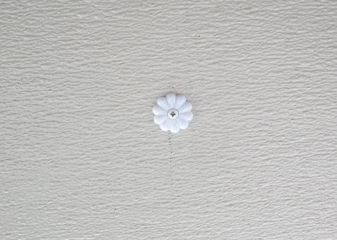

A closeup of the rosettes
