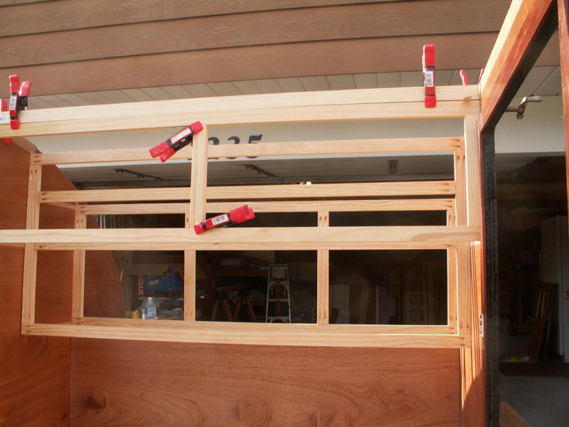

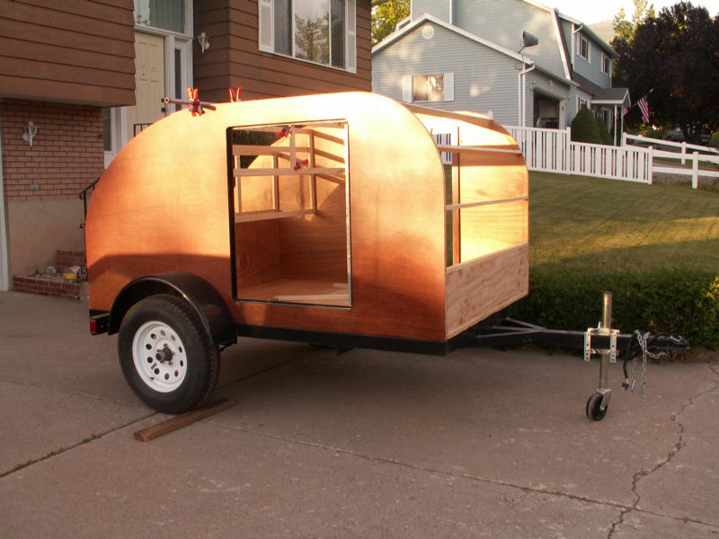

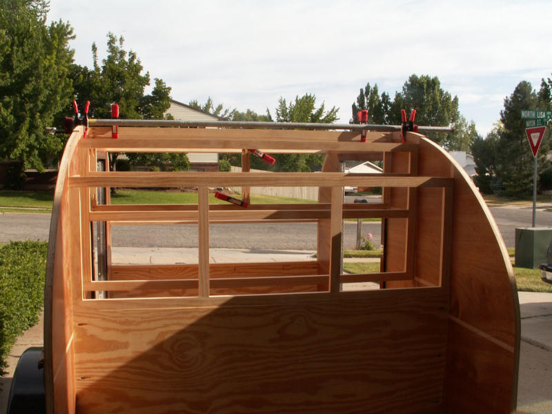

Busy weekend.
The cab is finally on the frame
Started roughing out the cabinets and figuring out doors and such.

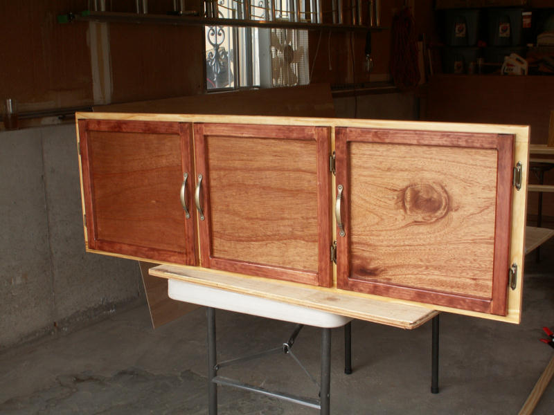

We've been working on the cabinets and not surprisingly it's been going a little slower than expected. I've been told that I (Steve) need to stop being so picky. Ok I'm working on that and trying to convince myself that the little flaws will add character and charm. I guess we'll see how that goes. :D
After a few hiccups, the front and upper rear cabinets are framed, varnished and have had the hardware test fitted. Hoping to get them installed tomorrow.
Upper Rear Cabinet
Front Cabinet

Nice cabinets. I'm guessing maple face frames with no stain; Gun Stock red stain over maple, pine, or poplar door frames, and same stain over luan, okoume, sepiel, etc panels?
Looks great. Between yours and Plan-B I'am thinking I might just do my whole interior in the Gun Stock, but leave the face frames and inner door seal frames in the clear white maple for that nice contrast.
Nice! :thumbsup:
Re: Steve & Cynthia's Teardrop
Postby PSBreen » Fri Jul 06, 2012 12:49 pm
The cabinet & door frames are 1" x 2" Radiata Select Pine. The door frames are stained with Red Chestnut then varnished. The centers of the doors are 1/8" luan ply. The cabinet frames & door centers are varnished without stain. We are working on a budget, so going with some of the lower cost alternatives. We have been very surprised by how nice some of them look after a little stain or varnish.

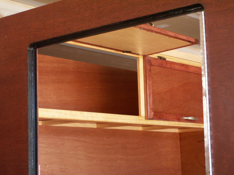

It looks like you changed your original plan by making the cabinet on the inside come all the way to the door frame. I like that and might use that in my Benroy. Cabinets look great. How exciting!!! :applause:
cop1406
Posts: 63
Images: 14
Joined: Fri Apr 27, 2012 1:03 am
Postby PSBreen » Fri Jul 06, 2012 8:21 pm
We were a little worried about interior space and banging into a cabinet closer to the door. After we got the sides up and started looking at it we decided it wasn't going to be a problem so we added a 12" x 12" x 58" cabinet. That one will be pretty much clothes and such. It should be real handy.

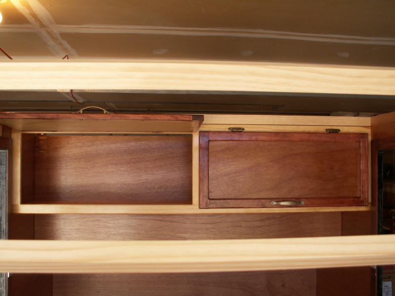

Yipee !!! The cabinets are done. The inside cabinet is completely installed. We are waiting on the varnish to dry on the top and bottom of the cabinet to dry.
Inside.
P.S. I'll add pics of the rear cabinet as soon as I can.
