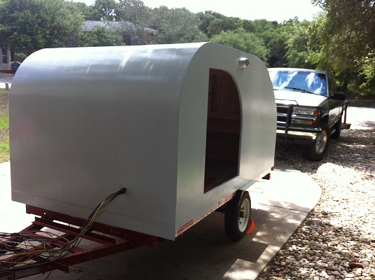

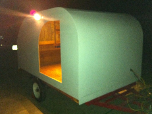

Insanity of a weekend, non stop working on our trailer.
Here we go...

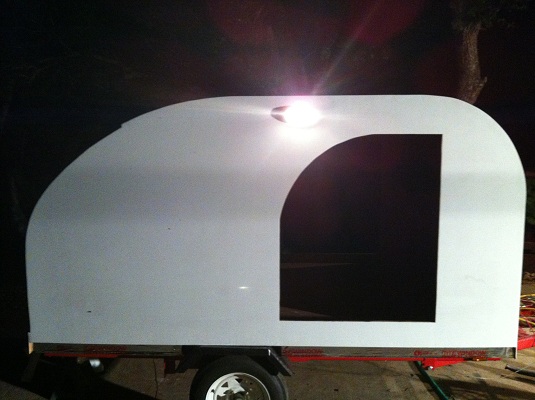

Friday night, my wife put the first full coat of white while I was working the drill press on all of the trim.
Saturday through lunch: second coat of paint, trimmed doors and galley openings, trimmed and installed doors

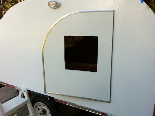

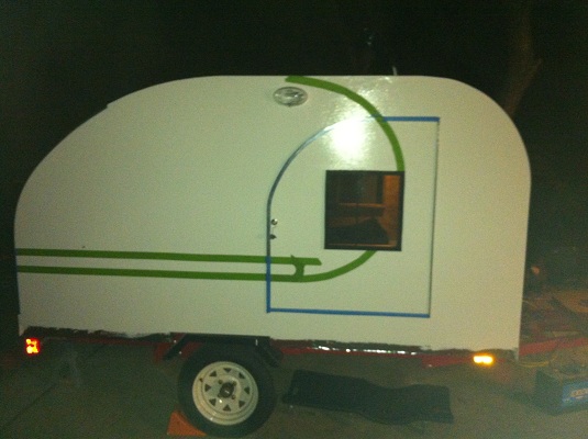

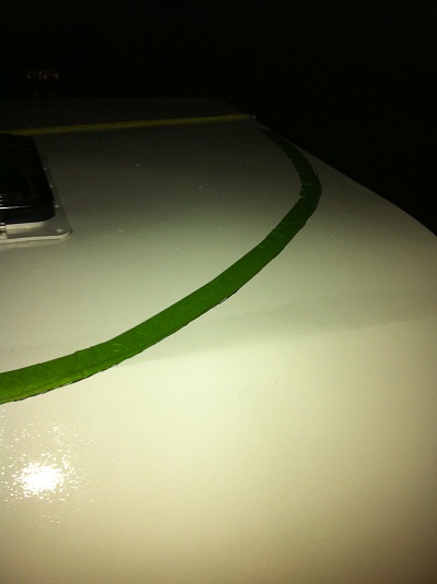

Saturday afternoon and evening

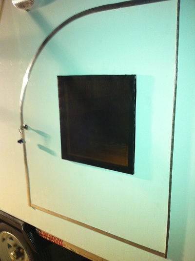

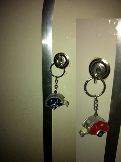

Door locks installed (these are our latches for now - I went to the local hardware store and picked up three 'keyed alike' locks (each door and the hatch will match). His and hers key chains for fun. :)
My 3/4" hole saw kept losing the center bit so we have some touch up work to do on these.
Window frames, painted, dried and screened by my wife.

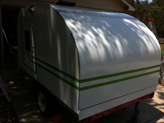

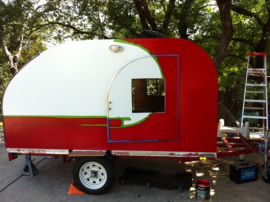

The paint tape..... First, I did horrible, horrible things to our fresh white paint with a sharpie to get the roof half circle done. Notice that the fan is installed now (YEAH!!! It works great!), and that meant I had to run my fishing string compass over it, while on a ladder, while leaning over the roof. It's not pretty with all the compass corrections, but the circle ended up looking good, I just need to figure out how to carefully sand and repaint where I got out of control with the marker. Learned my lesson on the sides and just used a pointed tip to lightly score the white paint which is much easier to touch up.
We used the green frog tape really stopping the rush here and pushing down all the edges, making sure trim was covered etc, and the lines still bled, but it looks likely that a small pinstripe will hide most everything on that.

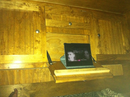

We installed the strap hangers for the lower interior cabinet door and called it a night.... Yes, at this point we slept in our driveway, in the teardrop, with the three of us. It slept great with plenty of room still for our little one between us, although I imagine we'll be looking for trailer room extensions soon with as fast as he's growing. Big milestone!!

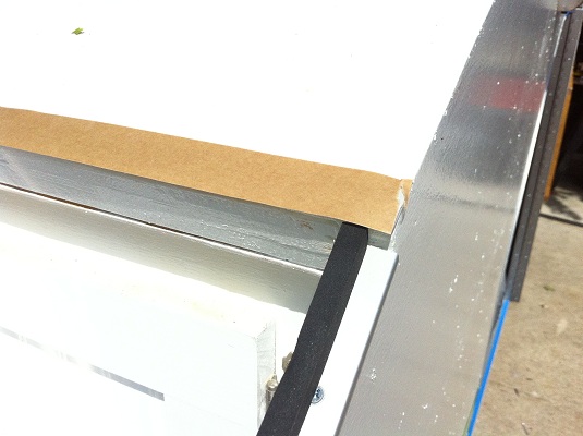

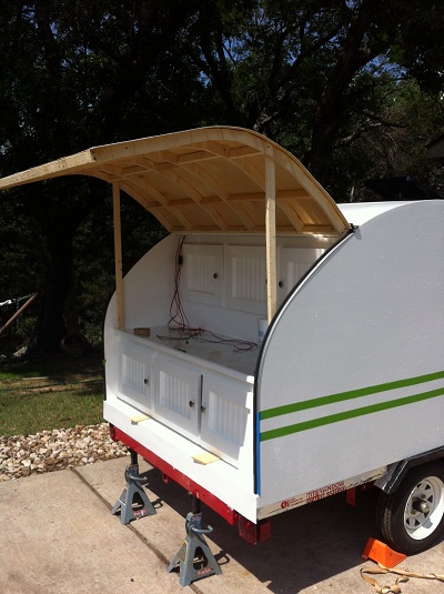

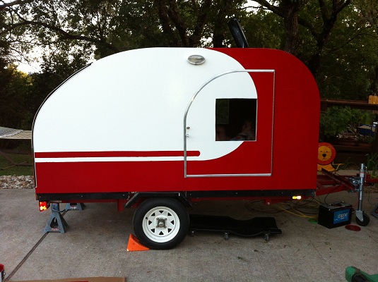

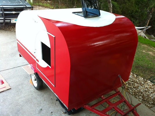

Sunday morning.

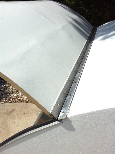

Used butyl taped, the harsh environment plastic hinge and some 1"x1/8" aluminum (pre-drilled Friday night) to install the hatch, and then finished the taping for the red paint prep. You can also see here where I relocated the stocker HF brake lights, drilled new lower and further back mounting points then installed and re-wired to the new location.
First coat of red!

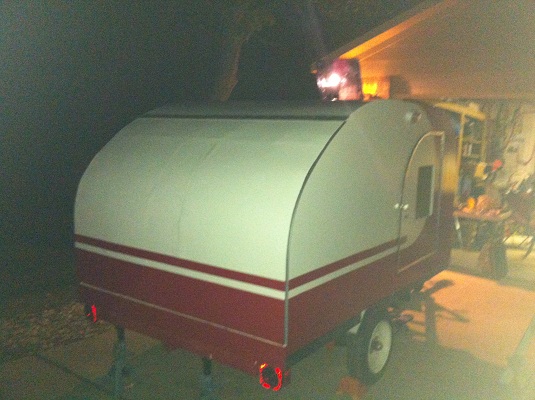

Postby txcamper » Mon May 21, 2012 9:23 am

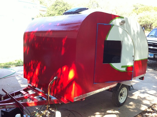

Second coat of red went on, and then after a little dry time the tape was removed!
Not shown: Pre-drilled and added rubber grommets to tool box for wiring, cut cabinet shelves, trailer wiring is almost done, just need to connect the ones running through the roof so I can install my license plate on the hatch. I started on my telescoping roof rack for the 'changing room'. Going really simple on this one, just to give us an option to hang a couple shower curtains on it for room to stand and change.

Postby txcamper » Mon May 21, 2012 10:04 am
Thanks Paul, Tractor and implement paint from tractor supply. Roller application. We were well under the manufacturer recommended dry time, but waited until we could stick and peal tape to it without damage before moving to the next coat. The roller had benefits and weaknesses: benefits - easier to control than a sprayer, a lot cleaner application in the driveway, and the ability to load it up and do a heavy consistent coat; weaknesses - roller lint mostly.

Postby txcamper » Tue May 22, 2012 9:12 am
Thank you all for the incredibly kind comments!

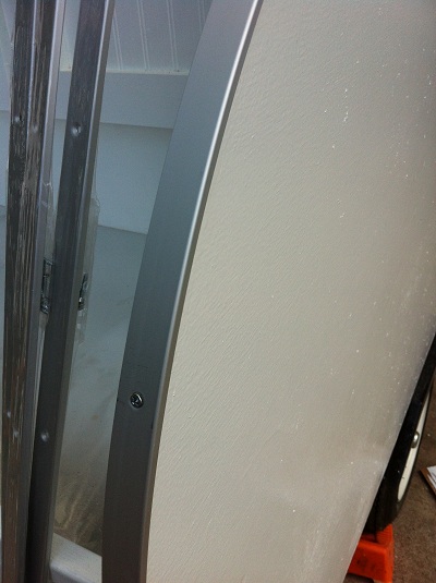

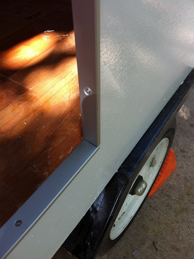

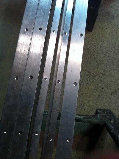

The trim was mostly from Amazon.com (ace hardware outlet through Amazon specifically). It is aluminum counter edge molding and left maybe a 16th of an overhang to the inside past the 3/4" ply walls. That little over hang was perfect because it means my locks are resting on metal inside and not the wood wall. The rest is 1/8" x 1" aluminum you can get from the local hardware store drilled every 3.5" and counter sunk. The T molding for the doors came from vintage technologies because they had the plastic hatch hinge for $16 and I figured just get the T and the porch lights at the same time. I did the same treatment to the T on the drill press of drilling once every 3.5" and countersinking a little with a slightly larger bit.
The paint scheme was inspired by the search engine image search of 'teardrop trailer profile' and then taking the pieces we liked and then reduced those down to something we could easily duplicate on both sides. The roof half circle was first and went wall to wall to give me a starting point on the wall half circles. My fishing line compass was reduced own to 18" to make it a little smaller than the 4' tall wall and started where the roof design ended. The extra stripe is 2" tall exactly one piece of tape from the bottom stripe. :)
