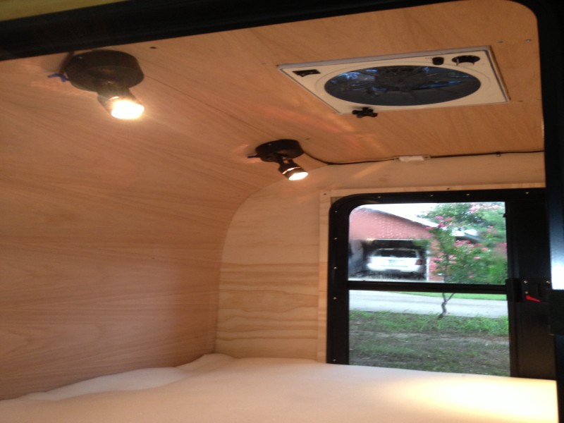

I finished out the cabin and it looks nice. The bar is in place and has a border making it road ready. I also have a border on top of the A/C to hold DVD and whatever else. I realized that the doors, once installed, should have blinds that descend from the ceiling. This will create the minimum footprint while allowing them to be drawn halfway to allow air flow when the window is open. I will hide the fixture behind some crown molding.
I will use some molding to create my runners for the hatch on the exterior. That will add a nice look going down the road.

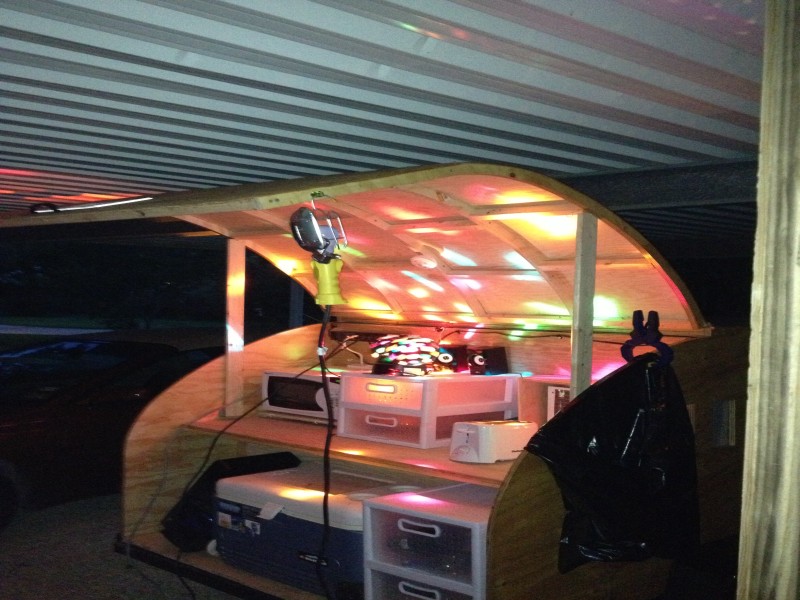

7/27/13
I spent my first night in the trailer. Very comfortable. The only issue is when I turn over in my sleep. The shelf is exactly at knee height and I bang it. I started the evening with the A/C, but after a couple of hours I switch over to the fan. That was much better. It was quieter and maintained a nice cabin temperature. I need to add some coat hooks to hang shirts/coats.

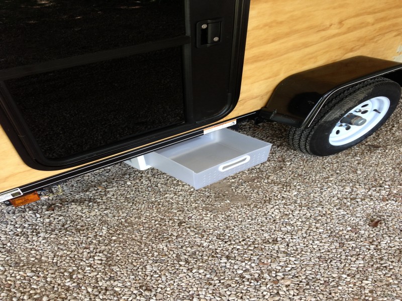

I’m going to screw plastic drawers underneath to hold shoes. I put my boots in there and they fit fine.
I should probably create a check list for departure before leaving the camp site. It should include the jacks, all the draw strings, tables, etc.
The mattress is very tight which is good. That will hold any sheets I put on there. There is plenty of shelf space to put the phone, wallet, etc.
I cooked dinner and breakfast in the galley. I just took whatever I needed from the kitchen in the house and then kept it in the trailer. Now I have everything I need.
I need to secure the speakers to get them out of the way. I might actually add another table top just to make it easy. You would be surprised how quickly you room out of room. I need to get the drawers situated so that it all works.
I hooked up the disco maze light and it worked like a champ. I have a place to clip the trash bag that works really well. I use an auto light for the galley which is perfect. I can move it where I need it, including around the trailer as it has a long cord. The bottles from the bar fit nicely on top of the A/C unit making a nice rear bar. The music was more than enough for any camp ground.
It all folds up quickly for going down the road. I added a big steel bowl for cleaning dishes. It fits on top of the ice chest going down the road.

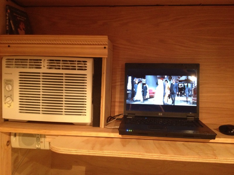

7/28/13

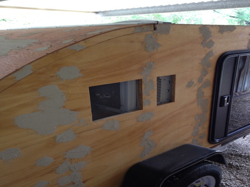

I cut the hole for the A/C bigger. I made it as big as I possibly could. And I replaced the decorative screen which was a little restrictive with regular screen door screen to help air flow.
Now the A/C works fine with the hatch closed. The galley does not heat up at all. I put a plastic lid underneath and it reduced the leak, but it is still there. I triple coated the area with Thompson’s, so I should be covered. I will cut the plastic box, make it deeper and try again.
I put wood putty over all the blemishes on the outside. I need to do my first sanding to see how it looks. I also need to practice with the fiberglass. I will put that over the seams and sand it out. Then it is off to gasket land. I think I will do a primer. There will be several colors underneath with the fiberglass and plastic wood. The primer will cover all that.

I spent about an hour last night sanding the trailer with heavy grit knocking off the liquid wood I used Sunday over the pits and swirls. I was able to do half the trailer in that time. The hatch had the ugly side out, so that took a lot of sanding. The bottom line is I can sand the entire thing in less than 6 hours.

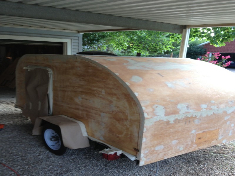

I worked with fiberglass for the first time this weekend. Messy, sticky, nasty. It starts getting on your gloves and then things stick to your gloves. It’s a real pain. Roof tar and fiberglass equals no fun.
I did the strip on the roof. I poured 2 inches to each side of the seam. I’m sure it won’t leak. Now I need to sand it and see if I can make it look good.
I think I will pour a much smaller footprint on the other seams. Too much product. I have no idea what I’m doing for the roof edges. I might just pour resin along the screws and call it done. I think I can hide it with trim of some sort. I guess it depends on how well it sands.
Clearly the trailer will not be ready for Austin. I don’t want to rush it now. It will probably leak, but I need to finish it off with a nice look. In the end, that is all you see.
So September it is. I will drag it up to see the Daryl Starbird collection in OK. Seems fitting for such a project.

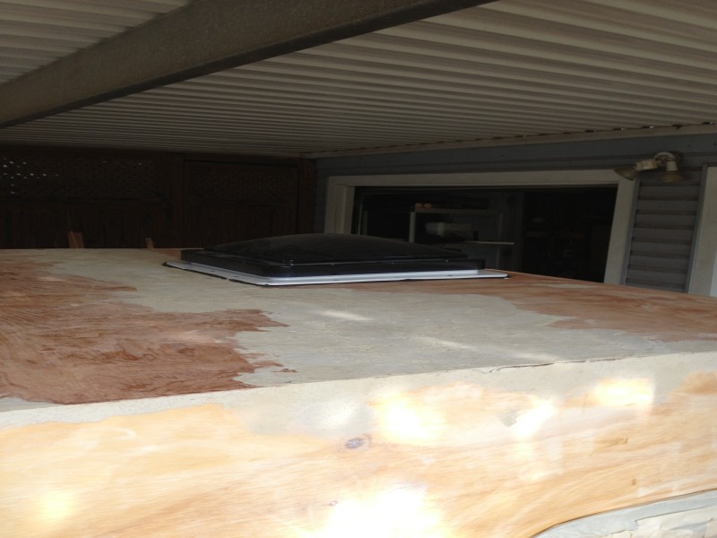

OK, so I sanded the fiberglass. Not so great. I will cover it with wood filler to make it smooth. The fiberglass will keep it from leaking, but it is hard to work with. The other areas are not as important as the roof. If it leaks, it leaks. I will just put a shelter over it.
I will buy some more filler, do the rest of the seams and work around the screws. Then a little bit of sanding and on with the paint. Even if I have to re-do it every other year, it’s all on the same surface, same color. It should be easy to do.

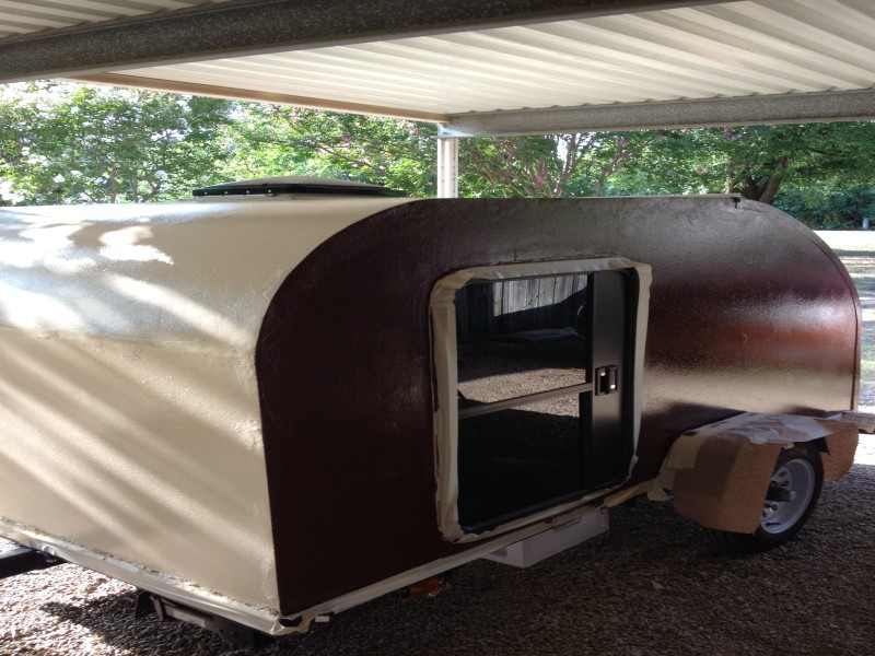

I painted this weekend. Oil base paint is a pain to work with. It is sticky and messy and takes a long time to dry. It is unforgiving too. You can’t just wipe it up. I re-taped the doors to make sure they would come out clean. I was glad I did. It is so much easier doing it that way.
I worried that I had not sanded enough. After putting on the primer you could still see places where the filler showed. I sanded and filled twice. I wondered if I should do it yet again.
Then I realized that I would not be able to make any real improvement. Now, someone else might have, but not me. I had gotten it as good as I could, even though it wasn’t that great. That was a big decision. I had to accept my short comings.
I painted the roof first. The color that matched the top of the car was too dark. I did a couple of strokes and didn’t like it. So I went back and got a lighter color beige. I am so glad I did. It looked a hundred times better.
Always paint the trim first, especially with oil base. It gives you the most room to move around without getting on freshly painted surfaces. I dabbed the brush on the wall first to get the bulk off the brush and then painted the trim. This was good in that I didn’t have any runs in the paint.
I didn’t tape the edges where the two colors meet. I just used a roller. I made sure there was no excess paint on it and went really slow so there would be no splatter. The edges came out really good and it was easy.
I put two coats on. Oil base takes a good 8+ hours to dry. You really need to let it sit overnight before it becomes really dry and hardened. Originally I was going to smooth it out with a brush for that clean look, but I decided to leave the nap. That was a good decision. It hid some of the bad filler work.
I have to say it looks really nice. The semi-gloss looks good and it is solid.

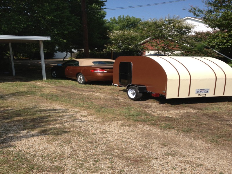

I have a few things to do, but it is basically finished. I took it to Whiz-Q and weighed. I came in at 870 pounds with a full load. Not only did I come in on budget, but I made my weight limit as well. It could not have turned out better. Happy, happy, happy.
I pulled the trailer to Austin and it pulled like a dream. No issues. It was a great success at the August birthday party. The women thought it was cute. The men liked the functionality. Everybody wanted one. I was able to get 20 mpg pulling that thing at 70 mph. You can’t beat that!
