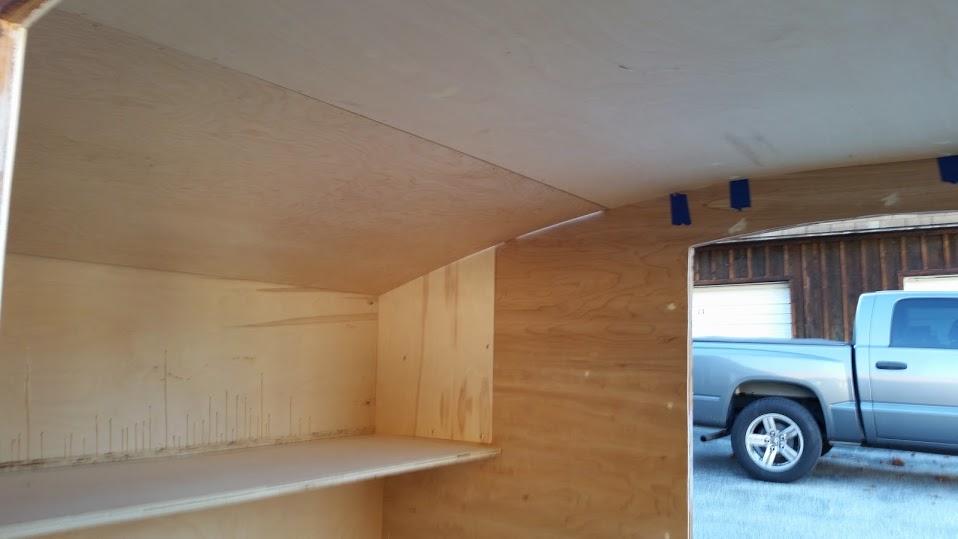

Postby kenafp » Fri Jan 09, 2015 12:13 pm
Update

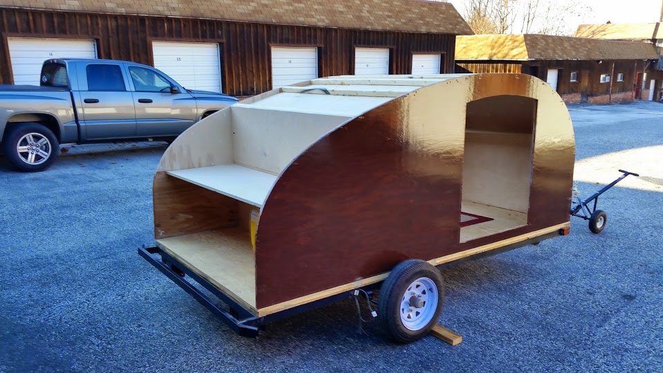

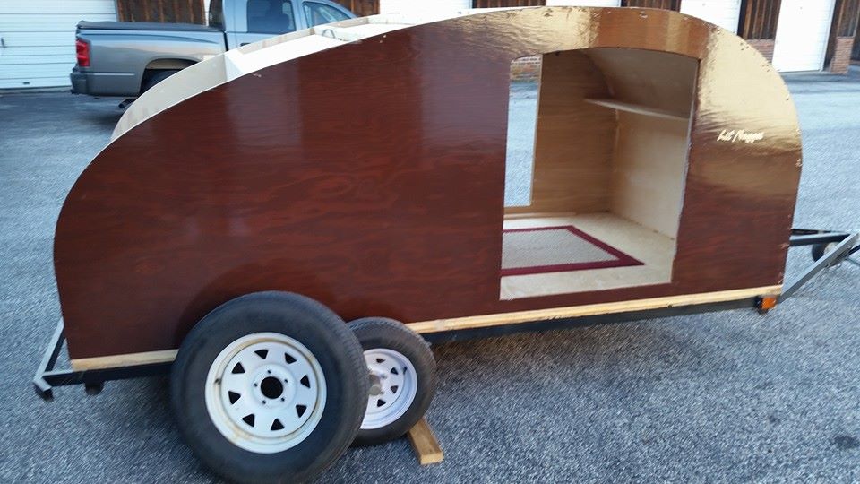

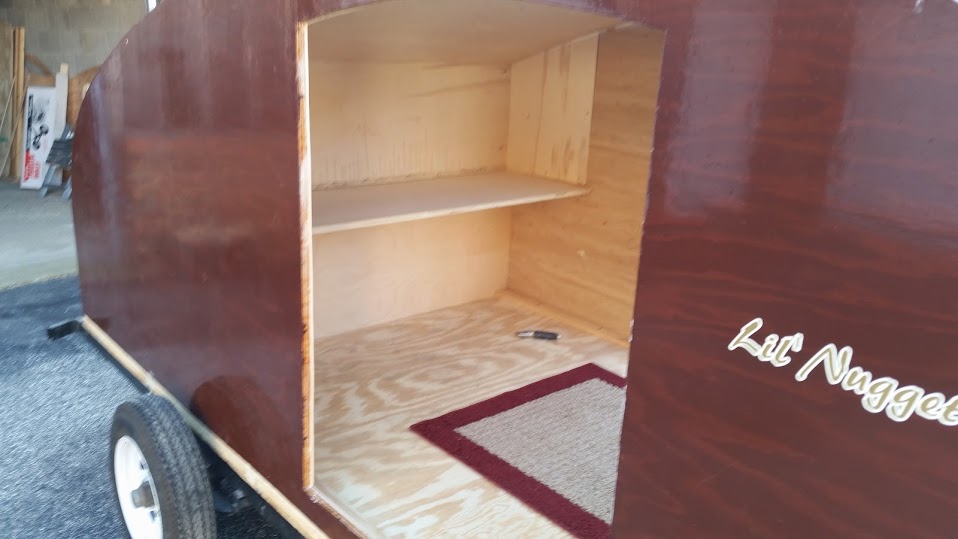

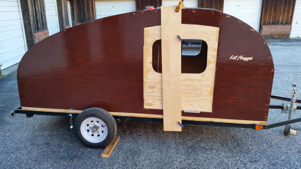

I was able to pull Lil Nugget out of the storage unit where I am assembling her.
It was great to finally get a good look from the sides and get some good pictures. You don't always get to appreciate how things are when you work in such close quarters like my storage unit.
Eventually, I will be storing her in another unit that I use for my business. But for now, I will be continuing to rent this for a few more months. It only drives the cost up that much more, unfortunately. But in my own home renovation, I got rid of my garage and turned it into more of a living space, so I am forced to look for space off site of my home.
I haven't seen other pictures of how you fit doors. I was told I needed 1/4 inch on 3 sides and 3/8th inch on the hinge side. So I lined up the doors, noted where I needed to shave it down and took them home to do it in the warmth of my lower level. It's also the place where I will staining and polyurethaning . Feel sorry for my wife since she has to put up with the stink until it dissipates.

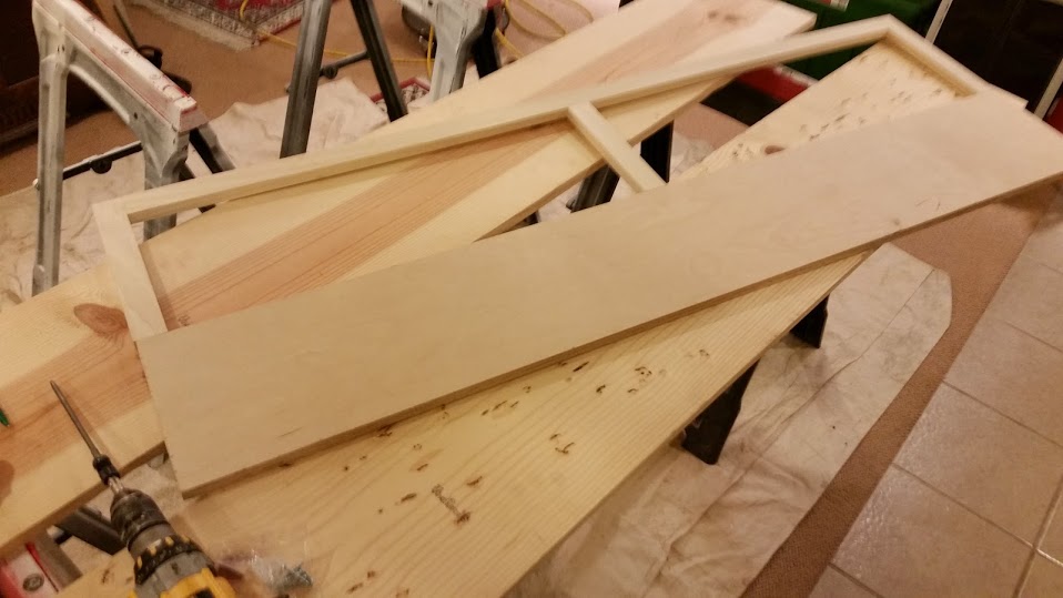

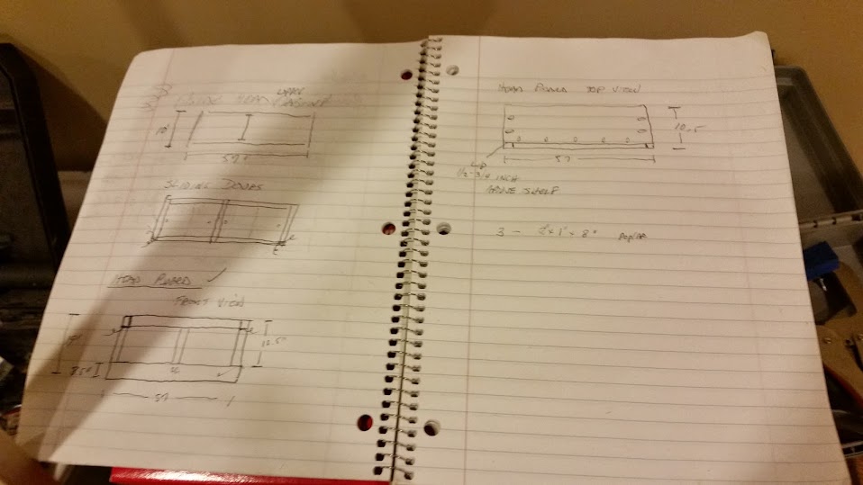

Postby kenafp » Fri Jan 09, 2015 12:24 pm

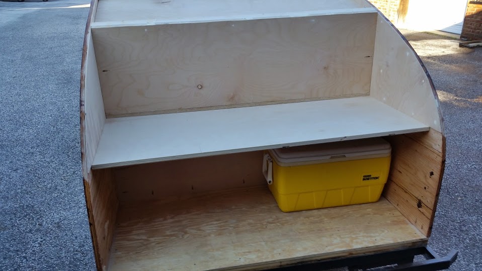

Working on building and staining the cabinet fronts...sans doors...
My note book has come in handy and has become invaluable in figuring out my options
The headboard. 8.5 inches as a base to account for the mattress
The foot cabinets facade

Will be fitting the foot cabinets here.
With the galley, I'm not to sure how I want to configure it. I had an original idea. But decided against that as my plans change.
I figured I still had time to customize it as we get experience out in the field.

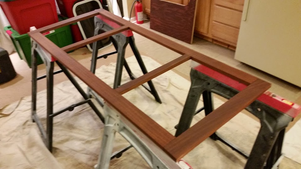

Postby kenafp » Wed Jan 14, 2015 1:43 am

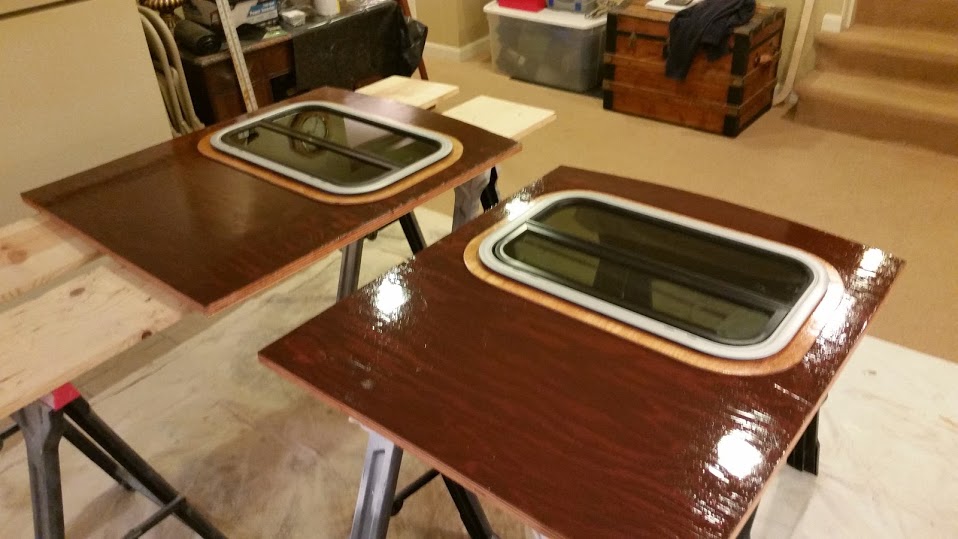

Been working on staining and finish coating the doors and cabinet frames. 2 coats of stain and 3 coats of varnish on each side takes a number of days. But I am really pleased with the results.
I was wondering what to do with the over head cabinet and the headboard cabinet openings. I decided on sliding doors. I was able to pick up some cabinet sliding door tracks on ebay at a good price, cheaper than buying router bits. They came today. I'll install them once I put up the frames.

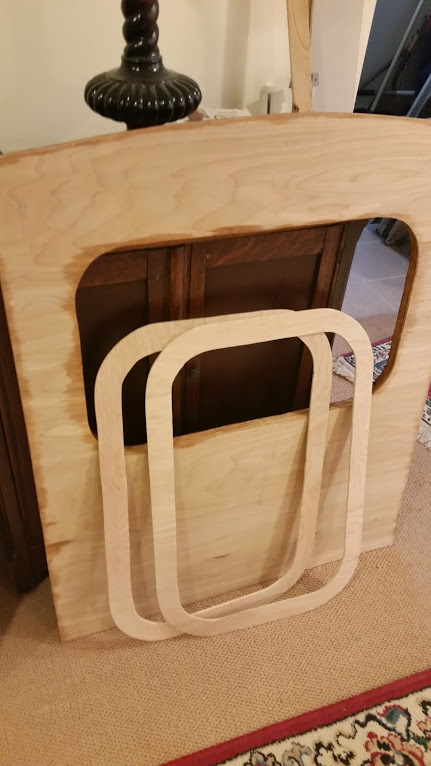

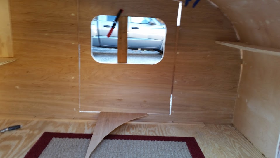

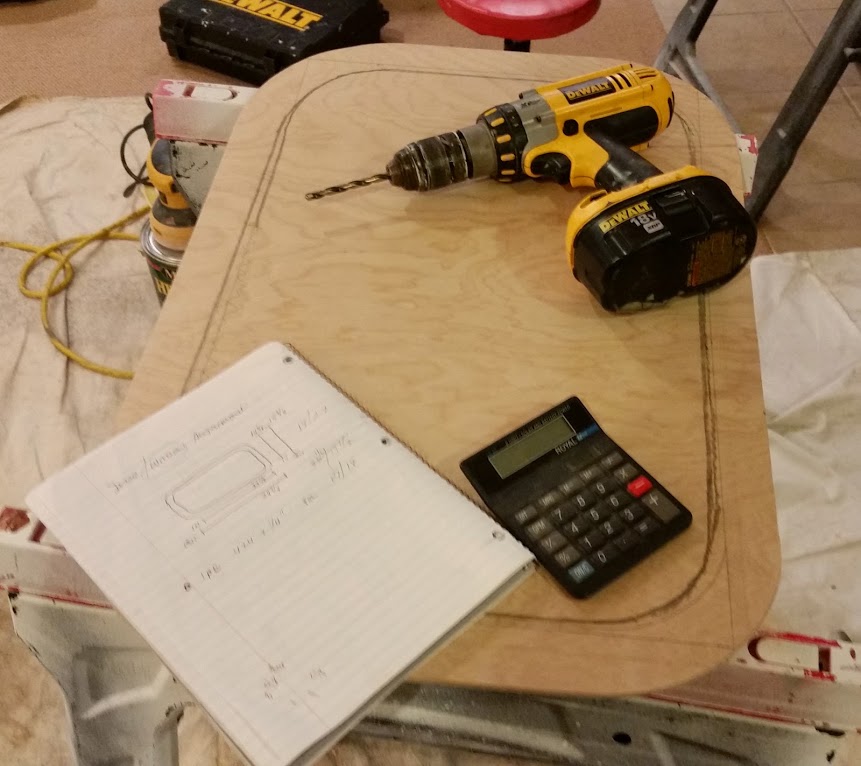

Two problems solved with this insert:
1. I cut the opening for the windows too large in doors
2. The windows are a little too thick for the 1 inch thickness of the wood. This spacer should help it get tighter when screwed down.
A 3rd benefit is that it provides a nice contrast to the darker stain.
20150109_182547 (1).jpg (94.91 KiB) Viewed 1614 times
This is just my template. Adjustments will have to be made once I see how this fits.

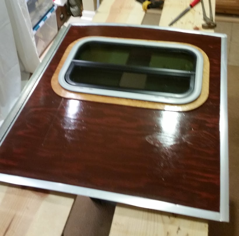

20150110_145344 (1).jpg (69.93 KiB) Viewed 1614 times
These are the finished cutouts. They fit the windows!

Re: Lil' Nugget build
Postby kenafp » Wed Jan 14, 2015 9:09 pm
The staining and finishing process was agonizingly slow.
I didn't have much space to work with and each coat took 6-8 hours to dry before the next one.
The inside is a satin finish, while the exterior is a gloss. Both have two coats of stain and 3 coats of poly/spar varnish.
Once complete, the exterior will get at least another coat of spar varnish.
Now, I'm just waiting on my order for the edge molding to arrive so I can get that done. In the meantime, this will sit and cure.

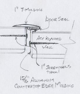

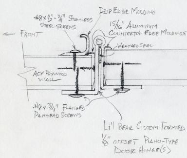

I was a bit anxious to get back to working on the TD. So, hastily, I unwrapped the long tube of parts I got from Grant, and started to cut away. First challenge was that I used a left handed cutting tool that bent the aluminum up one way and down the other. I had to try to straighten out the metal, and this started off looking pretty bad.
As I cut, I installed the pieces of edge molding, and T-molding, as well as the offset door hinge.
BIG MISTAKE!
I should have looked over my supplies, and decided on the best piece to use, instead of just grabbing the first one I could.
I should have cut the pieces, then dry fit them. But I secured the pieces to the door as I cut them. It cause a bit of anxiety.
The topped curved piece was the last piece I cut , shaped and fitted. All the other pieces I cut, applied clear sealant and adhesive and tacked each side with just three short twist nails. I did, at least, make sure that the overlaps at each end allowed for any possibly water to go over the joint, rather than allow it to accept and hold any potential water.
But the top bent piece was a bear. I'm not really sure how to do this right.
I tacked two short twist nails at the end to hold it in place, then as I bent it, I tried to tack additional nails closer together. The only problem was when I mis-hit the nail, I would ding the aluminum t-molding and nick it. I also decided to try using a few pan head screws to see if that might hold better than the nails, which I didn't trust on holding as I feared that the force of the bend might pop out the nails. Worst case scenario is that if the screws are too big for the closing of the door, I'll take them out, and fill with caulk to keep the water from penetrating.
I found that when bending the t-molding that it tended to twist as well, and it was tough keeping the face of the molding on the flat part of the door. I had to take out the nails a few times and re-position it, using clamps to secure the t-molding so it was flush with the front of the door.
I'm a little concerned that the combination of this twisting and the nicking of the t-molding may compromise the integrity of the watertight seal when the door is closed. But I attribute my fear to inexperience, and hope that it will prove to be ok.
The top of the door looks really rough and not well done at all. The second door should be much better.
One note here, is that when I was tacking the nails into the t-molding, I was smart in that I pre-drilled holes for the nails to go into. The one nail I did not do that for caused my set up to almost explode. All the tools and nails I had sitting on top went everywhere.
I'm a little upset that these dings look bad.
I was able to apply some 50 year clear caulk to the edges to seal these. We'll see how this holds up.
Here is the diagram from Grant that I used in fitting the t-molding. Grant, I hope you don't mind me sharing these.
