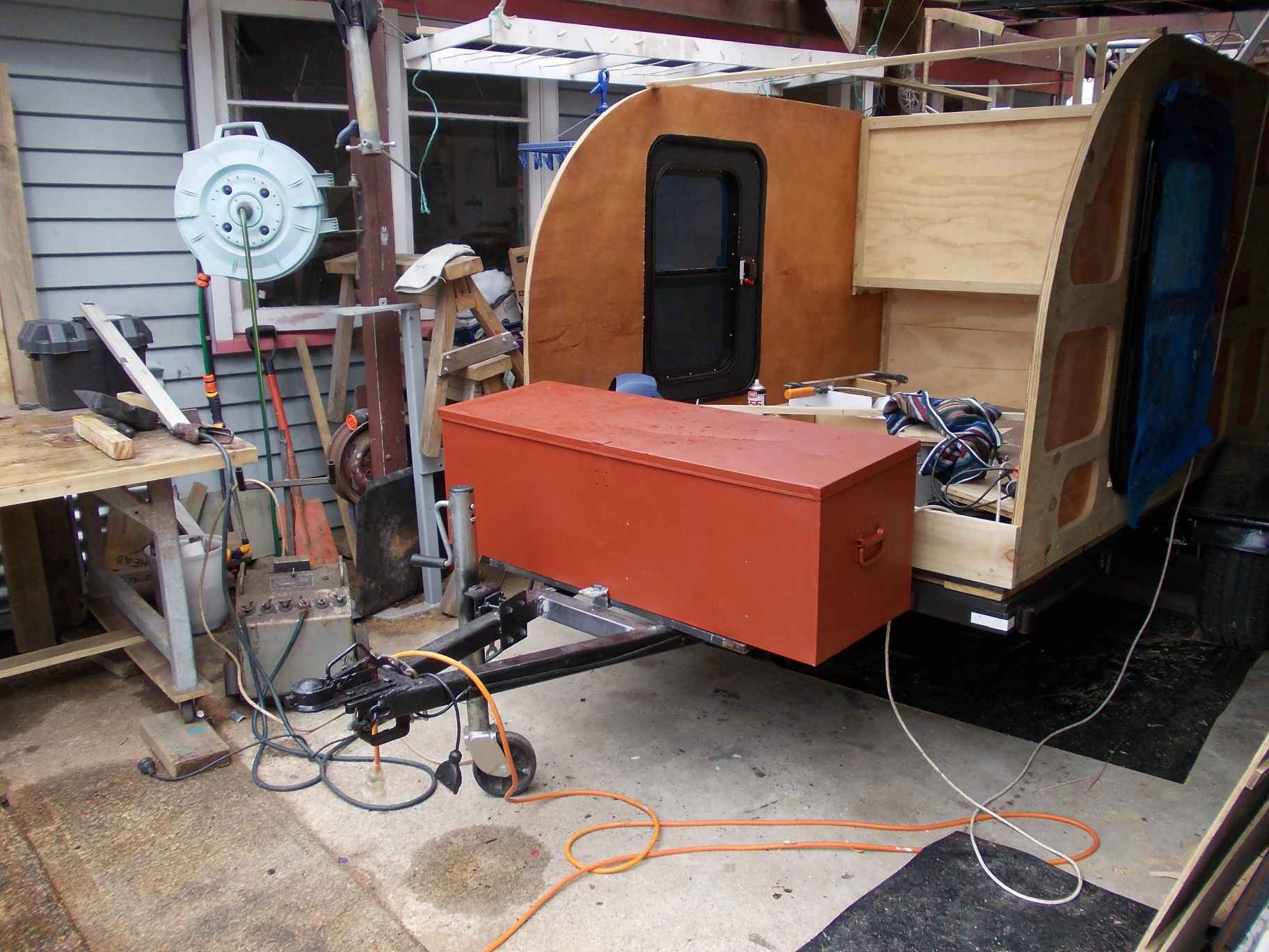

Worked on the tongue box and mounts today, also trial fitted the doors.
Also looking at lining the inside with this product, I think it will look quite nice, http://www.wovenbamboo.co.nz/woven-bamb ... 24_26.html
we are looking at the WB panel, last one on page. $62 a sheet, 2.440x1.220.
Chose to go with a slightly larger tongue box so we can store, battery, gas bottle (3kg), cooker and odds and sods, like jack etc.

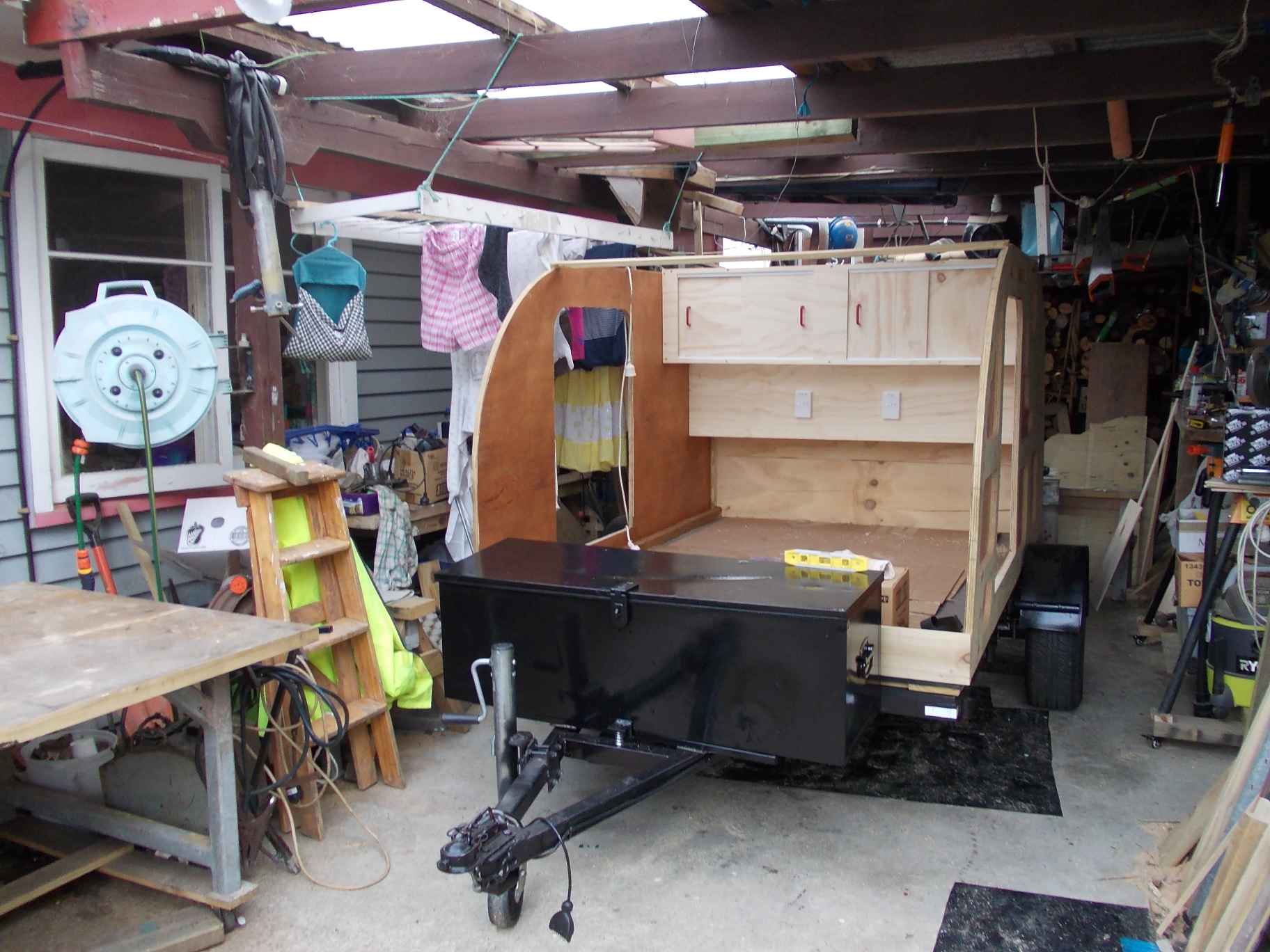

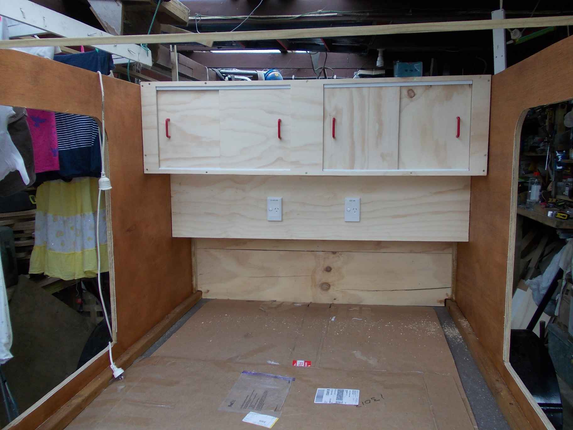

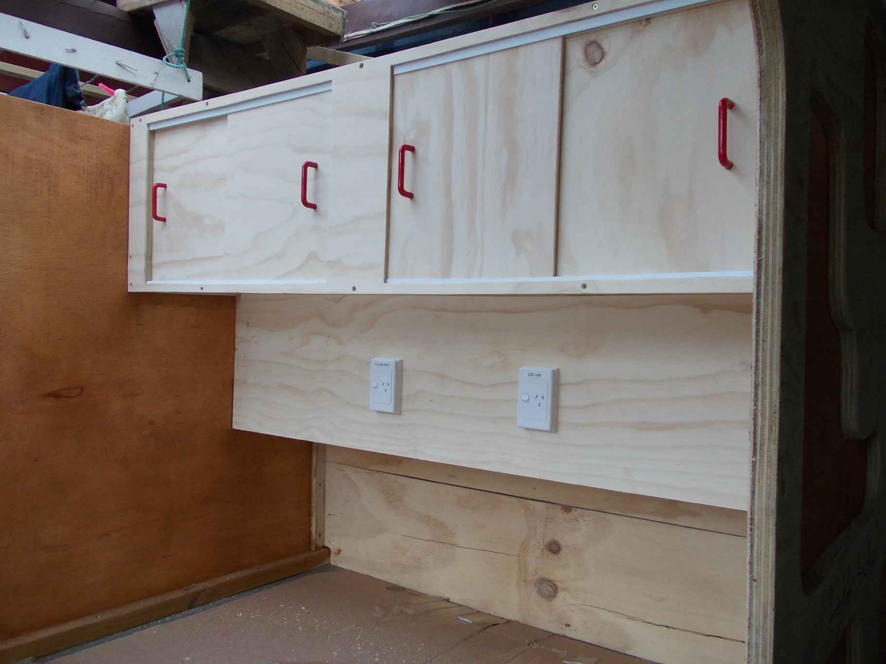

Postby trailtroll » Fri Apr 17, 2015 12:27 am
Busy again today, finished the tongue box paint and mount, also trial fit cupboards & internal power-points
:vroom:
Cupboards
Inside cupboards and power points
Tongue box fitted

Postby dales133 » Fri Apr 17, 2015 6:58 pm
Nice job on the cabinetts, looking good
