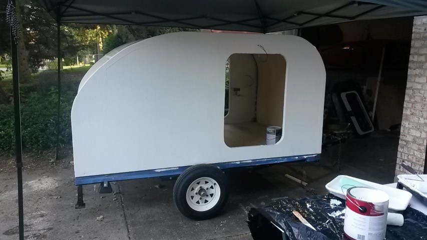

Got the rest of the staples pulled from the inside, maksed things off, and we're ready to paint the inside
Got two thick coats of epoxy on the hatch, going to have to trim the FG and let that cure. Will probably do a quick sanding on it tonight to see if it needs another coat or not
Did a quick rough sand on the trailer last night so we are going to start exterior paint to night. Got a fuse box, main fuse, pull down latches and shore power adapter on order (should be in tomorrow) so once I'm done with paint we should be golden on that.
Wish us luck, we're painting tonight!

Postby booyah » Tue Jul 21, 2015 12:52 pm
Got one coat of paint on, need at least another two I think. I hope to have pics up after tonight's coat #2

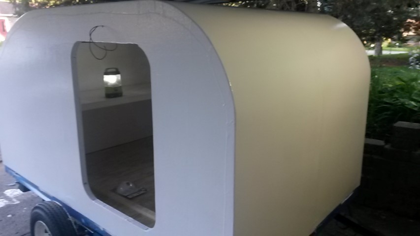

Three coats on the outside, everything except for the hatch, painted the inside a nice soft blue (wifes choice)
Doors are going on tonight!
Goign to add some accent colors later, either blue or red 4" bar below the doors, that will angle up at a 45 degree angle to the hatch hinge.

Doors are on, rear galley wall/bulkhead is sealed up with a piece of the 1/8th in birch
Put in the rear counter top brace and building a counter top for that now. Paint is inside as well. Painting the hatch this weekend, routing the counter top, and hopefully working on wiring tonight.
Hope to have it out next weekend. A far cry from "done" still, but I'll settle for "serviceable"
