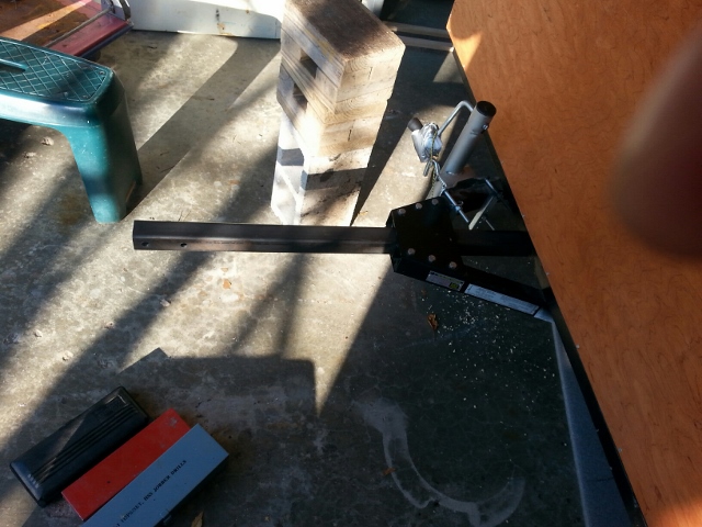

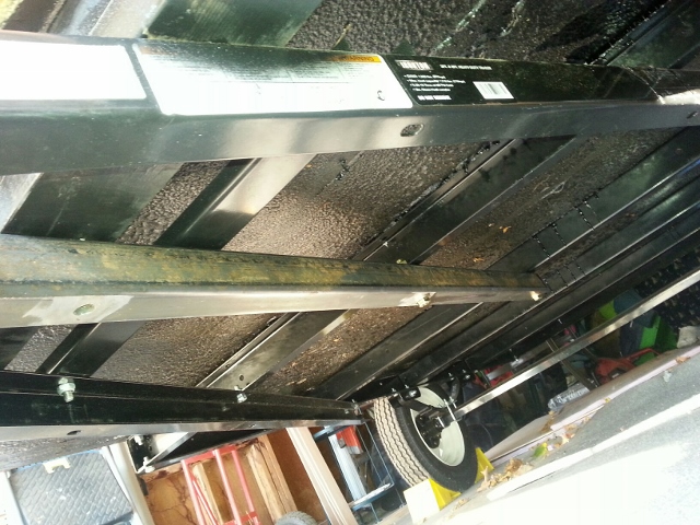

We had a tongue made by a local welding shop. I sent plans out to 7 local shops, only 2 responded and only 1 was willing to do it. All I needed was a few holes drilled and some anti-crush sleeves welded in. Guess it's time to take a welding class.
20151107_145127_resized (640x480).jpg (184.58 KiB) Viewed 1894 times
20151107_145150_resized (640x480).jpg (221.13 KiB) Viewed 1894 times

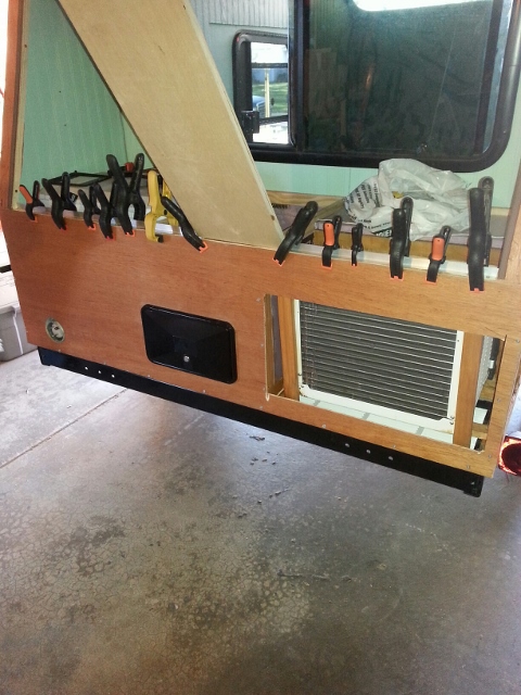

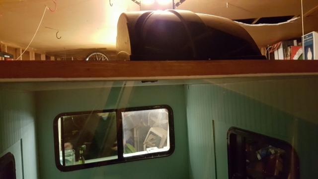

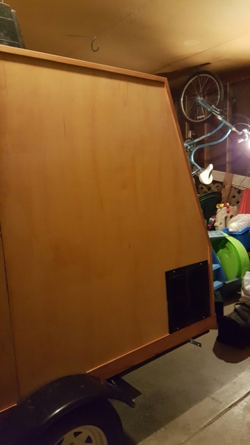

We also installed a grate underneath the air-conditioner to reduce the amount of road splash entering that compartment and installed the back panel with a utility door to access the power center.
20151108_135237_resized (480x640).jpg (203.22 KiB) Viewed 1894 times

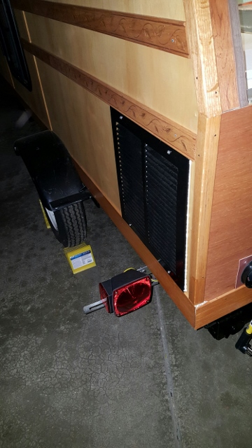

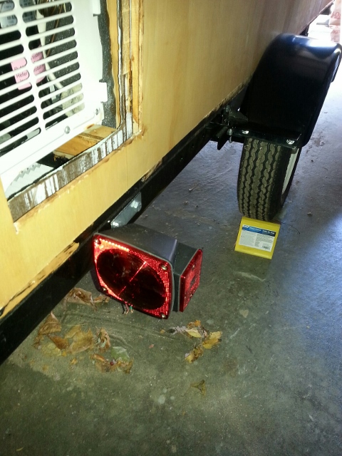

We also installed the fenders and attached the lights. The lights have actually been removed again as they need to be extended out a few inches further.
20151108_111847_resized (480x640).jpg (208.44 KiB) Viewed 1894 times

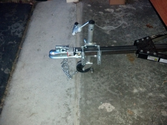

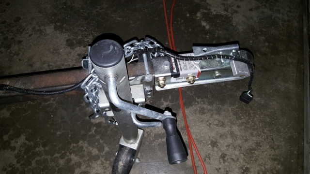

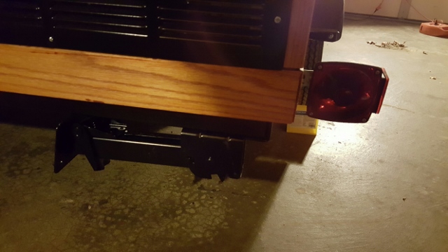

Had to get a smaller coupler - got that installed and moved the tongue jack.
IMG_20151114_165322_427 (2) (640x480).jpg (162.51 KiB) Viewed 1894 times

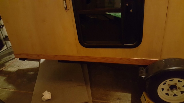

Trimmed the bottom:
20151114_180107_resized (640x360).jpg (90.7 KiB) Viewed 1894 times

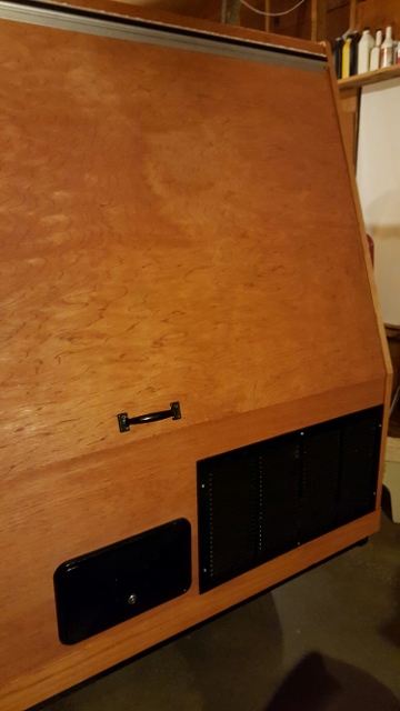

Trimmed the corners and installed vents covers over the galley exhaust holes:
20151114_192837_resized (360x640).jpg (101.64 KiB) Viewed 1894 times

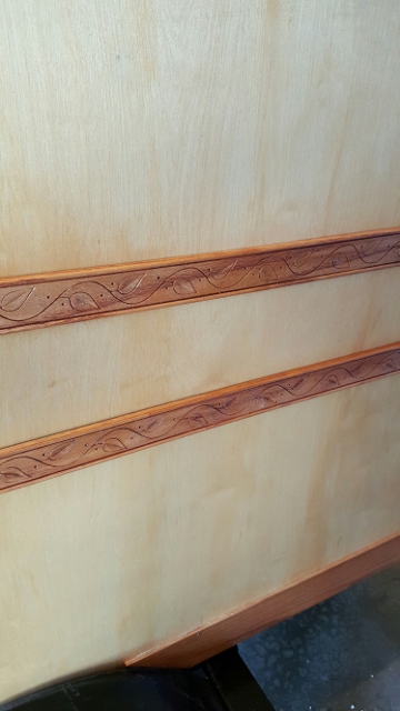

Added some decorative trim stripes:
20151115_153429_resized (360x640).jpg (113.97 KiB) Viewed 1888 times

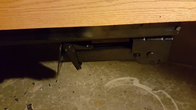

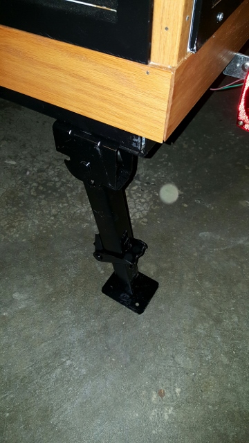

Installed stabilizer jacks. On the rear they fold down and extend laterally:
20151128_195722_resized (640x360).jpg (115.72 KiB) Viewed 1737 times
20151128_195755_resized (360x640).jpg (152.95 KiB) Viewed 1737 times
On the front, the A-frame tongue prevented that so they point forward, with a slight angle laterally:
20151128_195825_resized (640x360).jpg (114.13 KiB) Viewed 1737 times

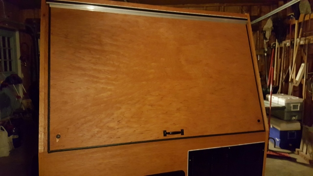

Some trim around the hatch lid and camlocks to keep it shut:
20151128_195706_resized (640x360).jpg (117.75 KiB) Viewed 1737 times

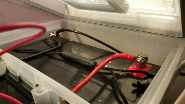

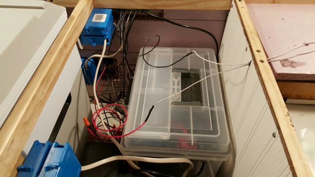

We fashioned a battery box from a weatherproof file box, some grommets and a vinyl tube for a vent, we put putty where the cables meet the grommets just to ensure they were sealed. The + lead and one - lead go to the PD4045, the other - lead goes to the DC ground block:
20151128_200050_resized (640x360).jpg (126.4 KiB) Viewed 1733 times
The DC system is grounded to trailer frame by the other large gauge wire running from the ground block to the same contact point as the AC system:

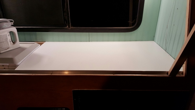

We painted the countertop with "scrubable paint" we'll see how long it lasts.
20151128_195933_resized (640x360).jpg (85.04 KiB) Viewed 1733 times

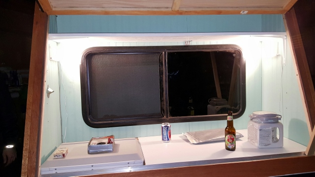

We installed a shelf in the galley, it's not a ton of space but is a bit taller than what you can see in the picture, and it's big enough to get a coleman stove into:
20151128_195515_resized (640x360).jpg (120.79 KiB) Viewed 1729 times

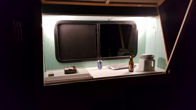

And with all the lights and the camera flash off, you can see we've got plenty of light to cook by:
20151128_195544_resized (640x360).jpg (89.38 KiB) Viewed 1729 times

Postby KCStudly » Wed Dec 02, 2015 8:40 pm
Looking good! :thumbsup:
I was wondering about the decision to run the chassis ground from the bus instead of directly from the battery. :thinking:
Re: A woody tiny-trailer for my first build!
Postby drshoe » Wed Dec 02, 2015 11:05 pm
KCStudly wrote:I was wondering about the decision to run the chassis ground from the bus instead of directly from the battery.
Two reasons, it was convenient and it satisfies my current requirements (pun intended.)
It is good standard practice to run the chassis ground to the battery terminal. That way if you disconnect the bus from the battery, the chassis is still grounded.
At this point I haven't installed any type of general disconnect for the DC system; if I were to install a switch on the battery to bus connection then I would most certainly bring the chassis ground to the battery post.

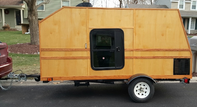

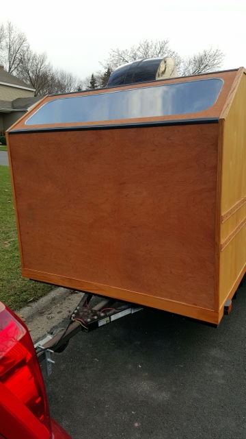

Weekend 12
It's done! for now...
A sketch from before we started:
IMG_20151208_203104_411 (2) (640x448).jpg (109.63 KiB) Viewed 1599 times
and pictures:
20151206_153114_resized (360x640).jpg (130.7 KiB) Viewed 1599 times
20151206_153149_resized (640x348).jpg (159.46 KiB) Viewed 1599 times
