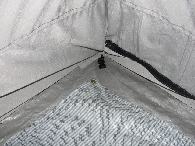

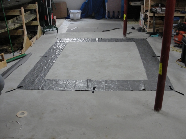

This the floor. It's a heavy tarp that forms a border that is 16" wide and is sewn to the walls. I have a heavy mesh RV patio mat that will clip into this floor.

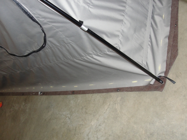

Here's a floor corner. I'll install a grommet to receive the tent pole.

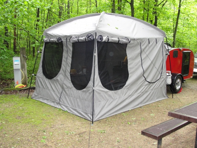

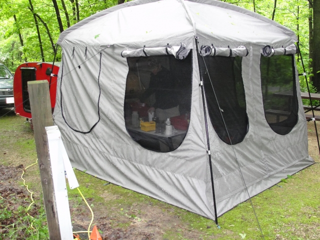

Here are a bunch of pictures from our first weekend using the galley tent in pretty heavy rain.

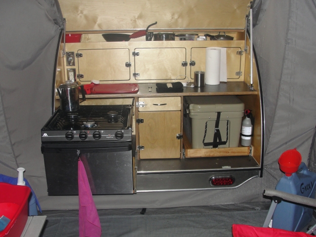

Here's a view of the galley area. Fresh water positioned on left, gray water on right. See the stream of water coming down the right side from some missed stitching where the galley sleeve connects to the tent body?
There's enough room to have a sitting area with an end table.
Our 4' by 28" Cabela's aluminum roll-up table works great on the left side.
The porta potty fits nicely in the entrance corner.

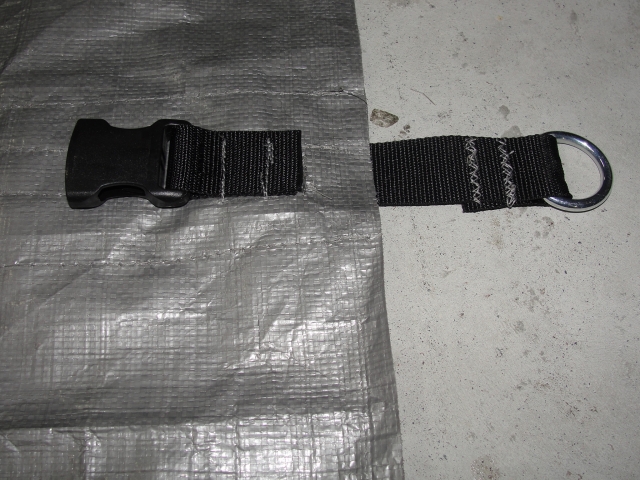

I'll sew clips in to tie the patio floor to the tent floor.
Keeping the two windows closest to the stove closed while cooking protects the flame from the wind.

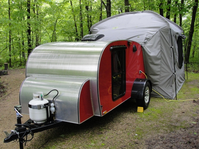

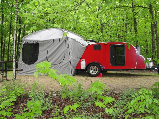

My goal was to make the tent big enough to be functional but not too big to catch a lot of wind or look bad. I think we accomplished our goal.

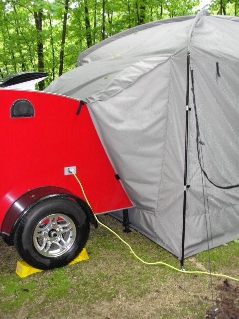

View of galley sleeve on passenger side. It's a little too tight to accommodate unlevel ground situations. It's also fastened with Gorilla tape while we decide how to fasten it.
We offset the sleeve to the driver's side to give more clearance from the heat of the stove.
Due to the offset, the driver's side of the sleeve has a third dimension. We just pinned it as we went and it worked out quite well.
The corner windows give a good view to the outdoors.
Copper spends less time on the leash with a 9' by 11' galley tent to lounge in!

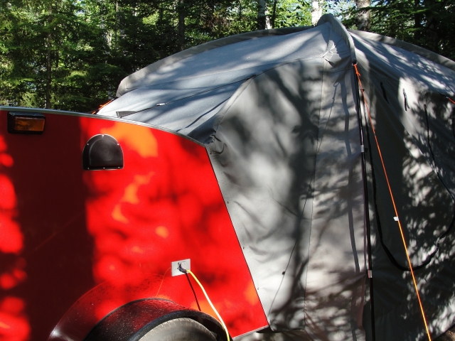

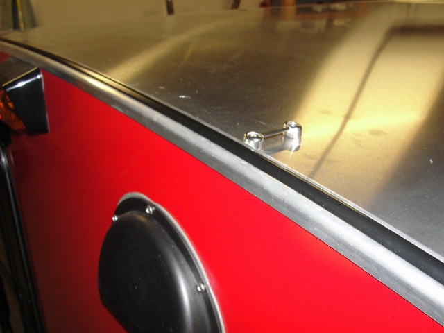

Postby Dusty Mark » Sat Jun 24, 2017 8:02 pm
I finally came up with a good design to seal the galley sleeve to the side of the camper and make it more weather and bug proof. I opted to completely redo the sleeve, ripped it off the main tent, and started over with heavier Top Notch 9 polyester material. Wow is that nice material, but I believe it's too heavy to make the whole tent from it.

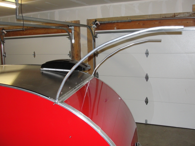

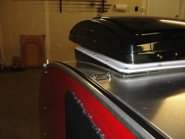

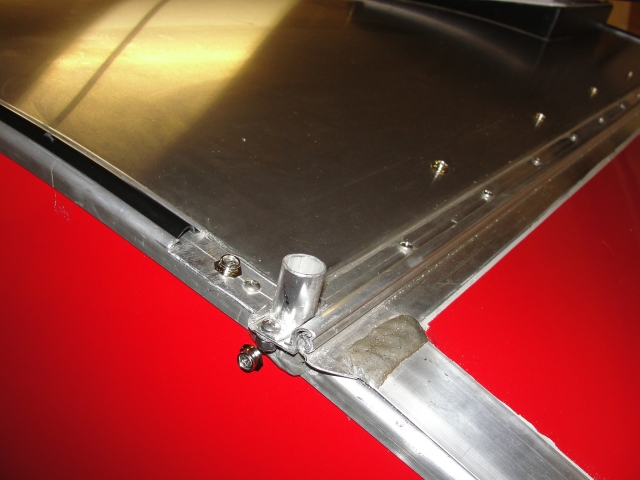

I'm using tent poles to support the sleeve so it mostly keeps its shape even when the galley door is closed. I used 3/4" aluminum tubing and formed a bracket that receives the 7/8" tent pole tubing. I cut slots in the 3/4" tubing, heated it with a torch and bent the tabs to 90 degrees to create a way to fasten the bracket inside the hurricane hinge track.
Here the sleeve poles are resting on top of the brackets.

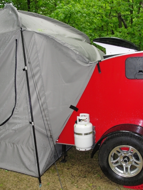

This footman loop, on the driver's side, holds a piece of 1" webbing to adjust and support the sleeve pole.
The corresponding footman's loop on the passenger's side.

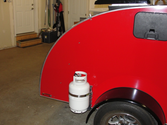

Snaps installed across the top of the galley roof and down the driver's side wall.
Snaps installed on the passenger side wall.

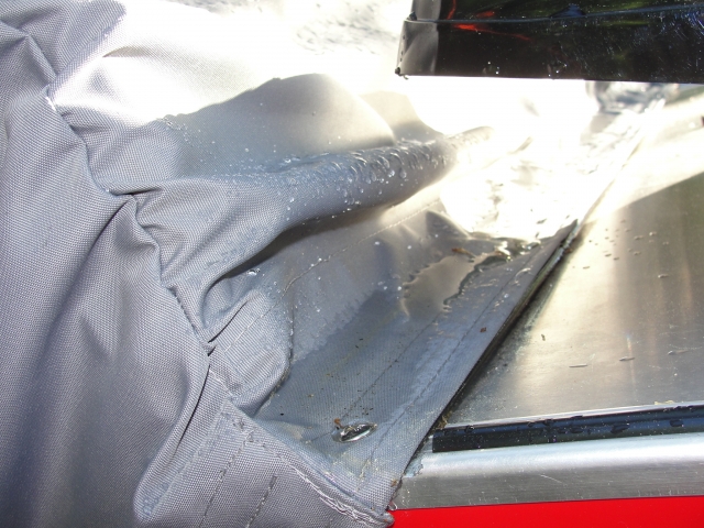

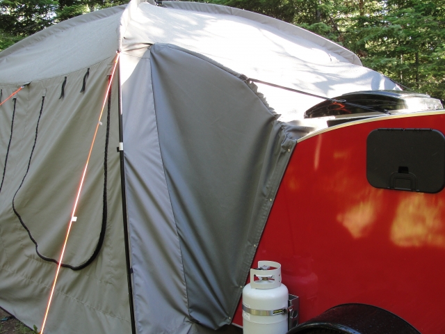

Driver side view of sleeve attached to camper. The ground was sloping up at this site so there is a little bit of material bunched up at the base of the hinge. I sewed a sleeve for the pole midway up where the strap connects. I also sewed an open sleeve where the galley sleeve meets the tent body. Leaving it open allows the pole to slide further into the tent when the tent is pitched on an upslope and we still level the camper.
Passenger side view of galley sleeve.
The galley lid is closed in this picture. Notice that the sleeve mostly maintains its shape even without the lid supporting it in the middle. I could install a third pole in the center, but I'm going to use it this way for a while first.
Water pooled here a bit after a pretty good rain shower, but it did not come through the sleeve.
This weather stripping is amazing. I installed pull-the-dot snaps every 10" to hold it in place. This is very effective!

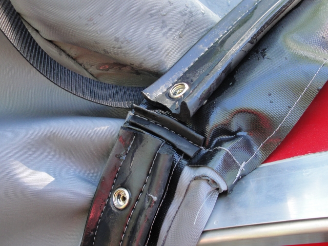

A closer look at the corner. I sewed a layer of Shelter-Rite material under the weather stripping. I saw this on a Sail Rite Kits video and decided to give it a try. I like the way it turned out.
I sewed a strip of velcro to the bottom edge of the tent that borders the bumper. I installed self-stick Velcro on the back side of the bumper. This provides an effective means to seal off the bottom edge of the galley sleeve. I could install a couple of snaps, but will just use it with the Velcro for now.

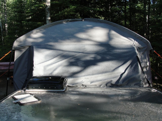

I'm very happy with how fast we can pitch the tent. The galley sleeve looks like quite the "operation", but it goes on without much effort. Other campers stop by to check out our set-up and we're getting a lot of good feedback on the design. Attempting to make the "ultimate galley tent" was an epic quest, but it proved successful after investing way more time and money than I anticipated.

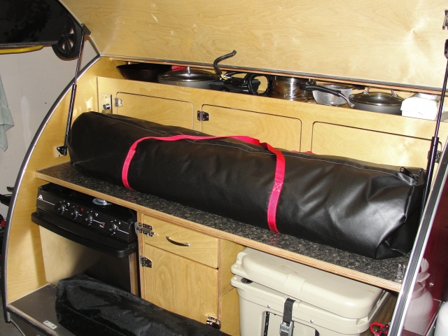

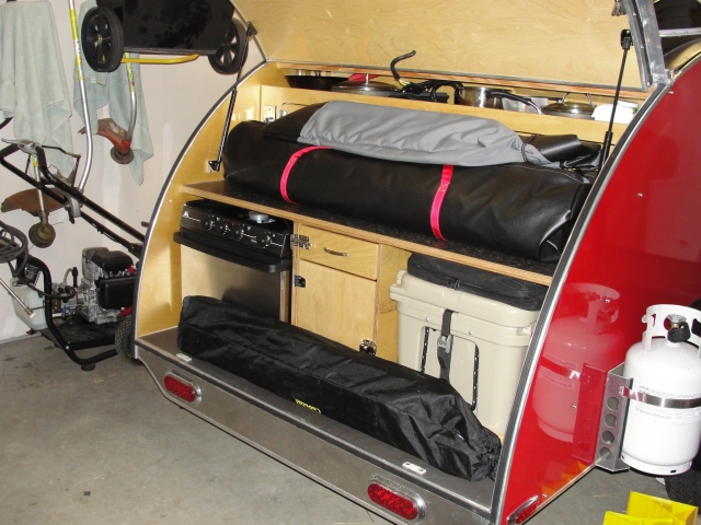

I sewed storage bags for the galley tent that allow it to fit on the galley counter during travel. My kayak cover storage bag is 11 1/2" in diameter and seemed a little tight, so I made the main tent storage bag 11" in diameter. The tent bag is constructed from Shelter Rite material. This is an outdoor vinyl that should contain the mess when packing up a wet tent.
There is a full-length zipper on the top to allow easy packing of the rolled tent.
I made the pole bag from scraps of galley sleeve material and Shelter Rite material. I designed a wider bag so that the poles would store on top of the tent bag and still allow the galley lid to close. Notice the aluminum roll-top table stored on the floor of the galley. The RV patio mesh floor is stored on top of the cooler.
Here are the weights of the final product:
Bagged tent = 30 pounds
Bagged poles = 8 pounds
RV patio mesh floor = 9 pounds
