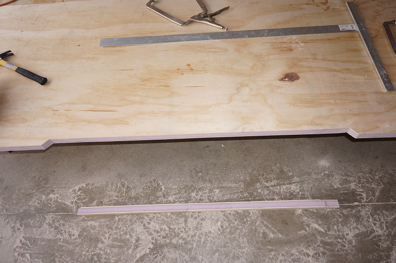

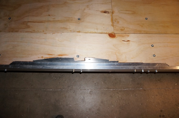

Postby StrongFeather » Fri Dec 28, 2018 4:43 pm
Pretty slow lately, but here's some pictures...
I clamped the frame to the floor, traced the inside perimeter of the frame onto the floor...
...and cut along the line so the floor will drop into the frame, leaving the top of the floor flush with the top of the frame.
And I added some angle aluminum to the front and rear frame rails to support the floor...

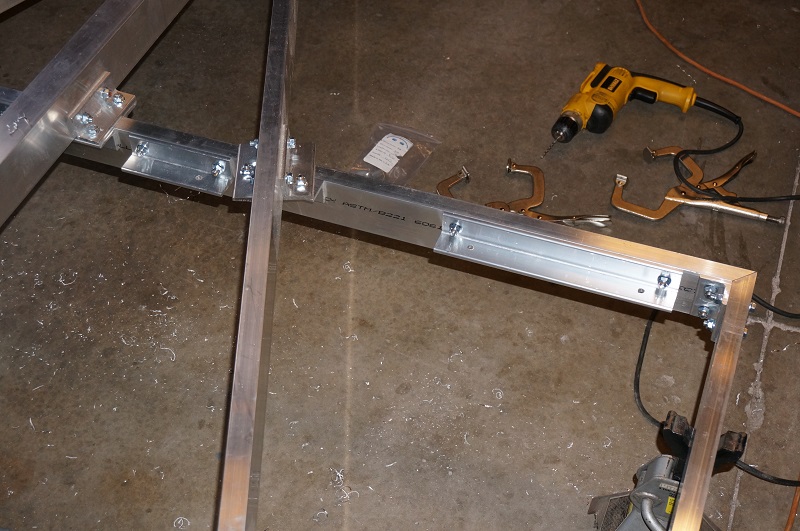

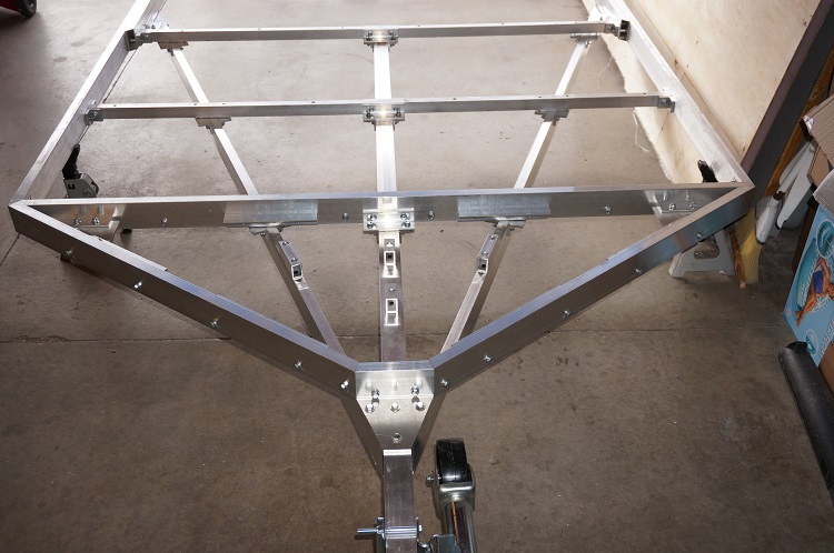

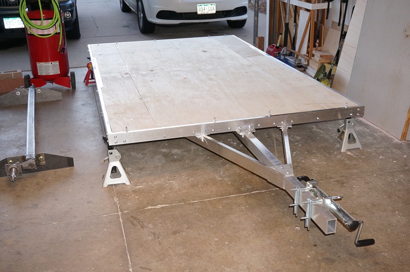

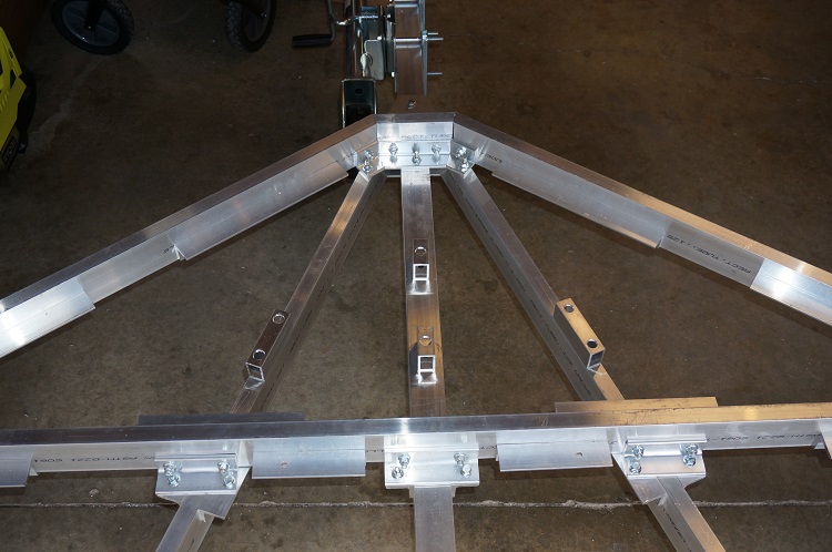

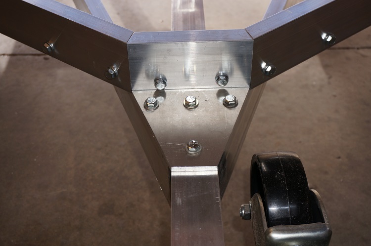

Postby StrongFeather » Sun Jan 06, 2019 9:46 pm

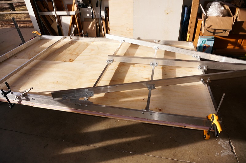

I was finally able to make some progress this weekend after being held hostage by cold weather for the better part of the week. I skinned the bottom of the floor with epoxy and fiberglass, and I had to wait for the epoxy to get hard enough to put the heating blanket on it without the blanket becoming part of the floor.
All of the metal fabrication is finally done and the floor is bolted down. Milestones! The last bit of metal work was the tongue box frame work. Even though it's a pretty small area, there were a lot of miter cuts and test fitting, so it took a little longer than I had hoped. But, I'm pretty happy with the way it turned out. Here are some pictures...
I'll try to explain a few things about what's going on here...
There will be a solid bulkhead separating the cabin and the TB. It will be located above the front frame rail. The TB will hold the batteries, electrical distribution, charger, inverter, etc... and the air conditioner. In the picture, you can see the angle aluminum "ledge" that the TB floor (1/2" ply) will sit on. The blocks sitting on the tongue beams are simply to support the weight of the batteries. The TB will be as tall as the rest of the trailer and have a large door on each side. I still need to figure out how I'm going to do the ventilation for the AC and electronics.
Just a rear view shot of the floor blocks and front miter cuts.
A close up of the front of the TB framework.
If I didn't say this before, I'm using a very old chop saw (with a non-ferrous blade) that is very inaccurate. This makes things a little challenging because I have to essentially rough cut everything and then hand file to fit.

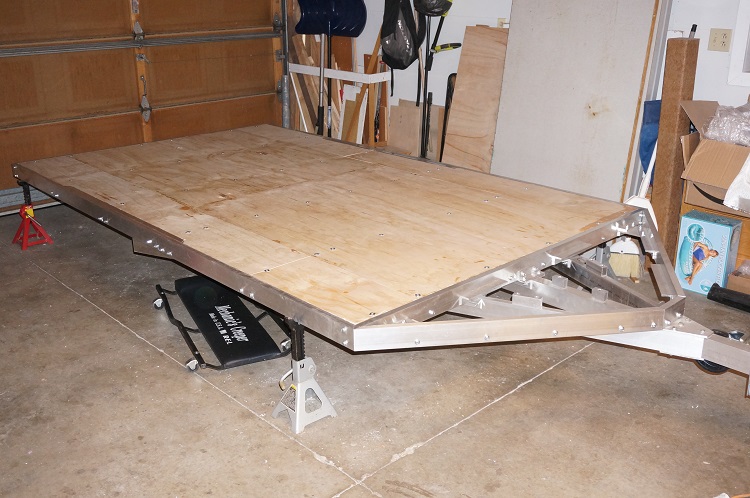

Postby StrongFeather » Sun Jan 06, 2019 10:06 pm
...and here is the floor bolted to the frame. Yay!
I'm 6 bolts short, so I'll be held hostage again for a few days waiting for a McMaster Carr delivery. Once the bolts come in and the floor is completely bolted down, I'll epoxy and fiberglass the top and the floor will be complete.
I tried to get a picture of the slot that I added to allow the axle mounting plate to slide fore and aft along the sister rails. Obviously the mounting plate is just sitting on top in this picture, but you can see how much adjustment I'll have when it comes down to mounting the axle. Initially I was going to start with the axle placement at 60/40, but I decided to start 3" forward of that because so much of the weight will be in the tongue box.

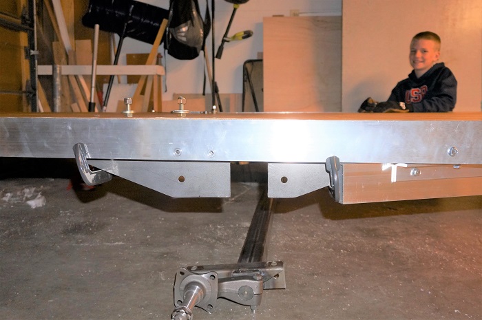

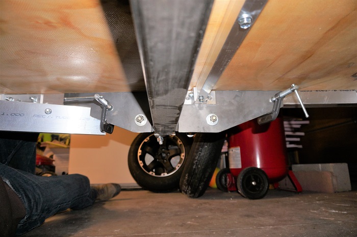

Postby StrongFeather » Sun Jan 20, 2019 10:50 am

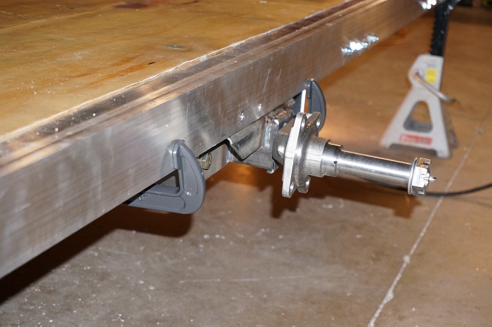

It's been a slow two weeks between waiting for epoxy to cure (in cold weather) and several more hours of final decision making research for the composite panels. Nevertheless, progress has been made. Some major milestones, in fact. The floor is done, it sat on it's own three wheels for the first time and I even took it on a low speed maiden voyage. Here are some pictures...
The axle mounting plate clamped in place (with some help from 5/5). Getting ready to levitate (5/5 has special powers) the axle into it's home.
And the axle mounted to the plate. The two holes in the main frame rail above the axle bracket are for the floor crossmember. It will get bolted when the final axle placement has been determined. Also, I plan on making the fender back come down to the bottom of bracket to tie the outside frame rail, axle bracket and fender together.
The back side of the axle mounting. If you look on the far left side of the mounting plate, you can see where I notched 3" out of it to allow the axle to slide forward of the 60/40 point. Honestly, I can see it going forward by another 2-3" when it's all said and done. But for now, and as long as I can, it'll stay where it sits, clamped in place.
When it does get permanently mounted, 1/2" bolts will go through the plate, the sister rail, main rail and the fender back. The bolts for the floor crossmember just aft of the axle will be done the same way.
And finally, the brakes, drums and wheels were installed and it sat on it's own three wheels for the first time.

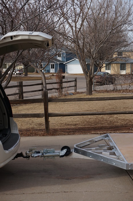

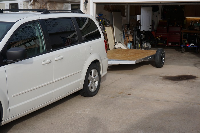

Postby StrongFeather » Sun Jan 20, 2019 11:09 am
Hitched up and ready to go on it's maiden voyage. A very slow trip to the next cul-de-sac and back.
I'm very pleased with the tongue length, turning radius and ride height at this point. Plenty of room to open the rear hatch of the van and probably around 80° turning radius.
I also clamped a fender on to see how it was going to look. I decided to go with 15x6 rims and had a hard time finding a wide fender with a smallish radius, in the end, I thought I settled for a set that was wide enough to clear the outside of the wheel but too round. Luckily I was pleasantly surprised and happy with how they fit. I also took some measurements for the door(s) while the fender was in place. As the axle sits now, I have 4'8" in front of the fender. So, the plan is a 24" wide door opening that starts 24" from the front corner. This will allow the door to swing 180° and sit flush against the wall without going past the front corner and interfering with the tongue box doors. It'll also allow some room between the door and fender and I still have plenty of room to slide the axle forward if necessary.
Now on to composite panel prototyping :twisted:
