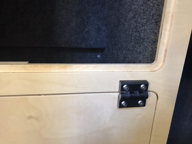

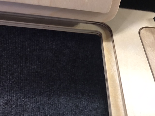

Postby ricky herbold » Sat Oct 12, 2019 2:56 pm
This is the edge detail I came up with for all of my cabinet doors. A 3/8 rabbet on both the doors and face frame. It was alot more work than just cutting a hole but it gives you a positive stop for the doors and holds them flush all the way around. I believe it was worth the extra effort.

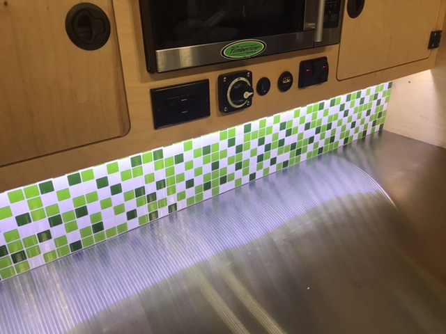

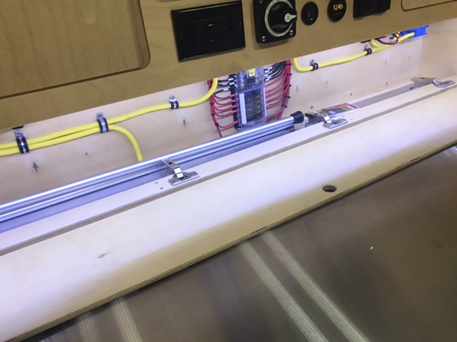

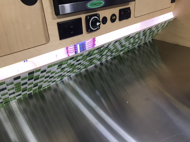

Postby ricky herbold » Sat Oct 12, 2019 3:08 pm
I didn’t really show how I concealed all of my electrical wiring. I made the backsplash so it could hinge down. The Bach splash is made from 3/8 BB to keep it both stiff and light and mounted on self closing cabinet door hinges. This cavity will also be where I plan to run all the water and vent lines as well as the propane line to the water heater.
