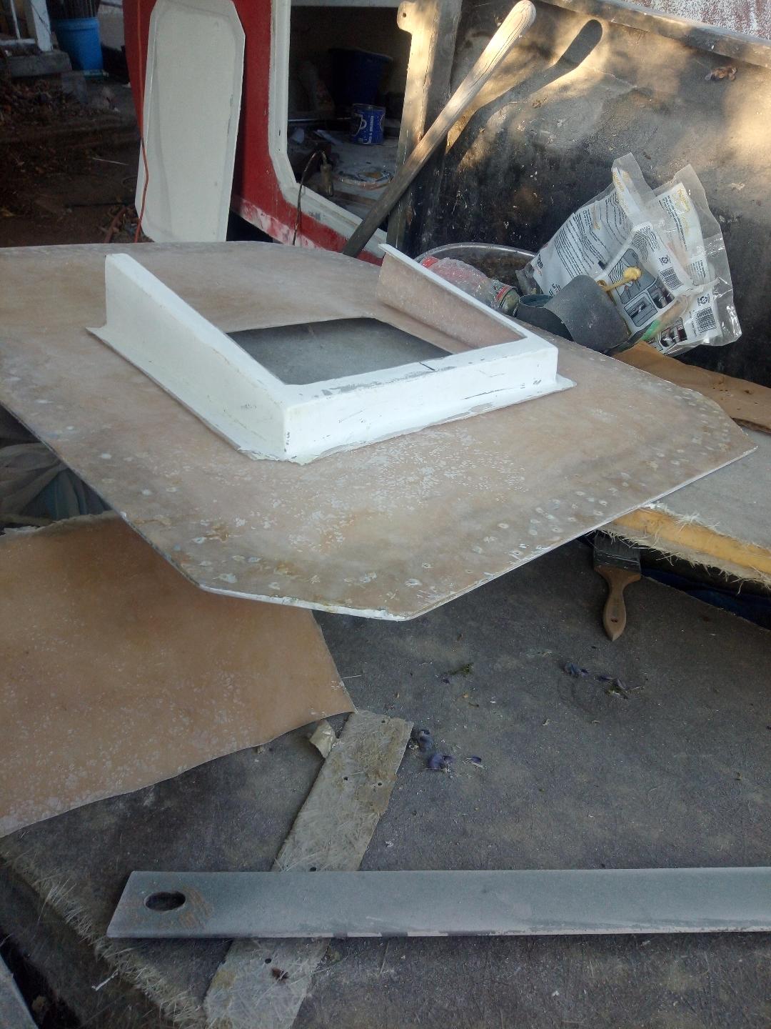

Postby saywhatthat » Wed Mar 23, 2022 1:27 am

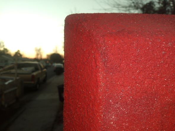

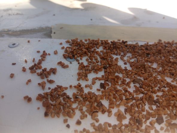

DIY fiberglass structural panels adding texture walnut shell imbedded with polyester resin
small .jpg (41.22 KiB) Viewed 829 times
IMG_20220110_163942 s.jpg (42.23 KiB) Viewed 829 times

for a bit of a different look . and act like a bed liner a hardened surface to protect the fiberglass easier to fix any gouges

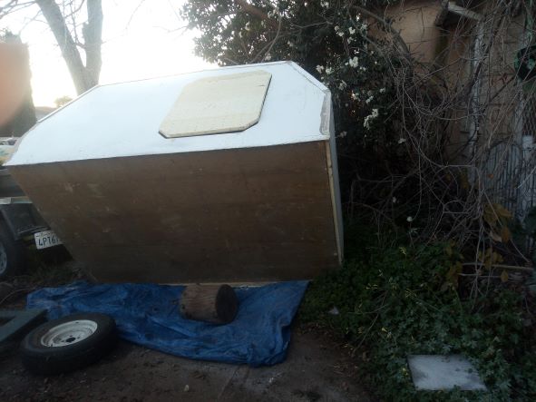

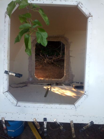

Postby saywhatthat » Fri Apr 01, 2022 12:45 am

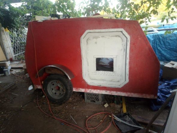

sorry for going so slow with this trailer it doesn't match other trailer so I'm either going to shove it in the back or trade it off for something. Also have an extra hundred eighty feet of 5 x 10 by one inch panels 18 ea 5x10 by1in
Sadly there is less than 10 hours to finish the pod.
add a rub rail along the bottom that way if there's any damage easy to fix remember this trailer can last hundreds of years. I don't know why more people don't do this.
in staled door jam
and brackets for interior shelving in the back
Will be making cot / shelf with netting on inside pod
I know I've gone a bit Wild on the rivets but he'll for $19 a thousand all by hand too lazy to go to the shop and get a air Riveter

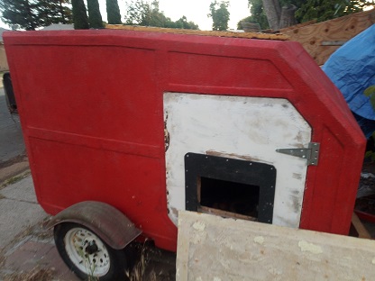

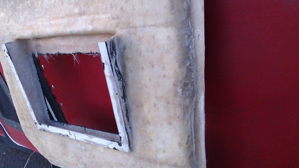

Postby saywhatthat » Fri Jul 29, 2022 12:01 am

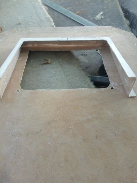

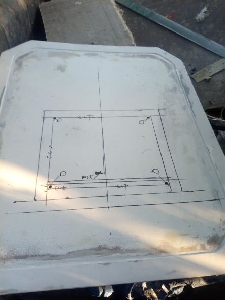

sorry about up dates . Cant use trailer because back dose not look like others.
I decided to work on my about $50 door free form no mold. I see what other people are charging is basically right at $400 for doors wacko
made a skin, added a eager for looks will add willey window . We use glass cut board for glass it tempered. when glue up will add foam round edge will add inserts for the door hinges and door handle lay up glass.
Need to make recessed door hinges I don't like the door to fit flush . I like it back little way makes it harder for animals to grab

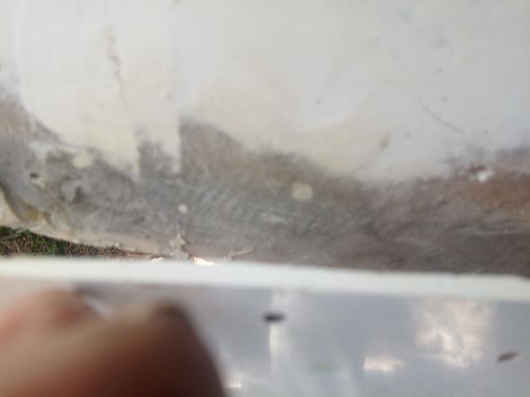

thumbnail (1).jpg (209.18 KiB) Viewed 690 times
thumbnail (2).jpg (30.86 KiB) Viewed 690 times
thumbnail (3).jpg (31.46 KiB) Viewed 690 times

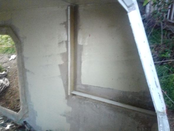

Re: fast, cheap, fiberglass/ foam stressed skin panels
Postby saywhatthat » Fri Jul 29, 2022 12:05 am
]this is what look like in my mind.
