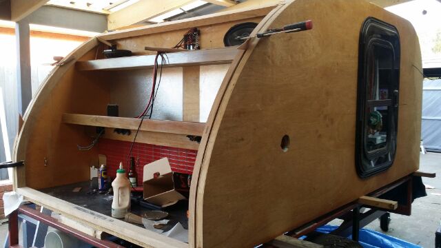

Postby dales133 » Sun Aug 23, 2015 5:13 am
Got a good deal done today and mostly the dreaded 12v electrical, not my forte at all.
Fixed up my oversite of not wiring the fan up after routing it out and also added 3 small cabinett lights in my internal shelves including mounting and wiring the switch for them,interior light,porch lights and internal switch,car audio...
Vacumed it all out and other than mounting the 2 front reading lights and headboard and tv the interiors finished.
I also mounted my FConector through wall conecter socket for the tv Ariel.
So next day at it ill fit the ceiling over the cupboard after tripple checking everything then hatch spar,foam and roof ply + the last of the roof PMF.
Some of these smaller jobs take forever.
I didnt pack up until 5.30 and started at 9

Postby dales133 » Sat Aug 29, 2015 6:11 am
Got the last of the ceilung in today after havi g a bombsite cleanup and fitting some ratchets to my new roofracks.
Then i machined up and installed the hatch spar and cut the outter ribs to size.
Tomorrow i hope to get started on the hatch ,i picked up the canvas for the sides friday arvo too

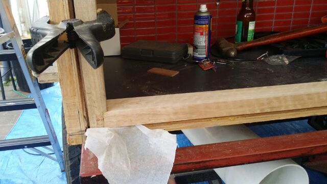

Started my hatch build today ,a little unconventional but you may have noticed its a common thing with me

Postby Atomic77 » Sun Aug 30, 2015 1:07 pm
Oh yeah... That's looking good!
